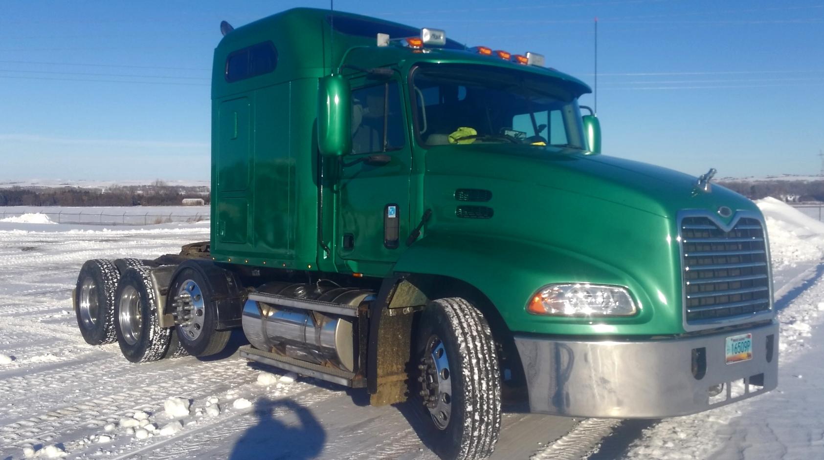

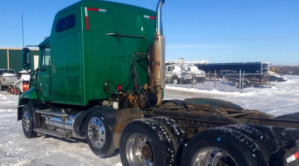

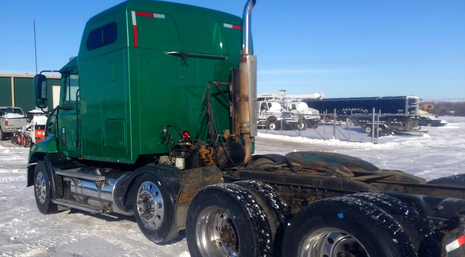

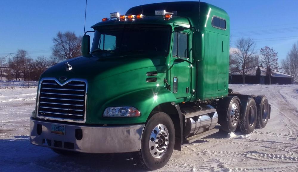

this is the gun iv been using for base clears
https://www.mgdistributor.com/product/euro-3200-h-series/
with a 1.4mm tip
on this job i certainly felt like i wanted more paint flow than what i could get with the 1.4 i wonder how it would have gone if i would have tried my other paint gun.
for primers iv been using this gun with a 1.7
https://www.pbejobbers.com/product-hvlp-spray-gun-17_59267.aspx
these are both paint guns iv owned for a very long time. they probably were not the top of the line even when i got them, they were purchased at different times based off the recommendation from the auto body supplyer i bought them from for the project i had at hand when i bought them...lol.
haha...lol i just checked your link and its one of the two guns i have already of course not the one i used to spray on this job...lol that was the first one that i bought but i seem to recall having a issue getting a new 1.4 tip for it is why i bought the euro
as far as psi i know they both say 10psi on the tips but i normally adjust my air preasure to my spray pattern with the fan all the way open and the fluid delivery all the way open dial in the air preasure for a football shaped spray patern seems i normally end up closer to 20-25psi at the inlet.

i noticed watching myself paint in the video my gun handling techniques could use a bit of improvement though, being that its not something i do every day though i guess it shouldn't be surprising. maybe spend a little more time doing dry runs with that in mind before i shoot my next paint job. i guess that is one advantage of recording the video as well how often do you actually get to watch yourself do something and notice things like that....lol
iv i had to venture to take a guess just based off the amount of time and materials i had into repainting my truck i bet that paint job would have run upwards of 10k. otherwise it would have been done half assed and they would have painted over vynal stickers and without proper surface prep and had issues down the road like was done when the hood was re-painted prior to my ownership of the truck.

Point is you thought it out, prepped it properly and most important you did it yourself and you are pleased with it which is the main point. Also you learned experience for the next project. In the spring I'm going to break ground to build 38 houses, done it in my head a zillion times.
I do break waters, seawalls and quays for 30 years and learn something new on every job.  You are pleased that's all that counts.
