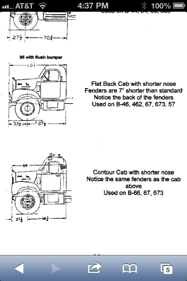

Slightly off topic but do the B67 have shorter hoods than the B7 series? Also was the L cab only available on the B7 series?
B67 has a 7" shorter front fenderd then the standard B61.  Idk the hood diffrence.   I'm guessing 7" also. image.thumb.jpg.6afbc82b5fff9027e66abf73258dcda6.jpg
