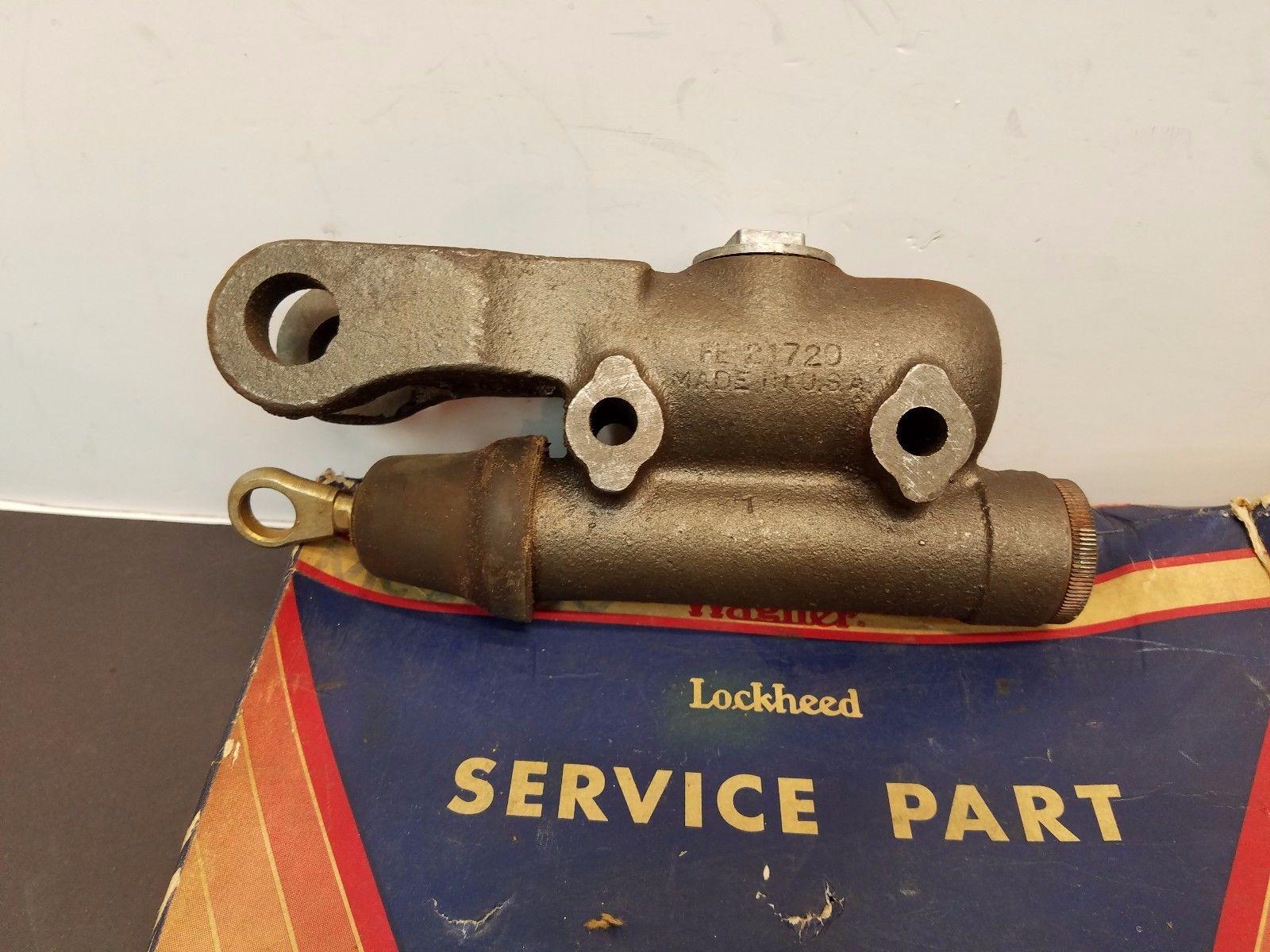

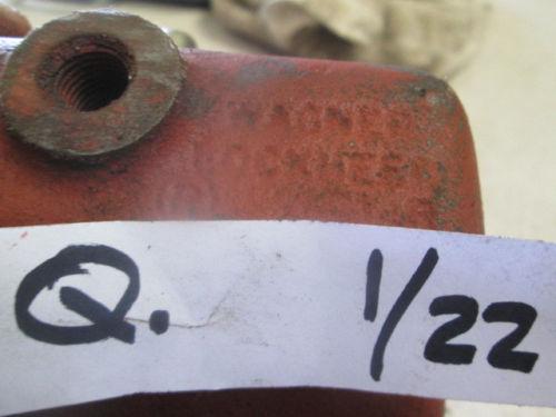

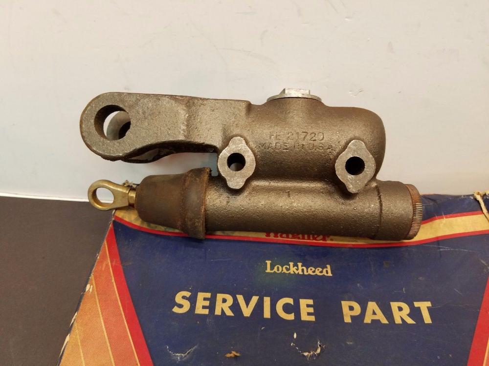

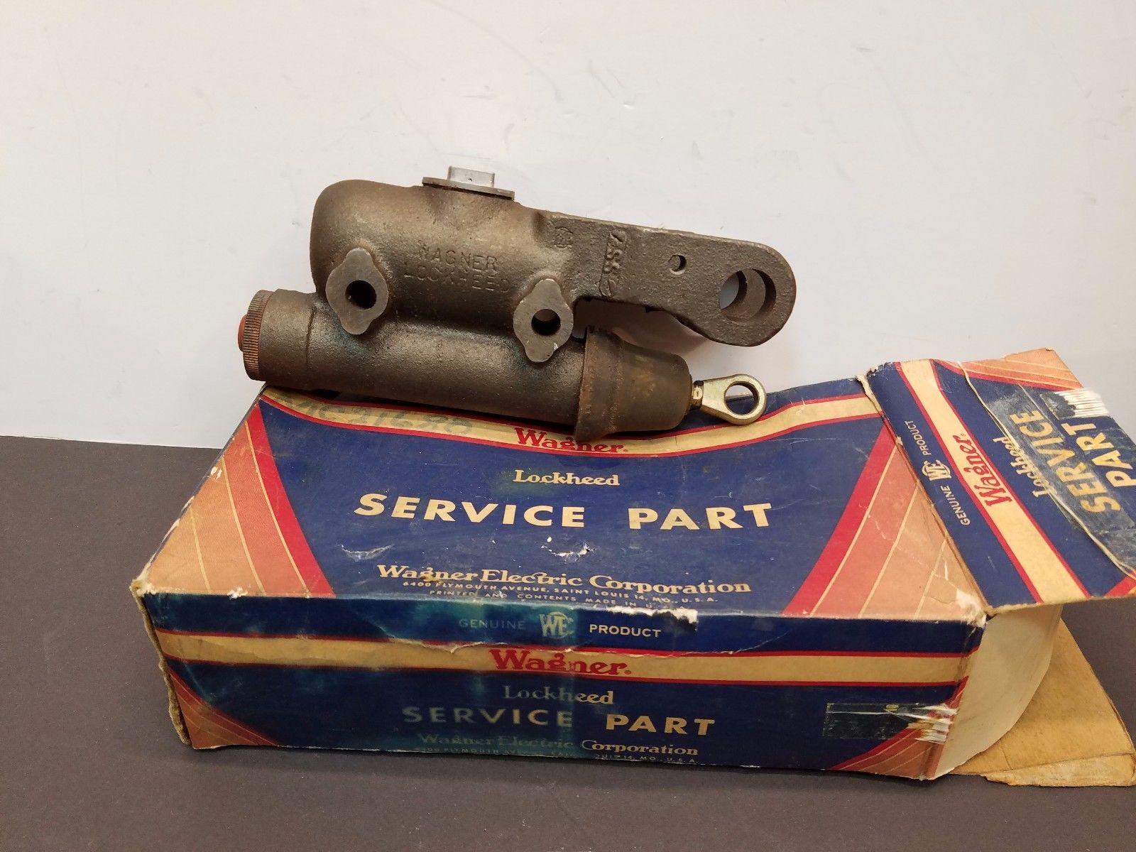

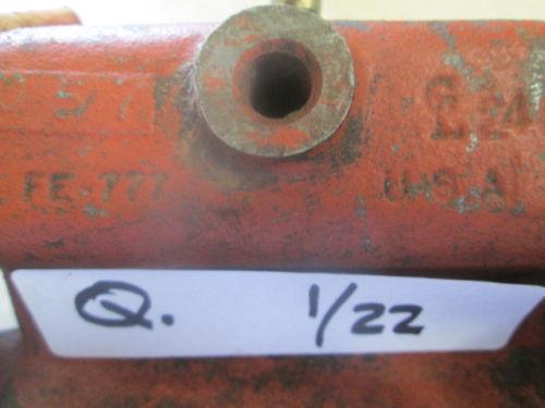

Do you have the casting number off the master?  Should start wit FE-*******
17 minutes ago, FDNY 343 said:
Yarnall ~ I'm going to try Napa tomorrow, 41chevy I tried uploading a picture of it a few times but the system keeps telling me failed. Anyway the molded number in the side say's  CG 27 I assumed that was the model number.
o?
Casting number and Lockheed  Wagner name as in first photos. The FE numbers are stamp cast in the body as in the second photos.  The FE-??? will cross to current model Raybestos unit according to my books.
