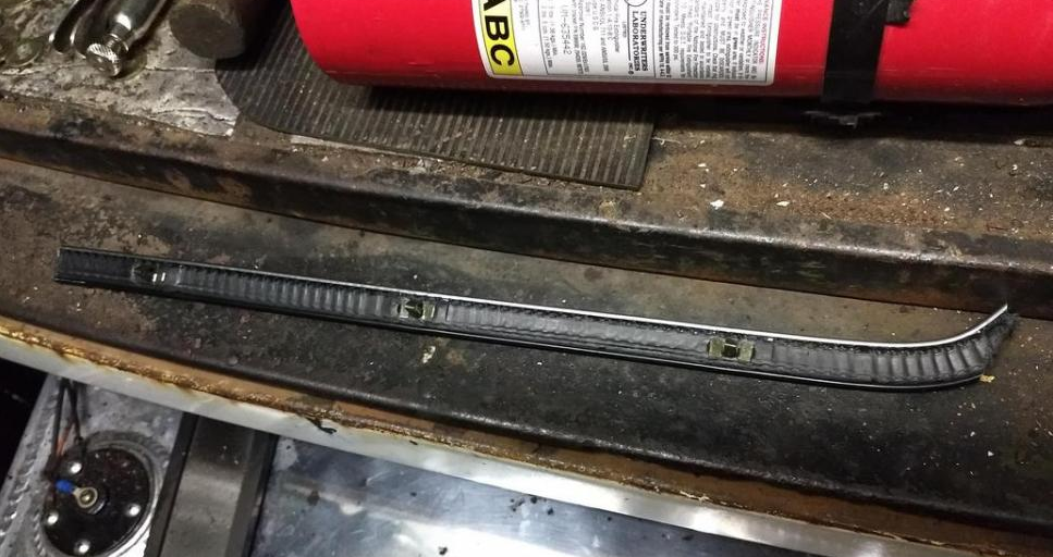

Keith, those wipes are for a '67-72 F100 pickup.  They were like 4" too long, but had the radius corner that matched.  I confirmed from my '69 F100 in the garage.  I had to cut just a bit off the length of the corner as it was a touch too long there also.  There was a fourth clip in that corner.  The three remaining clips hold them in the door just fine.  I just had to drill the holes for them.
They used the original Ford part number:  PART #:C7TZ-8121452-SS
https://www.rubbertherightway.com/1969-ford-truck-restoration-parts-80954-prd1.htm
All the parts had MADE IN USA on them.    Likely with "global parts"?  They were nice, no complaints on visual quality.
Edited by Freightrain
