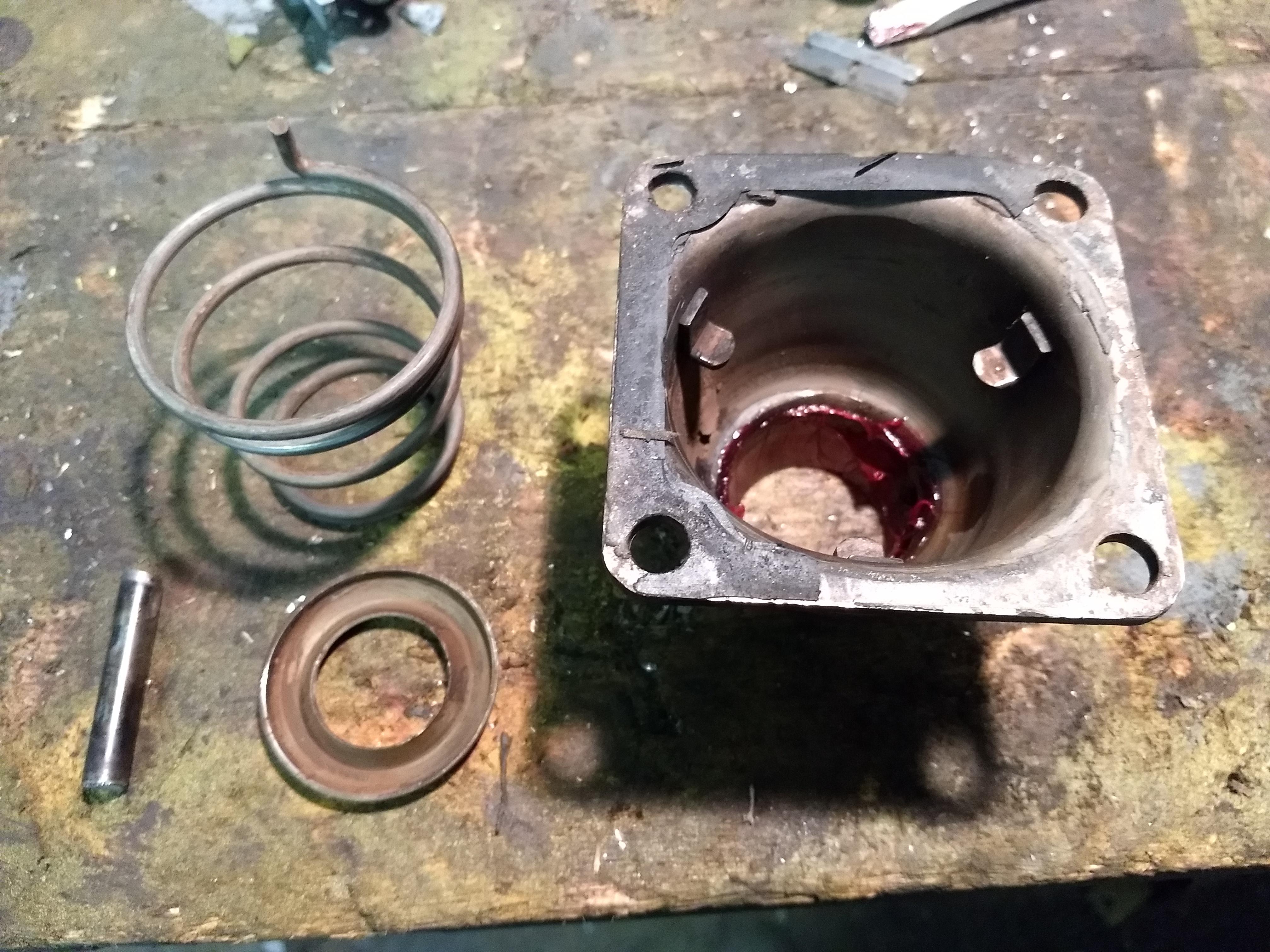

I pulled the shifter and the spring has popped out of its retainer

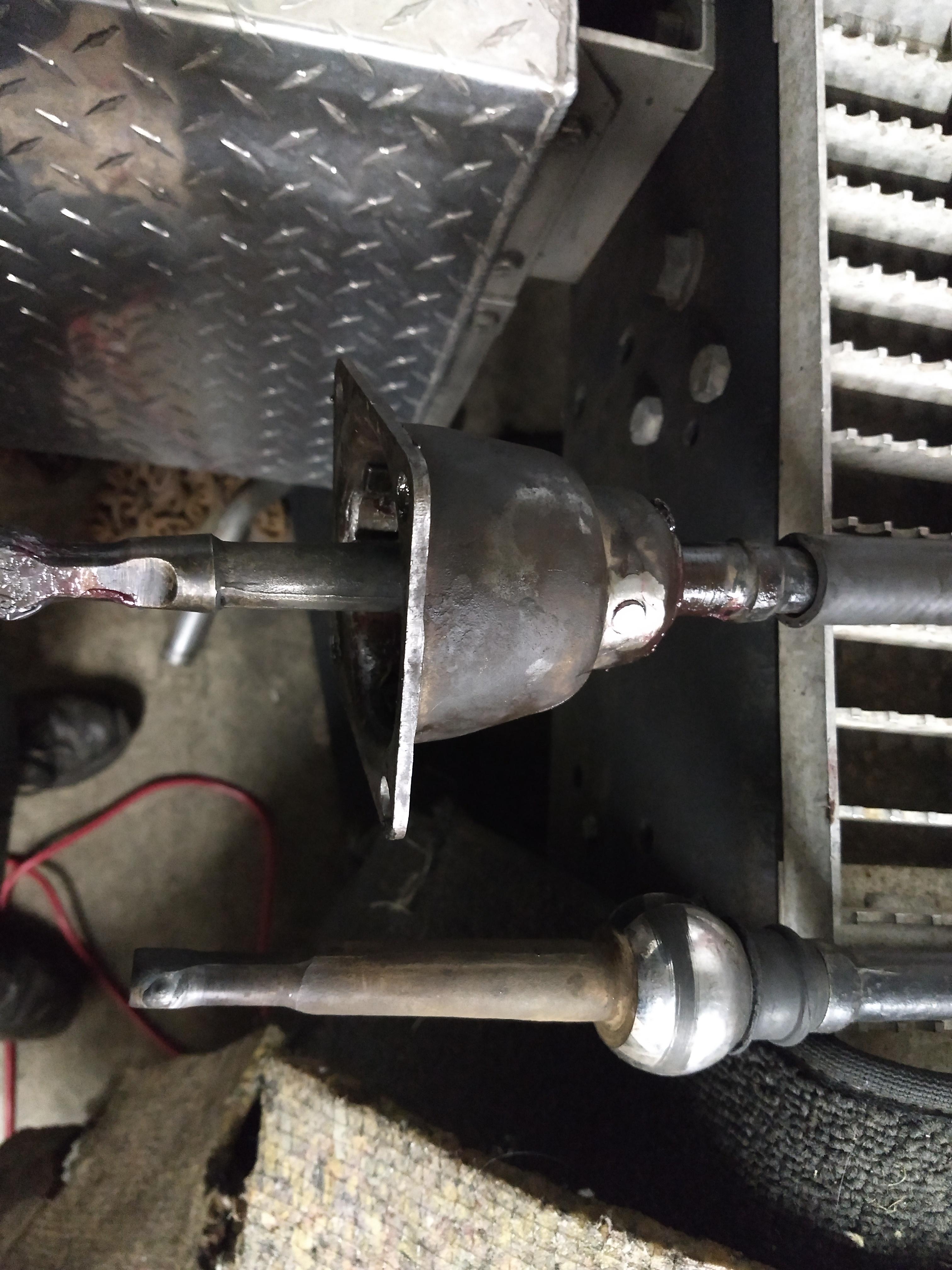

The sides of the bottom of the shifter have what appear to be grinding marks but not much if any material is warn away
The corners of the tip of the shifter are warn at 45 degree angles, should I weld them up?

Also there are two welds on the shifter arm
Suggestions
I think those tapers are suppose to be there?  It doesn't look worn but on the two edge(you can see the polished points).   I welded those tips to tighten them up when in gear.  It took some fine tuning to make it shift properly, but works fine.  Not as much slop in handle when in a gear.
The spring just kinda screws up into the cup.  You see the tabs, that is what the large diameter of the spring sits on.  Might take a few tries(like mine) but you should be able to roll it back up in there.

The shifter tip has a little wear but isn't horrible.  The tip shouldn't be square cut.  I might look for another to get rid of the welds on the shaft just to have something nice.  It may dress out OK with some grinder and flap wheel work?  Little bit too much bubble gum in the lower weld....
Try to  "flatten" out the spring retaining tabs to look more like the ones in Larry's tower.  It will sure hold the spring better if they are flat.  Are all three tabs there?

All three tabs are there
With the pin being welded in place it's not going to come apart without some grinding, I was thinking about leaving it welded in there.
Tomorrow I was going to clean up the welds, hopefully the welder v them before welding, and wire wheel the whole shifter and give it a coat of paint
I was thinking about making a tool out of a harbor Freight screwdriver to help with getting the spring back in

I ground the weld and removed/replaced the center pin.  They a quick tack to hold new pin in.  Not a big deal.
I think i used needle nose vise grips to screw the spring back in.  Just have to watch getting the last turn in and seated.  Took a few tries.  Did mine last winter.
