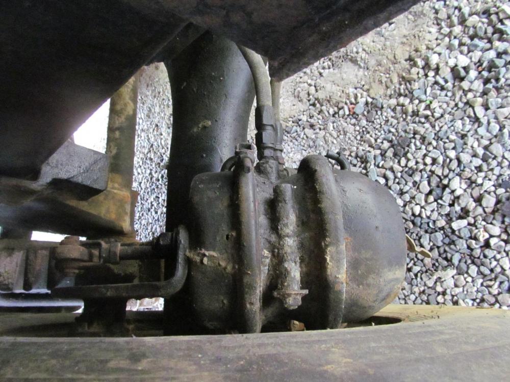

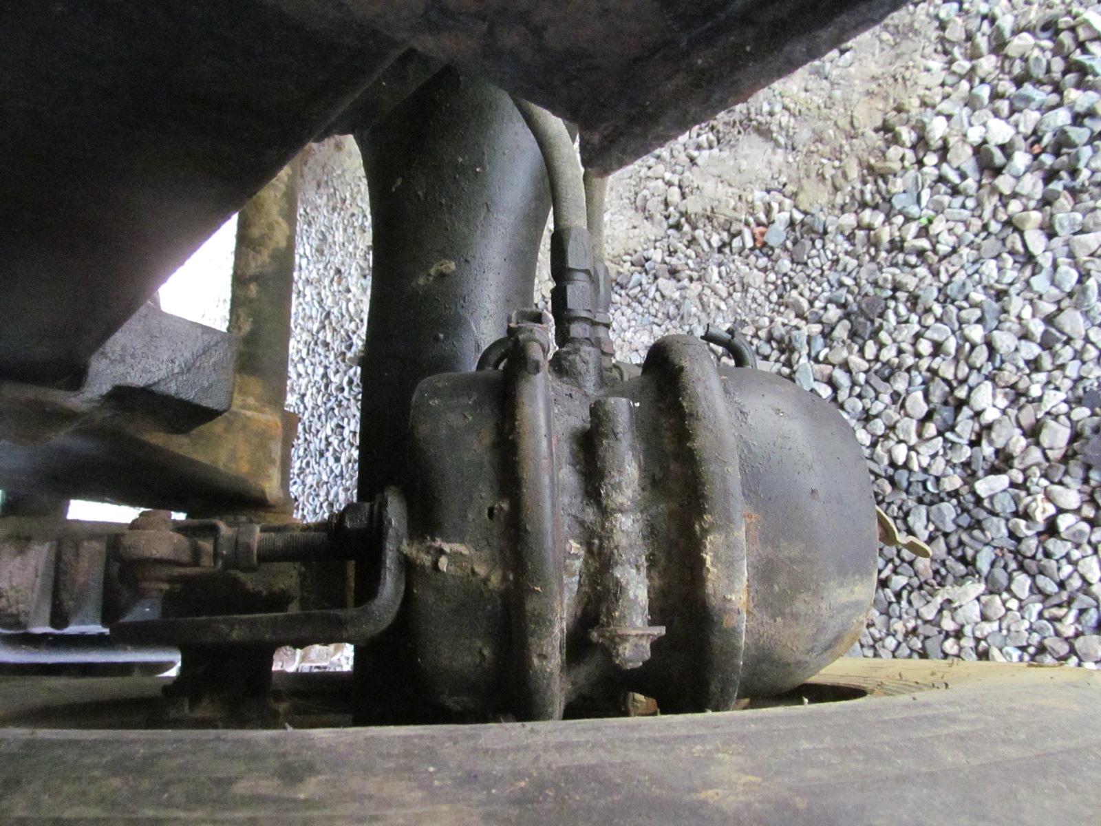

Type 30 Chambers on 1978 R
Check if someone put a long stroke or if standard stroke you don't really want to mix them together. long stroke has square boss around air fitting holes. Watch how you cut the rod off length is very important, always run the nut down the threads and then cut it to length.
good to know, didn't realize that.    terry:MackLogo:
Very helpful tips guys, thank you.   The boss around the air fitting is round. So I guess that would be standard stroke?   All the other cans have round bosses as well.
I will be going down to the truck shop today and will purchase a 30/30 can and see how it goes.
