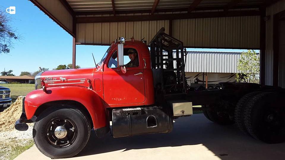

My name is Chris and I reside in the great state of Texas. In the DFW area to be a little more precise. I'm about to pull the trigger on a 1962 B-61 END673P. I'm not sure what the "P" designates as this is my maiden voyage into the vintage Mack truck world. So, I'll be seeking lots of help from the elders, lol. More about the truck. It has the Triplex transmission. Single rear axle. It's geared pretty low and I'd like to explore making it more highway friendly.

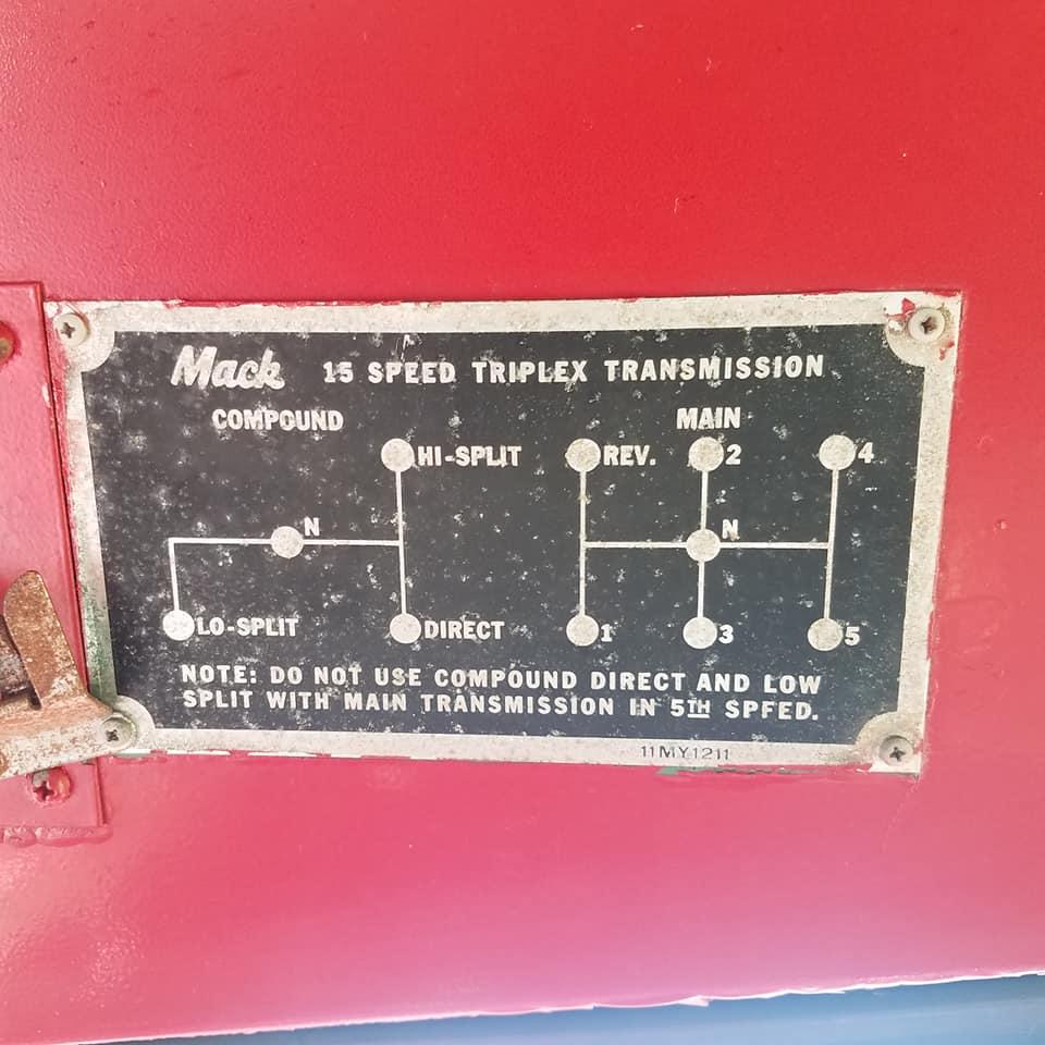

It has the 15 spd triplex. I think I went thru 6 gears before getting out of the driveway, lol.

Looks like an overdrive on the main box, go from 4th hi-split right to 5th high-split. No splitting 5th gear, the rear box is an overdrive too.    terry    If the diagram matchs your gearbox,  Trans model no. should be on the left side of main box.

Yup, looks like you have a DOUBLE OD triplex.  That is a 13 spd Triplex, so you don't split 5th gear.  That is kinda a "get home gear".  Basically don't really use it unless you are empty and wanna run.  It won't pull it very well if you are heavy and on anything but level ground.

Terry and  Freightrain, I drove a B model with a 711 and a 13 speed triplex,it was converted from a single axle road tractor to a dump with a rear tag.You split into 4th and went from 4th hi straight to 5th hi, no split therefore considered a 13 not a 15. Would do 80 or at least that's what the Speedo read!
