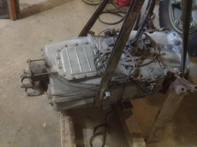

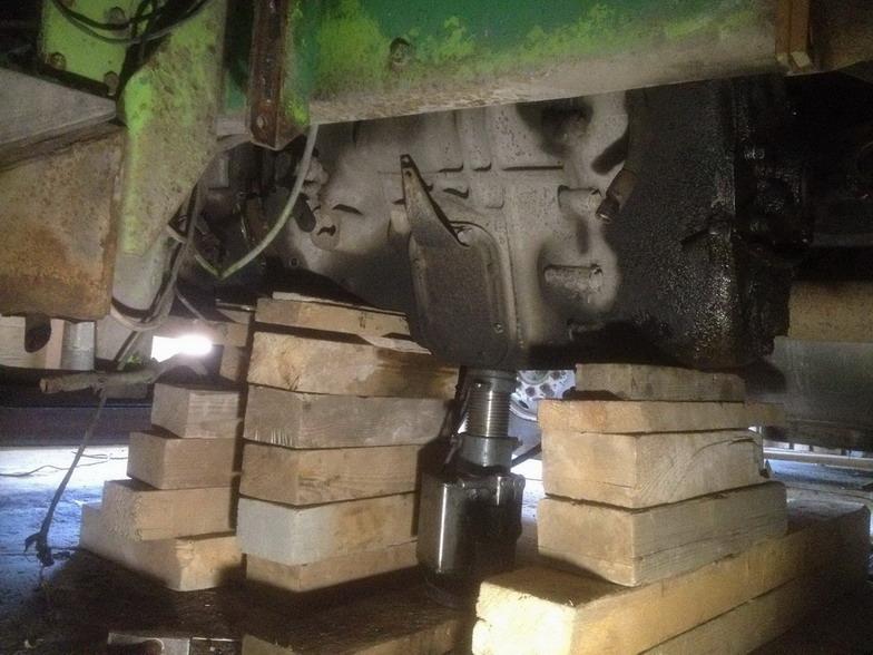

Hi all,
Finally got myself into an entertainment I was going (and avoiding) for a while. Found some troubles and hope finding useful tips. So the help is appreciated.
The truck is 1988 R688ST E6-350 4V Econodyne with T2090 9speed and 5.02 Mack rears. It's for a hobby and no trailer in distant plans.
The reason to go from one tranny to the other is 1st the original one is worn bad, 2nd I could locate a good 7 speed locally, 3rd 7 speed provides higher top hole of 0.60 instead of 0.71 with 9 speed. Also jumping wider steps I hope to drive easier in the city traffic I use to get in all over my place. Not sure all that will be perfect but I'm not prohibited from putting 9 speed back on in the future since total chassis rebuild is on the list. Will need a rebuild and faster rears in that case.
To the moment I took off the original gearbox from the engine and got it on the ground. Had to remove left side fuel tank, big air tank, cab floor and a shift lever. Jacked up the engine a little to get the rear mounting brackets elevated from the pads to be able to remove the tranny. Placed wooden blocks below the engine flywheel housing and than started working with the tranny using the jack and blocks.A trouble was found to get it rearwards enough to clear up the spigot off the clutch bearing since the rear end of the transmission took against the rear cab support bracket. So finally I had to lower the rear end and move it slightly leaning against the crank shaft line what I disliked to do. The unit to go in is even longer having larger compound housing desingned for multi-speed PTO (which I have no need in) so seems the things will be more cantenckerous for re-installation. Current idea is to remove the mounting brackets from the transmission housing and try to put it back slightly biased to the fllor at the rear. But maybe some other options exist?  Also there's a question which might be found as a dumb one. I took the unit off keeping the clutch assembly on the flywheel, the way I always do on cars. But it looked like I also could remove the pressure plate mounting screws through the lower opening and get the tranny together with the clutch. Which way is correct? And what is more important, which one to put it back?

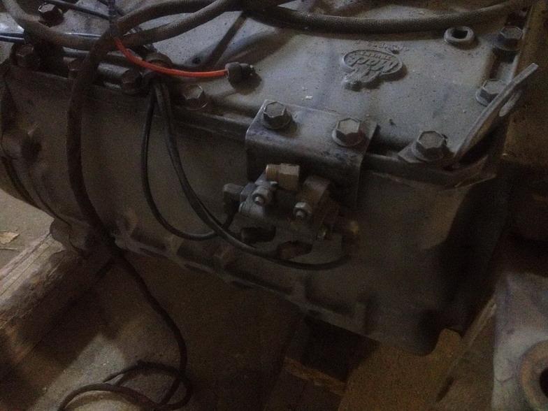

The next issue is I don't have an air schematic for T2070. The pipe connections I have on the unit are different than T2090 has. And they are not complete. Additional trouble is the shift knob on the 7 speed is ruined and I'd like to keep the 9 speed up and down flipper. But it has 2 lines only and the 7 speed one has them 3 or 4. Have no idea of how to make it working the 1st insted of the 2nd and if it's possible at all. As a retreat option I have a shifting knob off T2080B with a revolver style flipper, the same kind as used on TRTXL1070 12 speed. Might work the deal out using that part if knowing how to appange the lines.
Some pics attached below. Thanks in advance for advices and any thoughts on the matter.

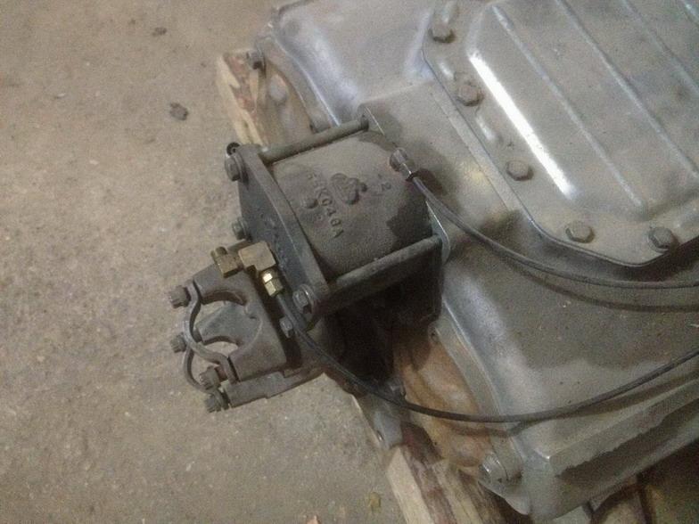

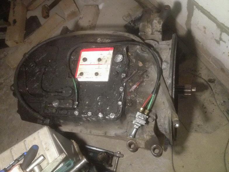

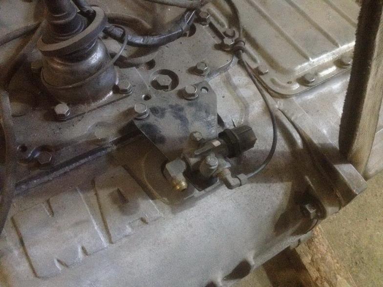

The air lines on T2070 look this way. As you can see some of the connections have no attachments and I don't have knowledge of what to attach to.

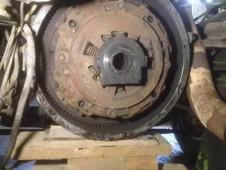

56 minutes ago, 1965 said:
Only thing I can comment on is; it’s the easiest way to put clutch in by putting it all on transmission front shaft & putting it in & taking it out; let the jack handle the weight!
Thanks, just didn't know it's possible that way. Seems also preventing from getting bent anything in clutch while tranny hangs on its input shaft.
  • Thanks 1
Done a few that way; makes it very easy all you have to do is get it in pilot bearing. So much easier. Which I know you know to start each pressure plate bolt & rotate engine a couple of times to make sure it all is aligned right & all before tightening.
Edited by 1965
5 minutes ago, carlotpilot said:
what do you do about bolting the clutch to the flywheel with the trans .in your face?
You stick them in through throw out bearing cover & rotate engine.
What also surprized me is the pulling type of the pressure plate. All cars I dealt with and even my Mack of 1945 had plates a bearing presses on toward the flywheel. You probably can't do your trick with that style so I just kept it out of mind.
I knock the wood blocks out they have on the throw out bearing, put it on shaft & hook the the fork. Slide in and install bolts rotating engine couple of times. If you ever do 1 you want do it any other way. Some applications want let you do it that way.
Ok, looks like it needs twice less travel of a tranny backwards. I had to move it for nearly  15 cm /6 inch to get the pinion out. On the other hand the side mounting brackets were ready to pass the chassis supports about the same time. I will be Ok if put the unit back with no brackets but seems like the same long amount of travel is required for the remove.
There's a point that R-model brackets (twin rubber pads) are wider (longer along a frame rail) than ones on MH or Superliner. So that issue wouldn't show up working on those models.
Thanks the great for guiding me up.
Vlad

Roamed around two transmissions today thinking of a mistery of air switch connections and the need of shortening the prop shaft. And after reading  T2090/T2090 repair manual (fortunately I've got it but to my stupidity haven't bought one of T2060/T2070/T2080) a feeling appeared that it's possible to re-install the compaund housing off the 9-speed to the main body of T2070. Making some math it turns out that you get a set of ratios T2080 8-speed unit has keeping sinchronized hi-lo shift with the 9-speed rear end.
Not 100% sure since some Mack-designed "surprizes" might be found such as modified splines on the front main shaft where the main compound gear attaches or different shift forks on the main top cover I'm going to re-install too keeping air shift unit but seems it worth making a try. Going to wash away some grease off the body (transmission's, not mine) and turn wrenches a bit tomorrow. Will share the results.

Being not able to fit the short compound box onto the main one I shortened the prop shaft. Got it from a shop today. Haven't figured out that complicated T2070 air shematic. From tranny description follows that you should put the compaund box in neutral when operate compaund-mounted multy-speed PTO. You take the power from the back box so the main one is in gear. And if you like your truck being stationary during the operation the compaund should be shifted in N. But the shift cylinder has two lines only. This means there should be some special switch (and air lines arrangement) the compound box to neutralize.
Having no info on such pipe arrangement I just replaces the main box top cover from T2090 onto T2070 together with that "clever" air distributing device. That allowed me to keep two-line flipper on the shift lever and it also looked like I'll be able to pre-select with my final setup. The device tracks down the shift rails position not allowing air to go to the compound cylinder until the main box is in N. Original T2070 (and T2060 and T2080) top cover is similar of its shape with T2090 but doesn't have that neutral-checking unit. The top came with no issues, I checked the shift forks - they're same of the sizes and the part numbers either.
