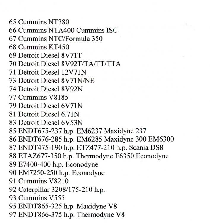

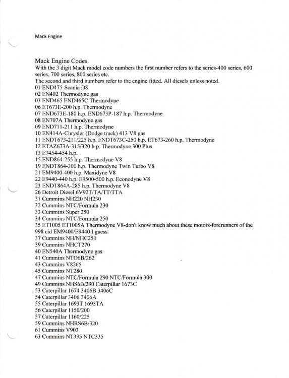

I'm talking about the 4th and 5th digit in these codes.  For instance, what's the difference between a 32 and 33?  Or a 52 and a 53?  And what's a 43?  These are all different model engines, correct?
The 50 series referred to Caterpillar engines. I believe the 40 series was Detroit with 30 series being Cummins. I'm not really certain on any of them except Caterpillar.

I am sorry my post answering this question with a full explanation was not understood.
So. let's see if this will work
612- lighter chassis, Mack brand engine (six or eight cylinder), single axle suspension.
613- lighter chassis, Mack brand engine, tandem suspension
632 light chassis, Cummins brand engine, single suspension
633 light chassis, Cummins, tandem
643 light chassis, Detroit engine, tandem
etc.
1 is Mack, 3 is Cummins, 4 Detroit 5 CAT        FOURTH DIGIT
2 single axle, 3 tandem                                        FIFTH DIGIT
This system started with the MH Ultraliner (1980) than Super than Mack CH and CL  etc.
Hayward RWs used the old engine code system.  The new system identifies the ENGINE BRAND not a specific model of engine.
Jim

Aaaah... the light is coming on now!  Thanks, j. hancock!
