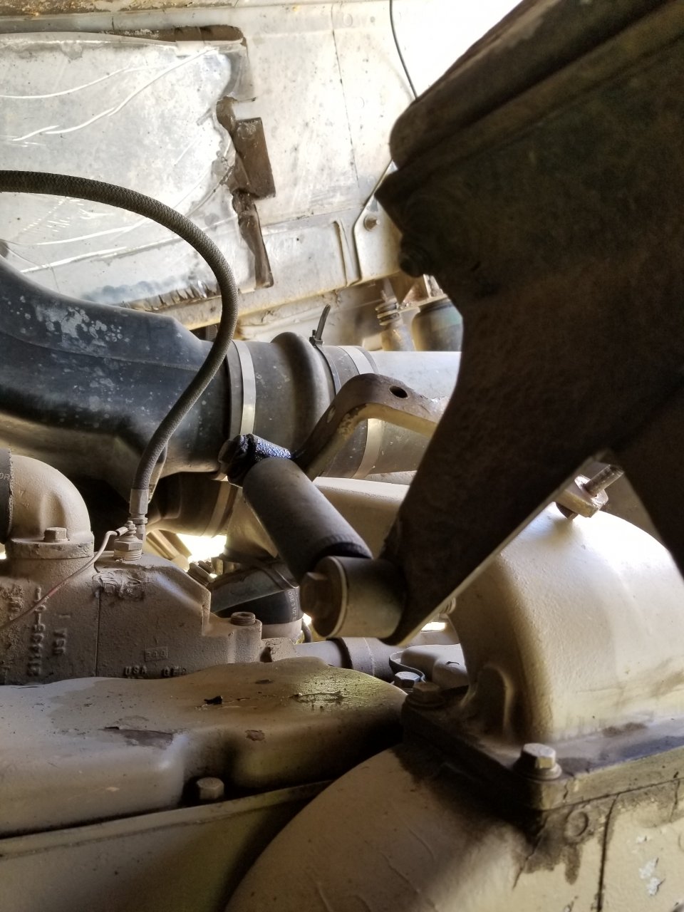

Here is the only pic I could find of my shift linkage.  I don't see that bracket on my MH.  I will not have access to my MH for another couple weeks.
What transmission do you have?  Mine is a T2050 5 speed.
Ken
that's the lower damper support.... on the V8 it is attached to a bracket on top of the compressor, yours looks like a Cummins?... I'd flip it over 180 and go looking for a couple of spare holes around the valve covers.. the damper goes sideways to the long linkage so it looks in position right now

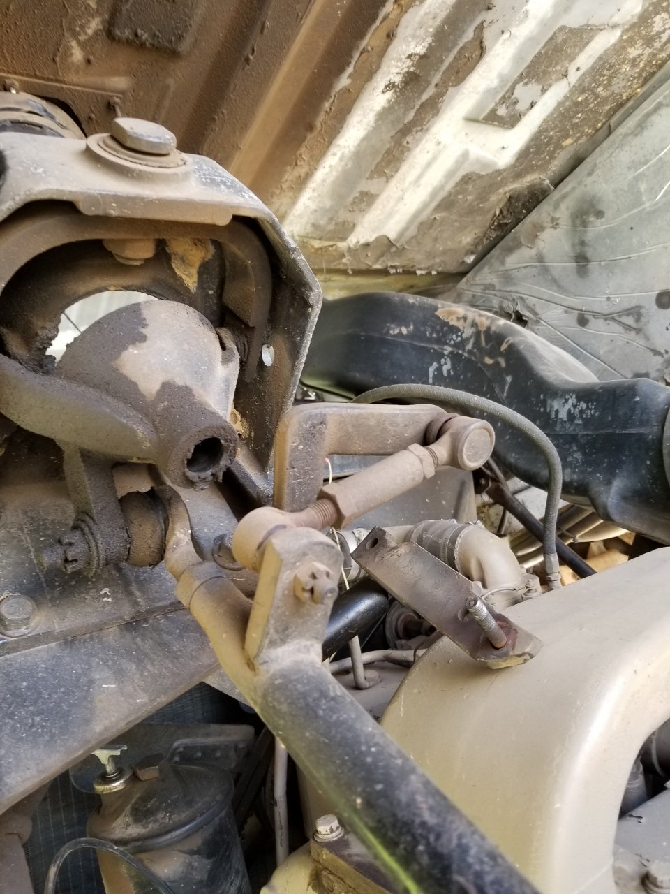

on Farmer52's photo the damper is not installed, you can see the empty elongated slot below the mount
