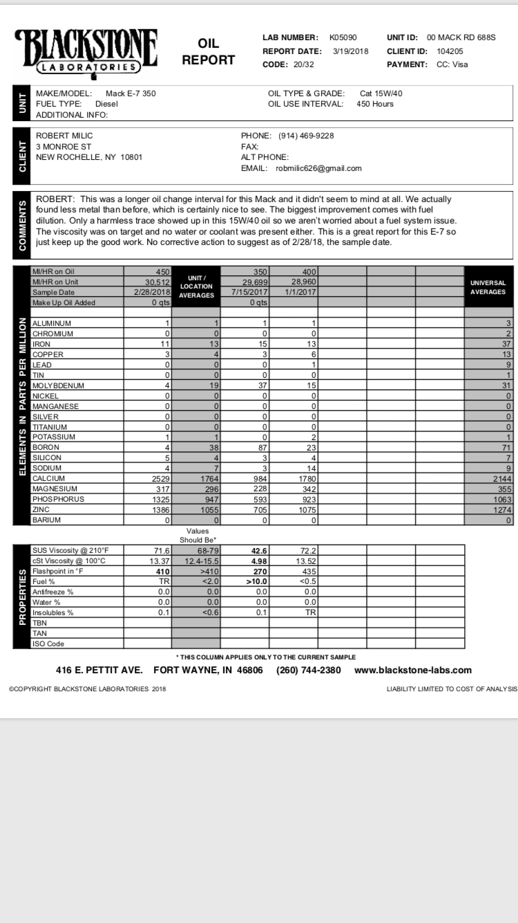

I think your wasting your time pulling the pan your oil metals would have showed if something serious was happening down there!

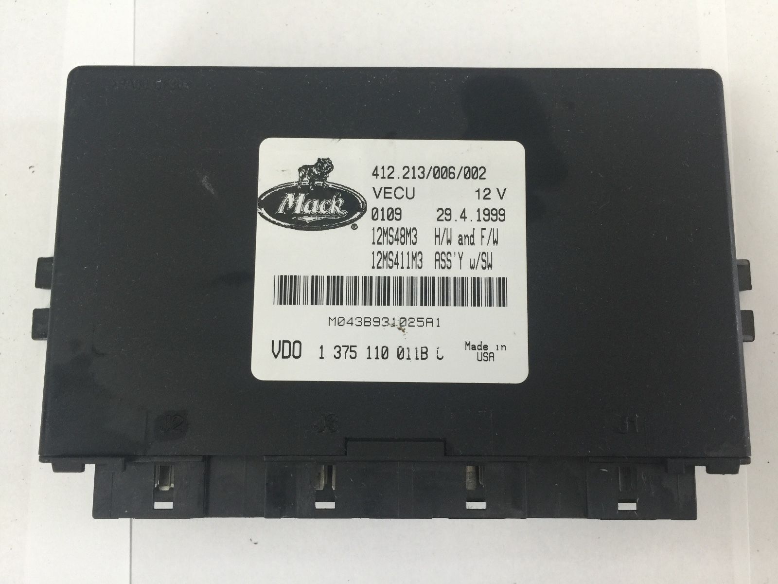

There use to be a lot of that going on at our shop, but the rule was stealing from a used truck on the line was fine.......never touch customer. Nice to have a spare ecm around when trying to dispel an  issue.
Is there a date code on an ECM?
