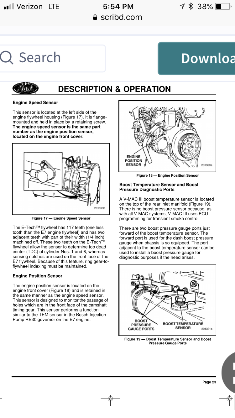

Were do these injectors get the signal from on the motor of when to fire ?
There must be a sensor that picks up the position of the crank, were and what is it ?

The EUP’s are cam driven by rollers and there is a cam position sensor on the front of the motor and crank position sensor on the fly wheel housing. I changed both sensors. No change. I changed all 6 eup’s. The cam and the rollers.
There is definately a misfire going on and it sounds like the cylinders are not firing balanced

Think about it this way , if the timing is out two tenths of sweet stuff all then the sensor will be out of time with the crank and the injectors will be out of time with crank and the cam sensor
As I have said already, I would dial in the cam like I would have as young bloke chucking a hot cam in a car motor, not just make sure its timing marks are lined up but make sure the lobes are rising and falling in the correct position to the crank and to the sensor
I would also make sure the crank sensor reads at the correct time and matches the timing of the cam sensor
