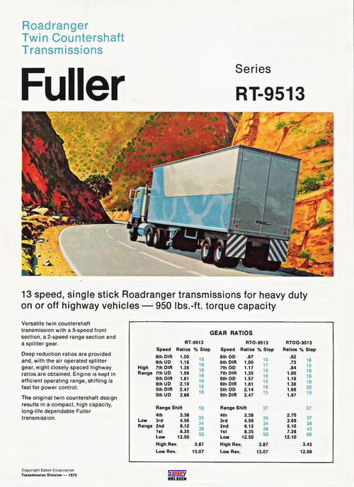

Whats a better trans to swap in my 90 ch613 has a 300e6 and a 5speed i pull logs so im loaded above 80,000lb every load and having so few gears really kills the truck like it takes me miles to get up to speed. iv found a mack 9 speed from a r model  and a eaton fuller 9 speed from a newer ch that had a e7 motor which would you guys recommended and why and what all do i need for the swap other then trans a air supply for shifter and a drive shaft

If your dead set on changing transmissions then I'd look around the bone yards and older rebuilders for an RTOO12513. The brochure page I attached shows the ratios for the RT9513, the RTO9513, and the RTOO9513. the 125 series has the same ratios, they just have a higher torque rating. The OD ratio is only .02 lower than what you have, top speed would barely change.

We did this swap with our 94 300.  We put in a fuller 9L, with the original 5.73 gears it would top out at 62mph at 2100rpm.  We ran it that way for a few years, but we run tandem dumps and max gross in georgia is 64k, so we eventually put 4.64 rears in it.  Turned the pump up a little and she runs like a 350. You need new tranny mounts, and driveshaft.
