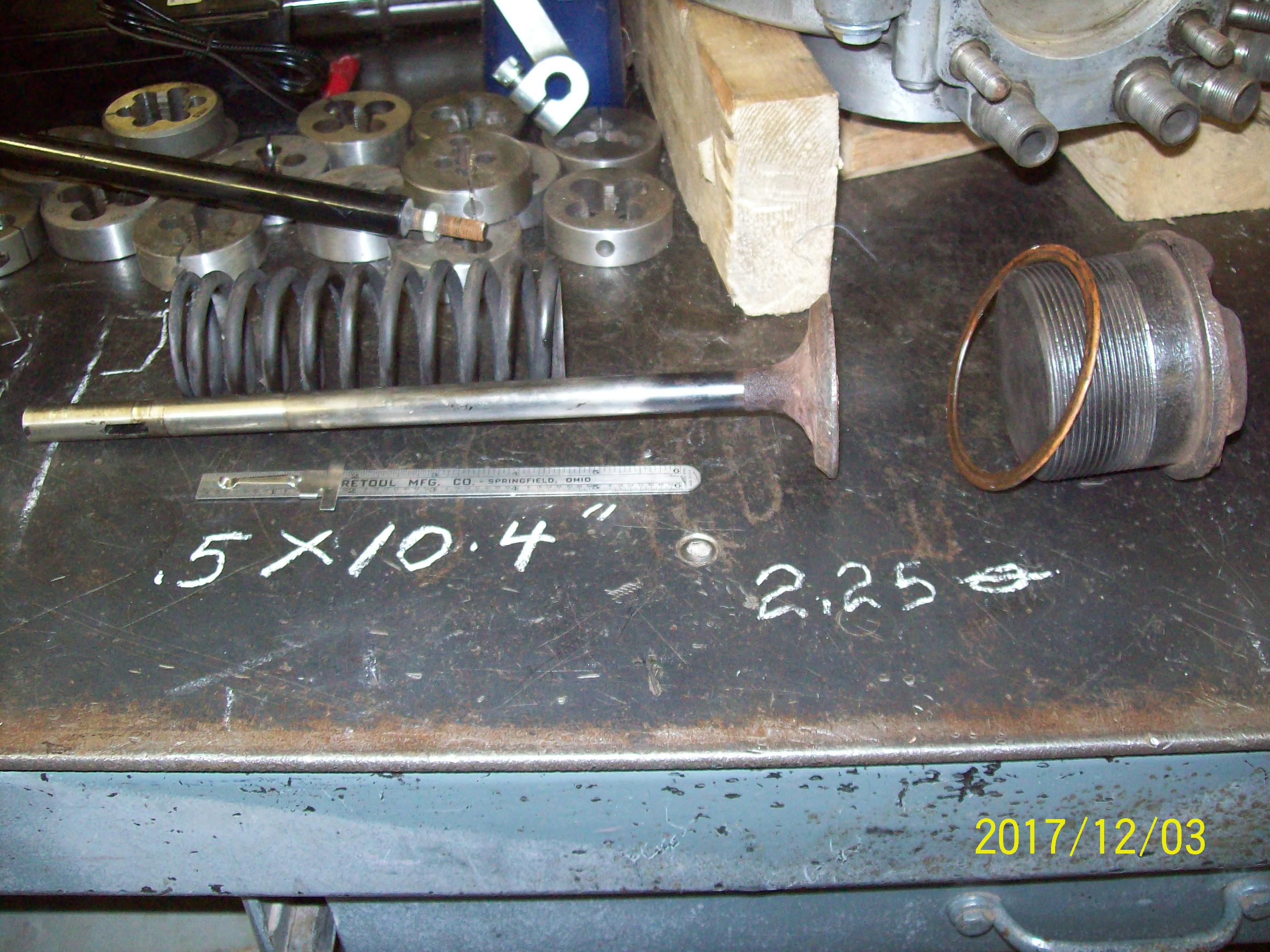

I have been assessing the engine now that it turns over & have determined that #4 exhaust valve is burned, the other 3 cylinders have compression.   It looks like the clearance was set too close, probably causing the valve trouble.  The seat has been replaced & looks retrievable.

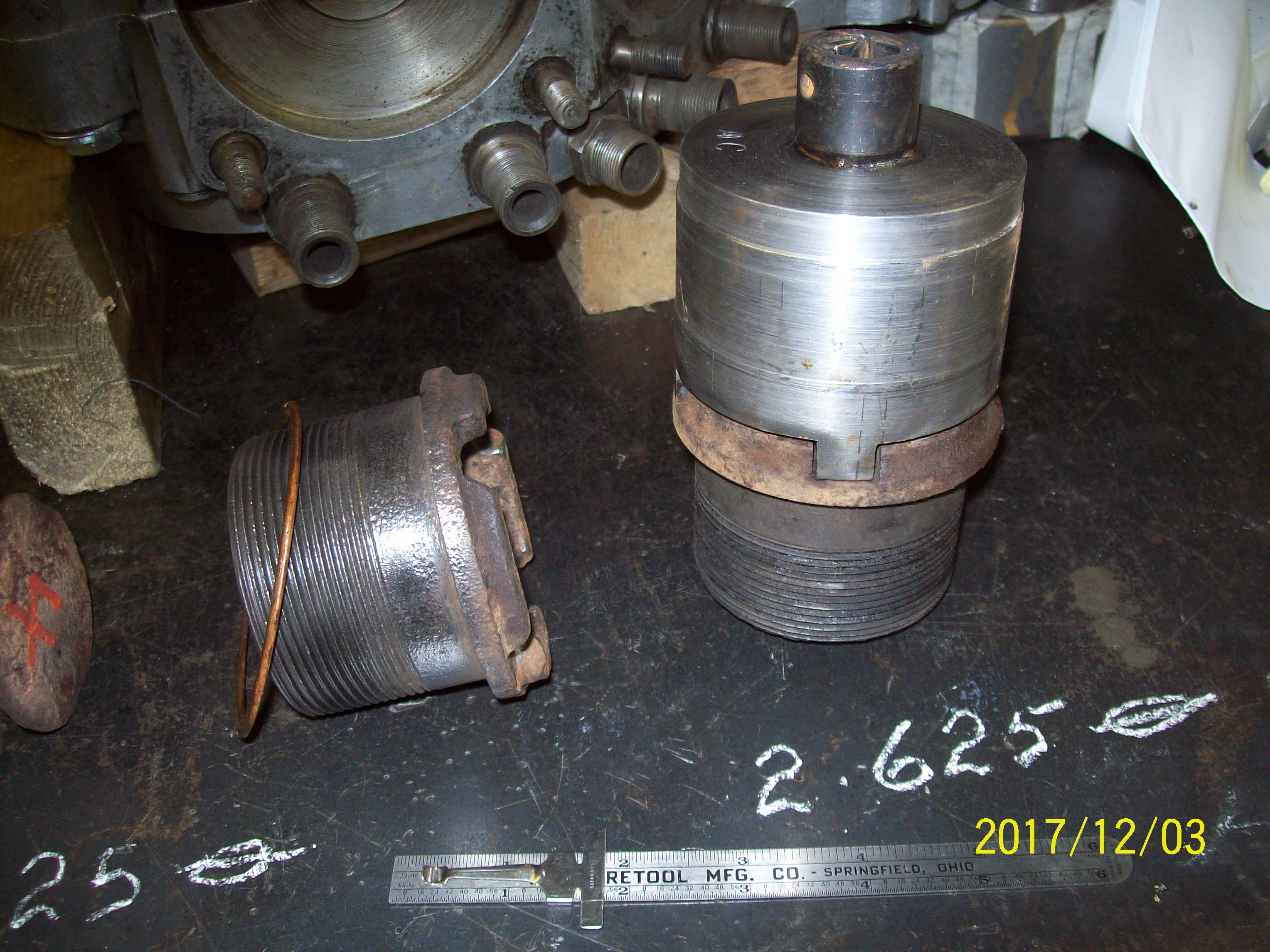

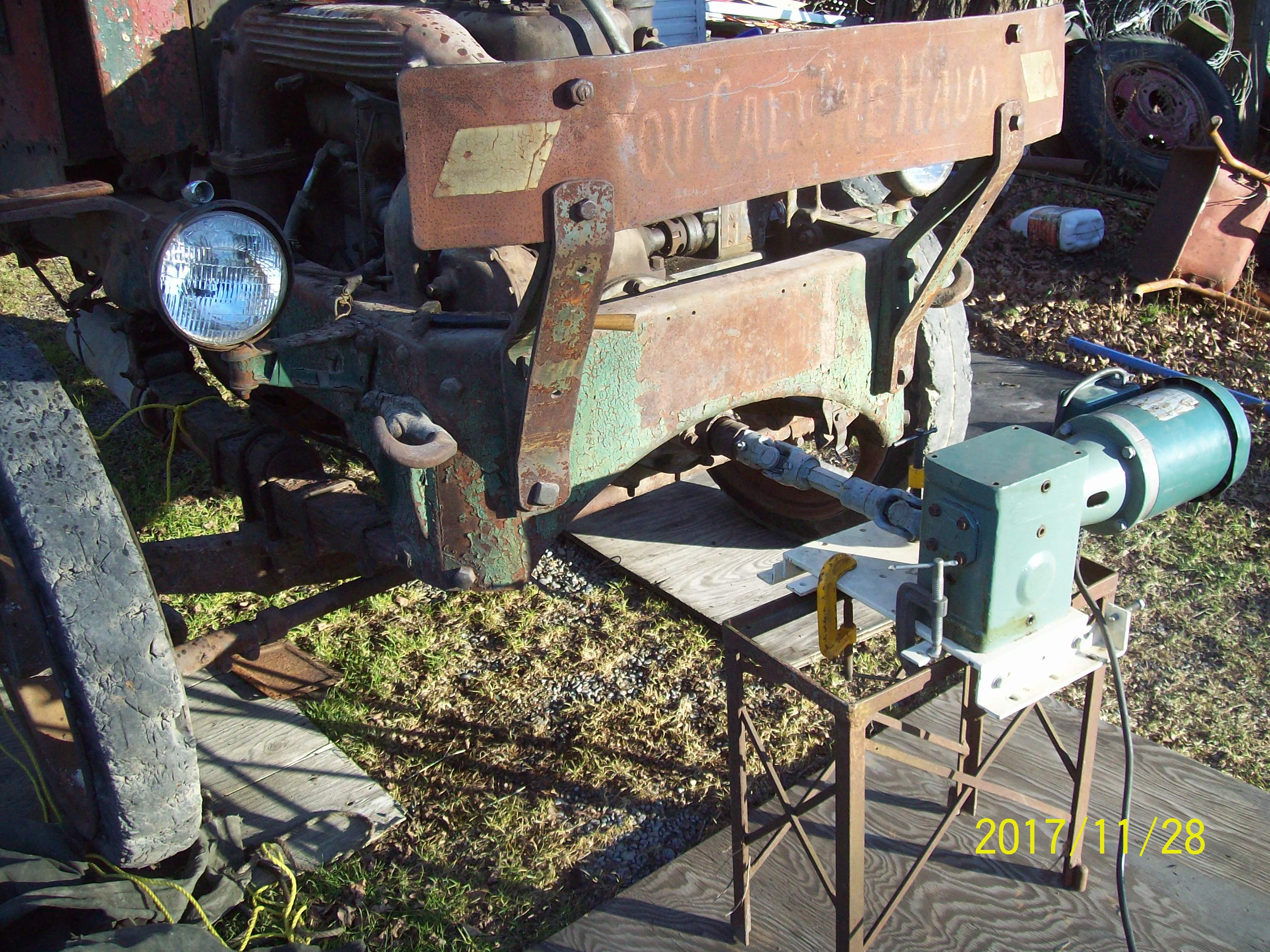

The pictures show the tool I made to remove the valve plugs & the gear reducer I often use to run in rebuilt or long sitting engines.   Sometimes problems show up at 30 rpm that would be destructive if the engine was started.
Does anyone have a current no. or replacement valves for the AC?   The exhaust valve has a .490" dia. stem, 2.25" dia. head & is 10.4" overall length.
I have not removed an intake valve - are they the same size?
I just finished pulling an intake valve out & found that it is essentially the same size as the exhaust valve.  It is in useable condition so I will likely just need the exhaust valves.
I found Toledo part numbers on both valves;  in.  T307,  ex. S290  (the 9 could be a 0).  So far I have not found any listings for Toledo valves.
