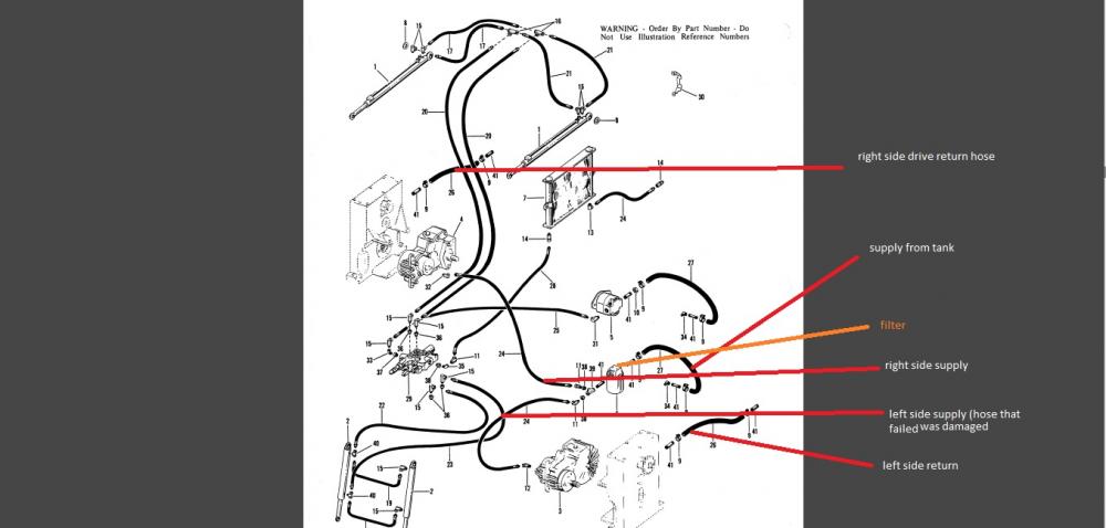

the hose that leaked was post filter. so the filter shouldn't have gone dry. and the right side drive is working properly the left is still giving me fits. i am amusing everything at the filter and below is fine do to the right side drive still operating properly. i have thought of changing the filter because maybe if its partially plugged up might be making it harder for a possibly weak pump to work. most systems iv worked with always had the filter on the return side rather than the suction side as pumps like to push better than pull. so i am thinking a restriction at the filter might be adding to my problem. however at the same time i hate to possibly introduce more air into the system.

plan for today i think will include changing the filter then i will unhook the hose from the hydrostatic drive pressurize the tank to push the fluid out of the tank threw the filter and out the end of the supply hose to make sure i have no air trapped prior to the drive. try priming it again and see what happens.
Changed the filter filter was full of glitter pushed flud to the pump till I got no air then managed to get the return line off and plugged the side to the tank and pushed some fluid threw the pump started it worked but slower than the other side for a little while then stopped again. Exactly like before. The only leak that can be found in on the rod for the control. Mabye it is sucking air from there. I'm thinking it took some internal damage
Looking at the diagram above I think maybe you have the supply and return lines confused
The reason I say this is that I would have thought the supply lines come from separate supplies as in each valve for each side and on the ones you have marked they share a common supply
So maybe your missing something on the supply side here as in the spool valves might be leaking the air in
And plus a filter is normally on the return line otherwise the filter would have to handle a couple of thousand pounds of hydraulic pressure
Anyway maybe some thoughts there and maybe I have no idea as I dont muck about with these so maybe best not to listen LOL
Paul
nope not reversed. return lines a large line that just gravity feeds down to the tank each hydro static drive has its own fluid pump inside the unit filter is under vacuum not pressure. fluid is sucked from the tank into the threw the filter to the drive unit where its pressurized in the unit and then converted into rotational force. there is a drive belt that runs down from the engine to the drive units. and spins a internal pump

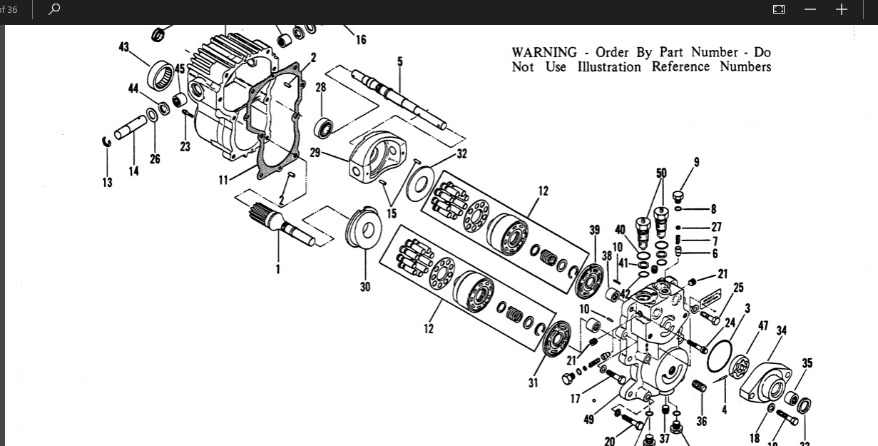

swash plate piston pumps
EZ, a typical hydrostatic system is closed loop, that said the oil in one side will basically stay there except what is expelled thru the case drain lines. They may have inline filters in them to protect the rest of the system in case of pump or motor failure, With that said, you may have a plugged case drain that has caused an air locked motor thus resulting in a intermittent operation. if the machine only acts up in one direction it could be a stuck circuit relief valve. .........after looking at this and looking at your previous picture, what I just told you wont mean squat !
 Does the linkage "Feel the same" L vs. R    when actuated ? if not perhaps a roll pin failed on the swash plate control, had a new Holland do this once. does the book show you a test port for charge pump pressure? if so you could test that to see if it stays constant. if it does then im afraid the "glitter" is most likely the hydrostatic pump has failed.
