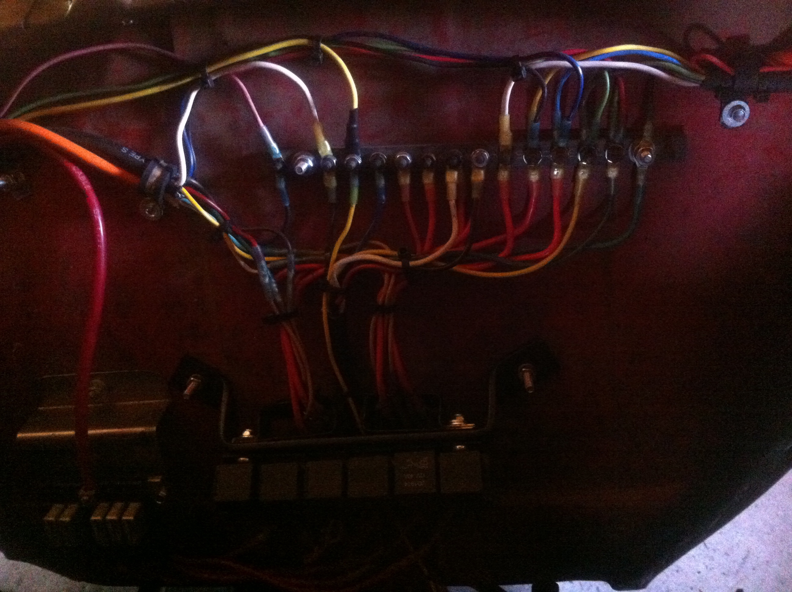

Anybody have a wiring diagram for this truck?  If I turn all the lights on in just the truck the breaker trips in a few minutes.  If the trailer is hooked up it will happen sooner.  Then in a few minutes it will come back on.  I don't think I have a short maybe just a bad/weak breaker.

Did you obtain the factory file from the Museum? There *may* be a wiring diagram in there.
Measure the amperage load across the breaker. Over the years stuff gets added to circuits that makes the circuit load exceed the capacity of the wiring and breaker. Don't up size the breaker unless you also increase the wire size or add an internal fire suppression system.:rolleyes: Corrosion can also increase the amperage draw so make sure all of the connections and light receptacles are clean.
A quicker, cleaner solution would be to convert the lights to LED's.
Best thing I did with my truck was put the headlights/brights on relays(one for low, one for high beams).  Pulled my main power right from the alternator lug(which is right there) and then used the headlight switch/bright switch as "control" wires.  No more blinking brights(too much current for the original headlight switch).
