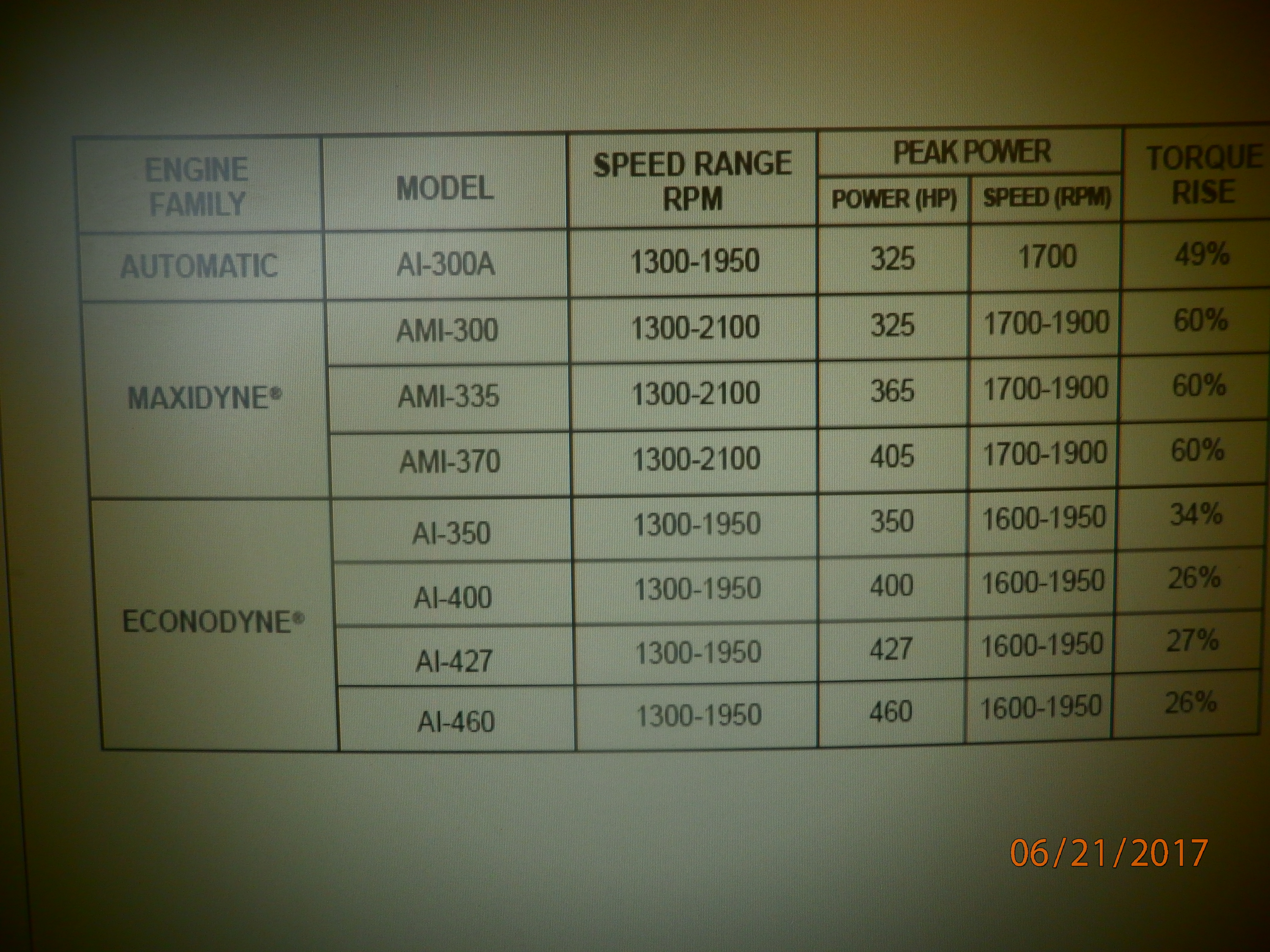

The difference is when the fuel is delivered to the cylinder and how much. If you deliver fuel slightly later in the power stroke you lose HP (ability to accelerate more quickly) but gain torque (ability to maintain speed).
Pay attention to the torque rise column on the chart I entered....
AI- delivers lots of power in a tight RPM range. Delivers good torque in a tight RPM range. When you hit a hill speed begins to drop and torque rises 27% to try to maintain your pull. So you lose speed faster and have to shift, but overall you have more tow power.
AMI- delivers less HP than AI(varies). Delivers less torque than AI (varies).....BUT, as you begin to lose speed up a hill the torque rises 60% as your RPMs drop. So AMI works harder to maintain your hill climb as speed and RPM begin to drop.
Your buddy with the AI made it over the hill faster, with a larger payload, but burned more fuel and had to shift 5 times.
