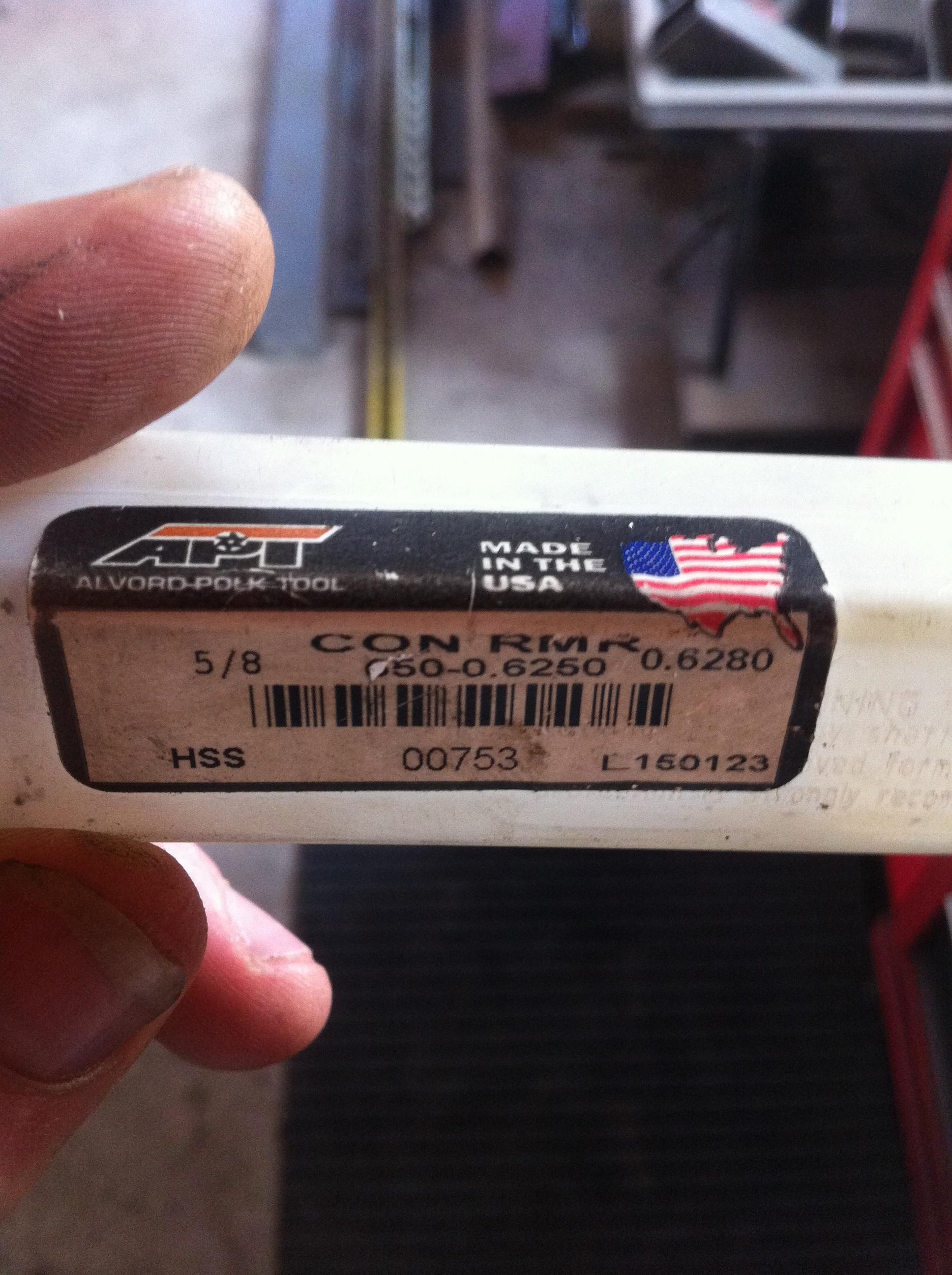

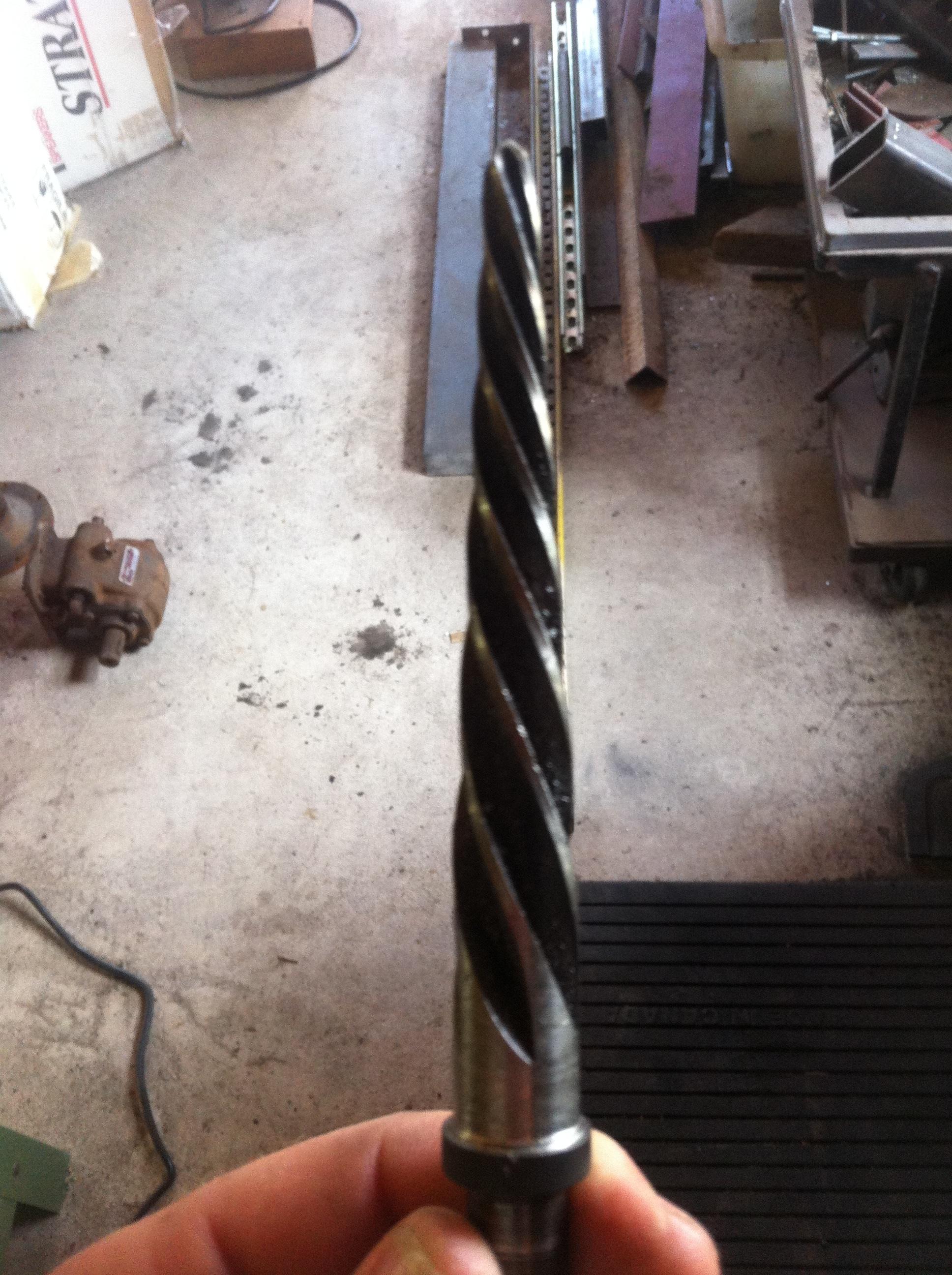

Can you give some details and snap a couple pictures of the drill and reams set ups used for the frame and how you chuck them?
I just drill a 5/16" pilot hole with a regular 3/8" electric hand held drill.      Then I use the reamer in a 1/2" hand held electric drill just like a drill bit but works  easier and last longer.  Just squirt a little lube of your choice and that's it.   I have a 1/2 & 5/8 reams good quality worth their price.   I have a 3/4" from ebay and its junk.  image.thumb.jpg.9d06d97181c00842e0e220890bc48745.jpgimage.thumb.jpg.4df83ce9c384037ecf5b0c2cdfdb4815.jpg
