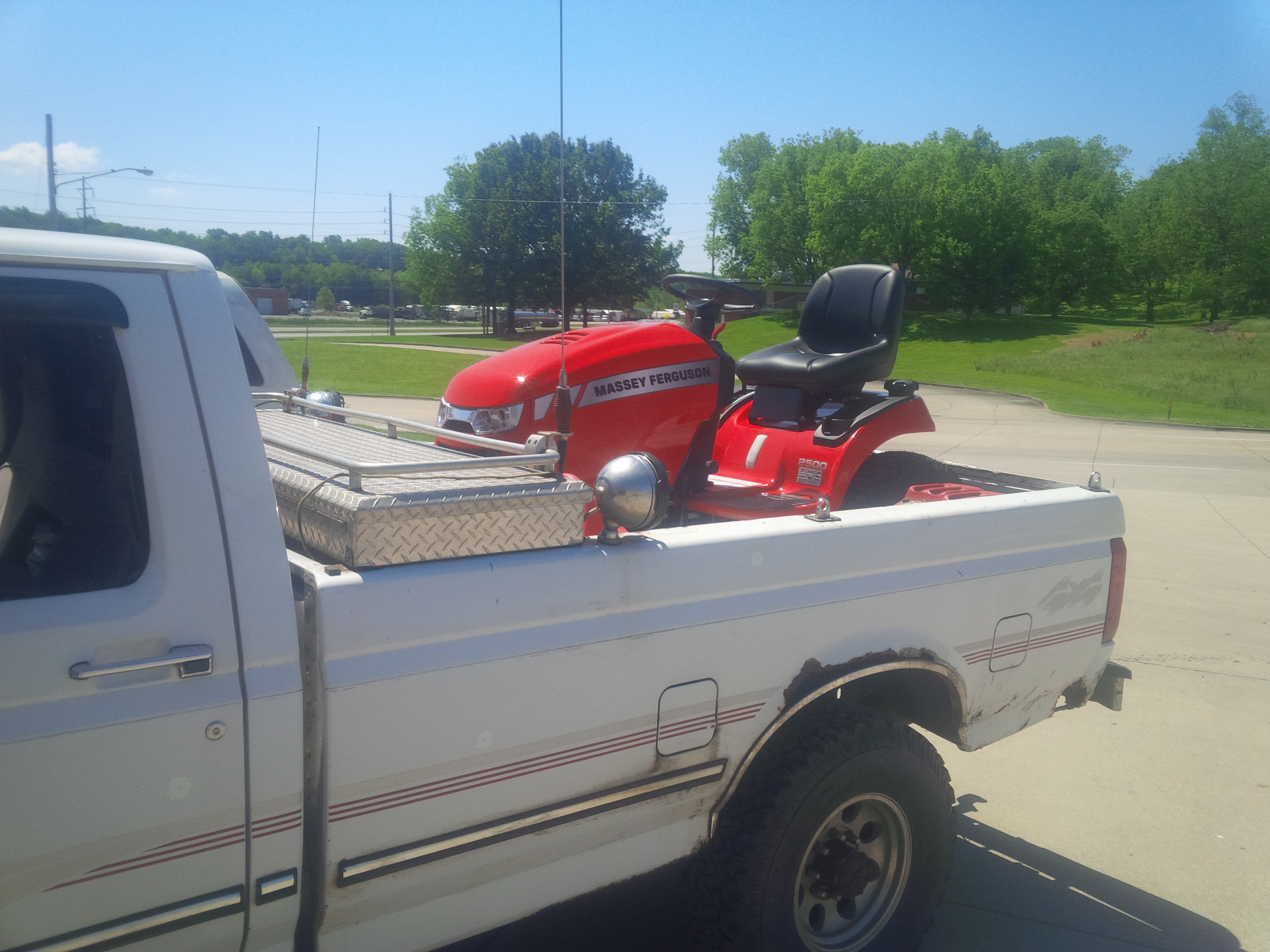

So we ended up back at Massey Ferguson and I'll be picking this up tomorrow:

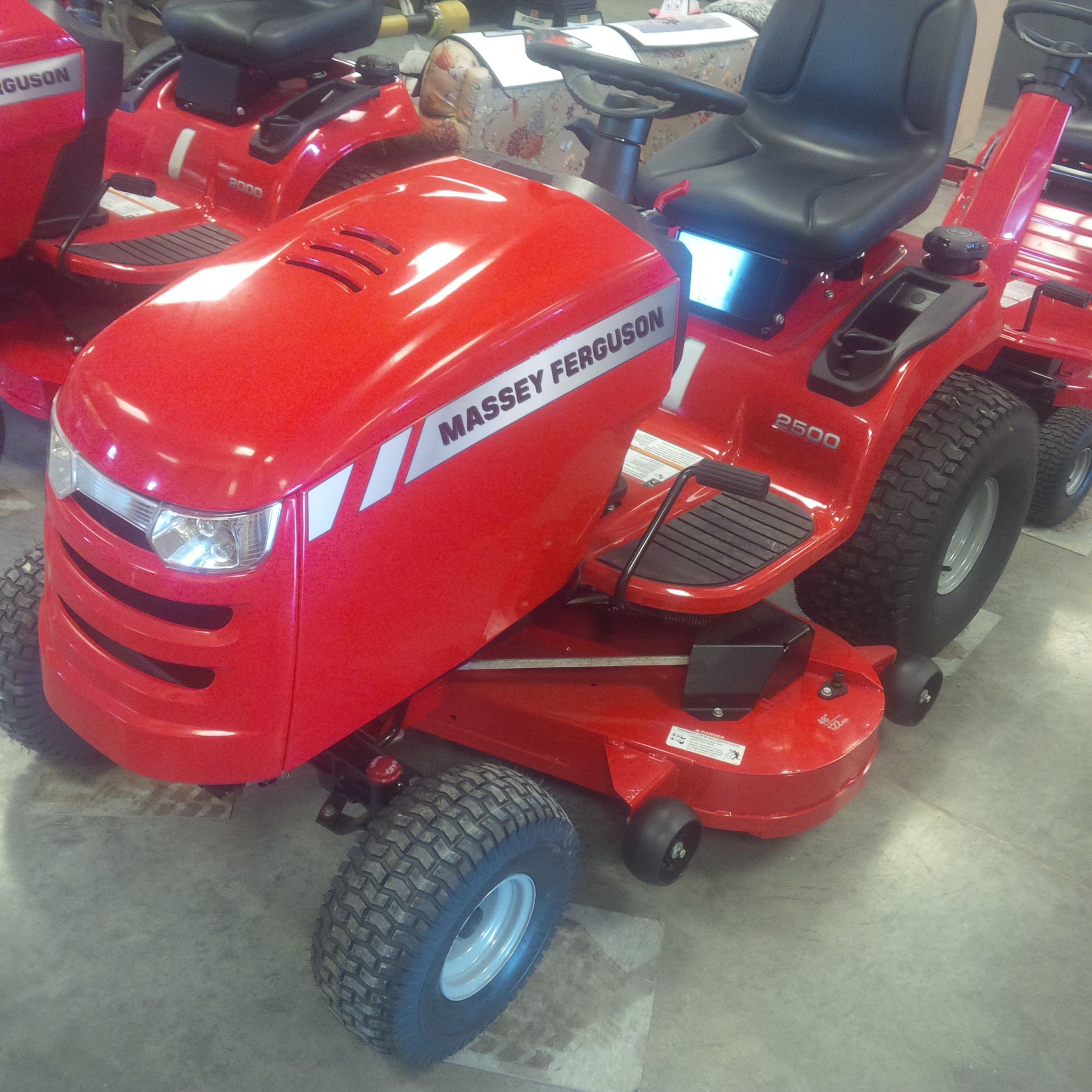

5 hours ago, Dirtymilkman said:
They're a good mower. Same as a simplicity brand.

8 hours ago, Outbehindthebarn said:
Looks like a heavy duty deck.
That's one of the things I liked about it. My last riding mower lasted 33 years...and I expect this one to last just as long (if not longer...I inherited the Craftsman from my grandma after grandpa passed away and the family had been caring for the lawn. Grandpa always took care of it and even rolled the yard in the spring for smooth mowing all year...but the family didn't want to "waste time" on such a chore...so they'd just race around the yard beating the hell out of the mower, neglect maintenance, and when it finally quit running, they parked it outside and made grandma buy a new mower. First time my older brother mowed with the new mower, he bashed in the grille crashing into the house...dumbass...but he'd been crashing the old one into everything, too. I replaced the fuel line and fuel pump, changed the oil, greased it, straightened & reinforced the tie rods and used it another several years. The motor banged and clanged and smoked a lot, obviously down on power, but it got the job done...until it wouldn't turn over anymore. New battery and rebuilding the starter didn't fix the problem...she was dead. Been sitting in my garage ever since

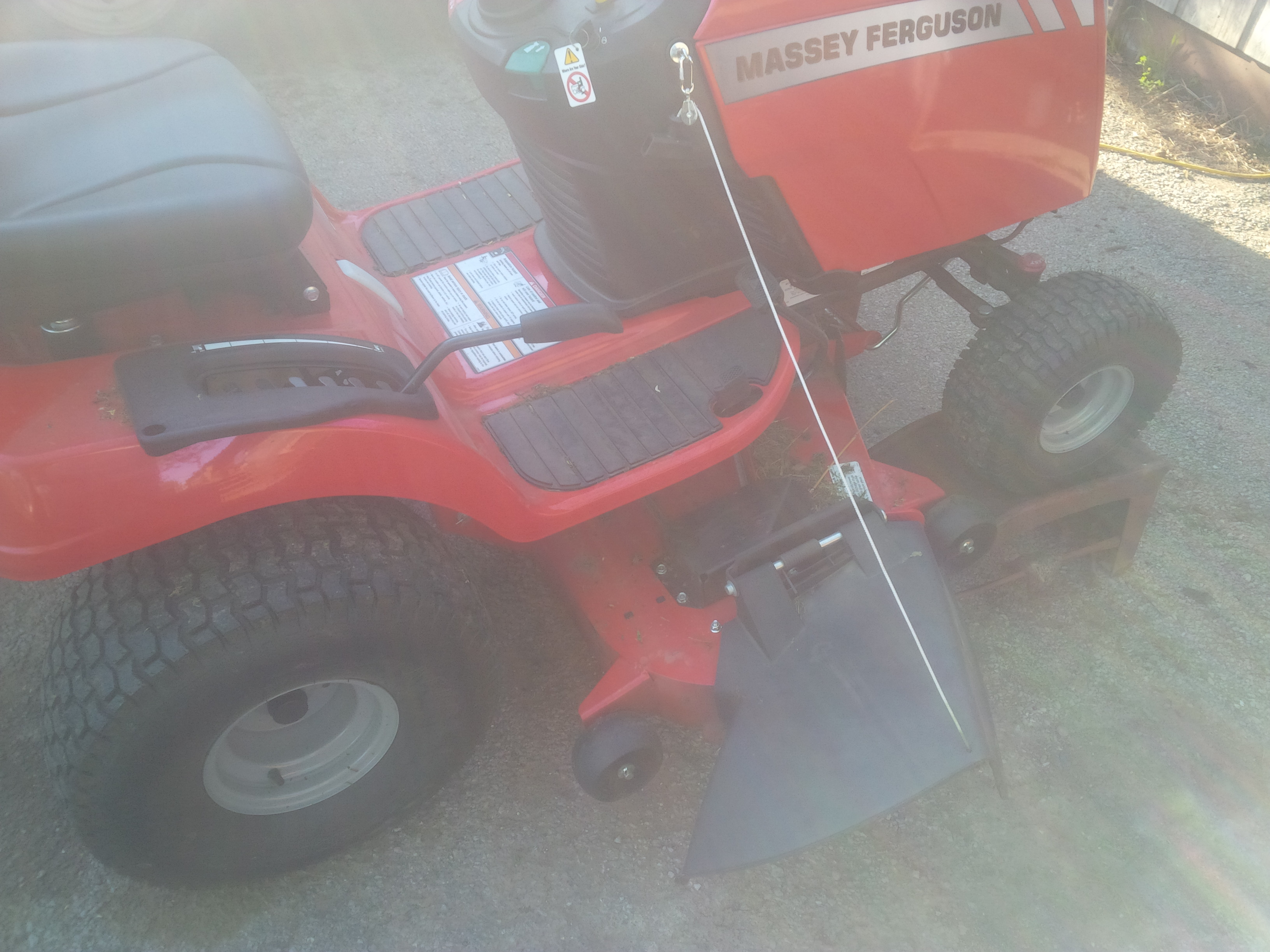

Well, I'm not impressed. Couldn't really cut much faster than my old worn out Craftsman used to do despite having a significant horsepower advantage. Biggest difference is that I had to sit there holding that stupid pedal as I crept along instead of just putting it in low gear and letting it do its thing. Granted, in the lawn that wasn't too out-of-control, it made pretty good time and was SIGNIFICANTLY faster than push mowing...and I finally got to knock down the area between the road & railroad tracks as well as behind the house between the road and farm field. I don't "technically" own that land, but if I don't mow it, it gets to looking like crap and we'd like to get our house on the market this year, so we need to keep things looking nice. Of course since that hadn't yet been mowed this year (I'm NOT push-mowing property and right of ways that don't belong to me for free) I had to raise the deck from its lowest setting up to the middle (of 7) notch and it did just fine. Dropped it back down low to do the back yard and it spit the belt off after about 100 yds. Put it back on and finished the back yard, then started on the horse pen. This is when the thing really started to bug the hell out of me. Spit the belt off again. Put it on, mow 10', spit the belt off again. So, I raised the deck all of the way up. Then, the discharge would get plugged up...and eventually the belt would start slipping, and before long it would spit it off again. Needless to say, I've gotten pretty damn good at stringing that stupid belt around the pulleys. Never had ANY of these issues with that old Craftsman. Some of the "safety" features are already bugging the hell out of me, too...can't even shift my weight on the seat without it trying to die, so I'm going to put a jumper in that circuit instead of having the wires plugged into the switch. Also added a pull-cord to raise the discharge guard when I'm mowing close to anything, although I quickly discovered that trick works real good along a fence line or small trees...not so good next to a house or large tree. Great way to end up wearing the clippings. Tomorrow, I'm going to fabricate a hitch for it. Sure, I could get a 1-7/8" ball with a 5/8" shank and put it right on the back of the tractor...but all of our trailers that are small enough for this thing to handle have a 2" coupler. Smallest shank I've found on a 2" ball is 3/4". That and it's about 2" lower than what would be ideal...so that's tomorrow's project.
Anyway, still not impressed with the hydrostatic drive...wish they still made these with gear boxes. Deck design also seems to have taken a step backwards, too, since it clogs up and can't seem to keep the belt on the pulleys. Other than that, it seems to get the job done.
I had put the pull cord on before I started mowing, but my phone died before I could snap a pic...so yeah, the mower is a little dirty. Pic was taken the first time I had to put the belt back on.
