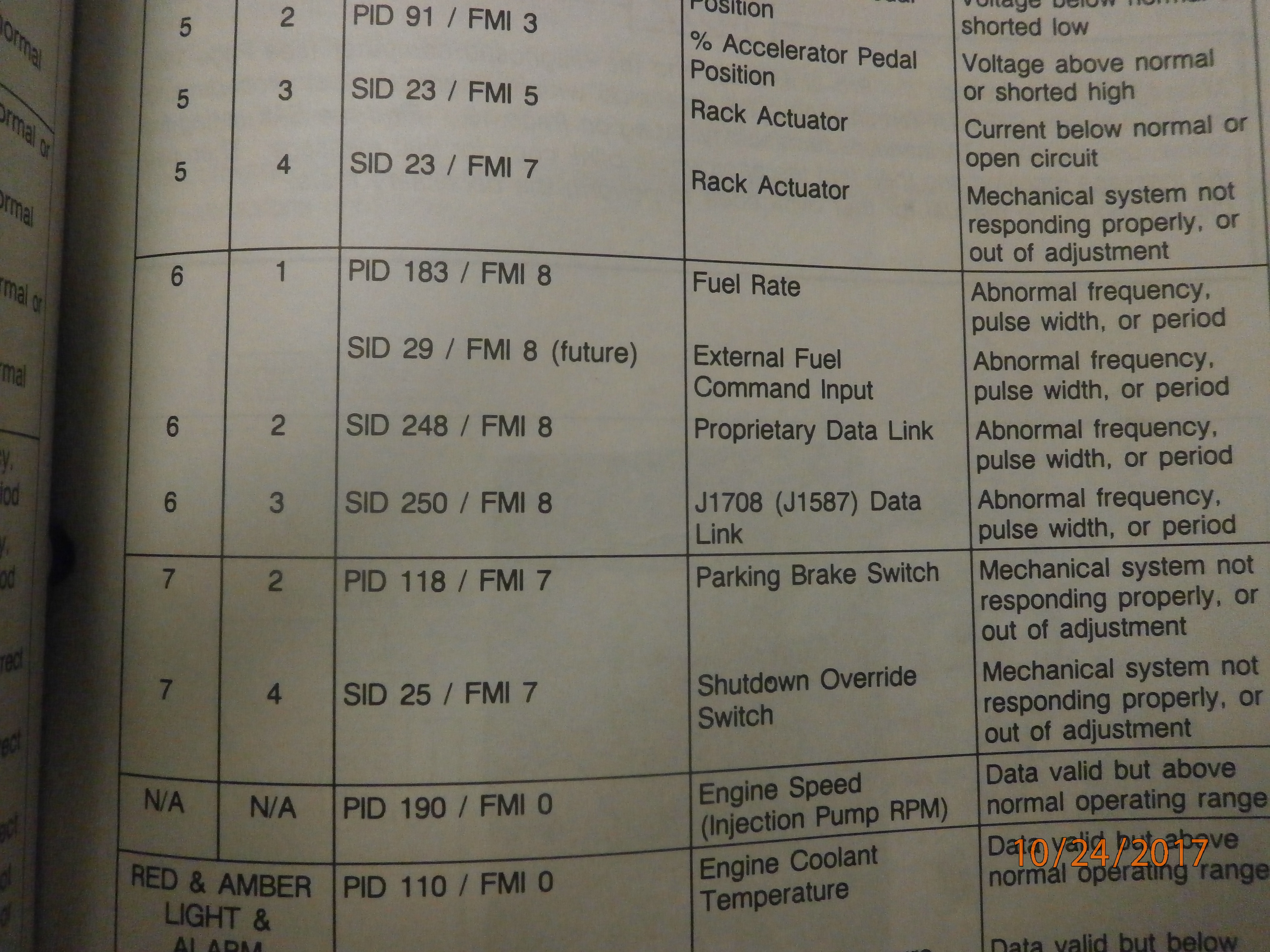

Hi. I'm having similar issues with 2000 E-7. Engine was swap out couple yrs.ago boss says it's never run right yet. It was shutting down on a driver and i pulled off line. Found 4 codes not any that would cause shut down.I think it is something stuipd like fuel pickup blockage but it dies like electrical. I would to hear more scenarios with intermittent shutdowns.than

I have a 2002 CH600 E 7 427 with the stalling issue but sometimes won't start for 45 mins other than the stalling runs fine. it was codes 6 and 4 that flashed but now it won't show any code do they reset themselves? Any help would be great thanks in advance
