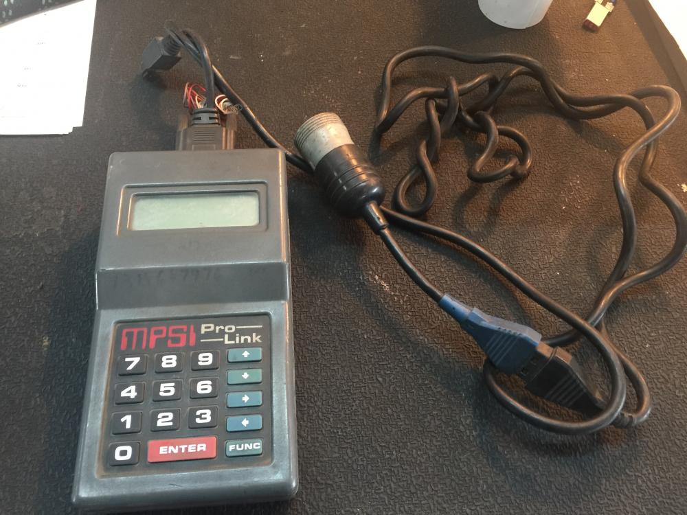

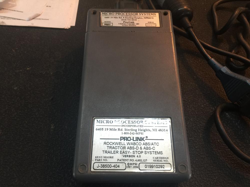

A prolink 9000 with the vmac 1 cartridge will do what you want to do plus setting parameters and look at  switch status  Bla bla! Good unit
The otc hd code reader will also read and clear codes I have a Mac tools HD code reader works well for it ( SAME as OTC) You can't program just read and clear! The V Mack software is  a half decent but I think you got to buy it thru mack IF They still offer it!
Sadly all our old Pro Link stuff wore out and we now use  the Mack Tech Tool/VCADS  program  on VMAC 1 and VMAC 2 and its horrible to navigate and do anything.  Excluding our wrecker , we only work on 1 or 2 of the older VMAC's  a year. The Pro Link stuff if you can still get it is the best.
Google prolink 9000

Has anyone used another scanner than the hard to find and expensive Kent Moore/Pro-Link readers?
I found a scan tool $150, data cord $146, VMAC disk/insert $350 but no power cord yet and that is used with no returns.
