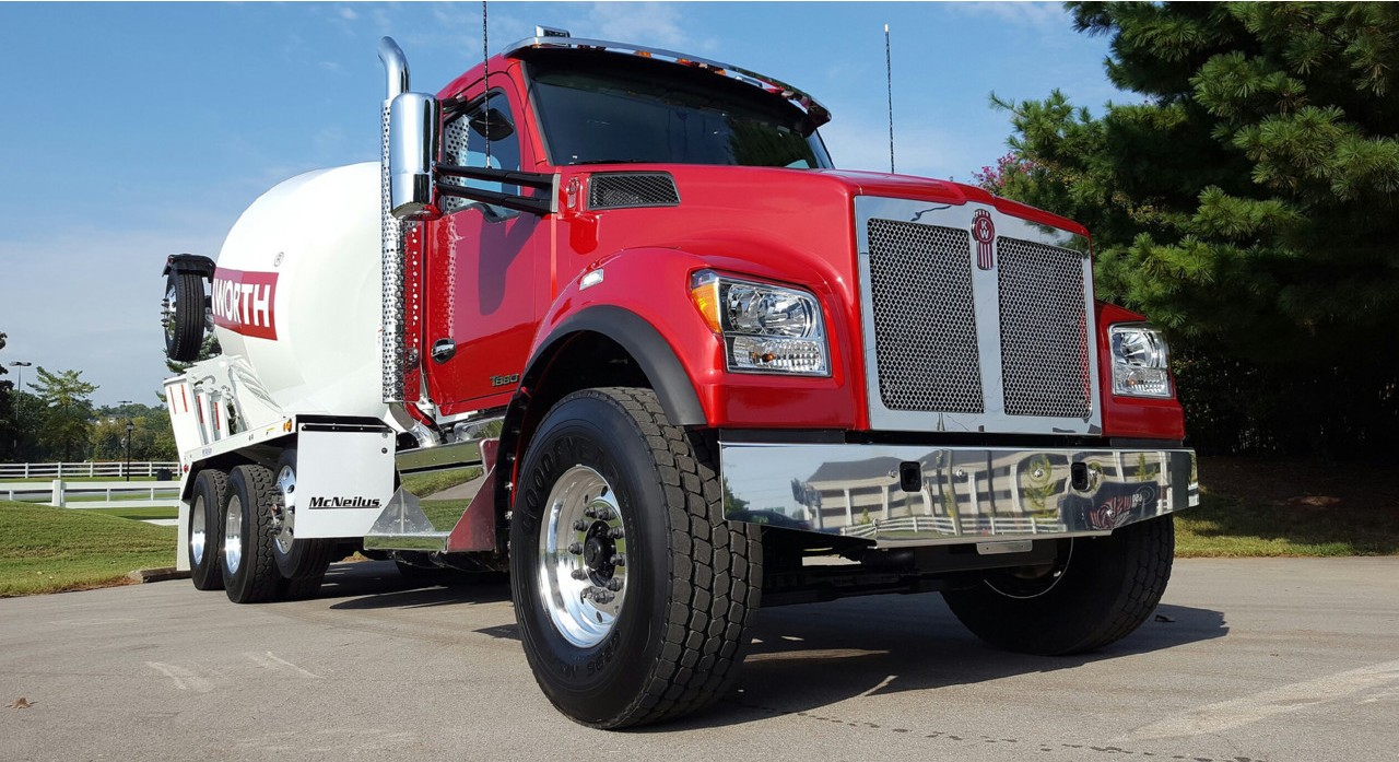

Two new Kenworth T880S set-forward front axle mixers are Kenworth’s showcase construction trucks at the upcoming 2017 World of Concrete Show Jan. 17-20 at the Las Vegas Convention Center.
Kenworth’s booth (No. C6020) will feature a 5-axle Kenworth T880S mixer with a 2017 Paccar [DAF] MX-11 430-hp engine with 1,650 lb-ft of torque, Allison 4700 RDS 7-speed automatic transmission, 20,000-pound front axle and suspension, 46,000-pound rear axle and suspension.
Also on display will be a 4-axle Kenworth T880S mixer equipped with a 2017 Paccar [DAF] MX-13 405-hp engine with 1,450 lb-ft of torque, Allison 4500 RDS 6-speed automatic transmission, 20,000-pound front axle and suspension, and 46,000-pound rear axle and suspension.
“The rugged and reliable T880S is designed to deliver excellent performance in vocational applications where every incremental pound of payload delivered contributes directly to the bottom line, and excellent maneuverability and visibility are valued,” said Kurt Swihart, Kenworth marketing director.  “With a 114-inch BBC and best-in-class 28-inch bumper setting, contractors can operate highly productive mixer trucks that easily meet the Federal Bridge formula with minimum tare weight and the capability for enhanced body installations.”
The bumper setting is critical to spec’ing Bridge Formula chassis so they remain under the 40-foot length limit, Swihart added. The weight rating for the set-forward front axle on the T880S ranges from 14,600 pounds to 22,800 pounds. Contractors can also choose single, tandem or tridem drive axles, and a wide variety of factory-installed lift axles, to meet their jobsite requirements. The T880S provides clear back-of-cab options that make it easy to configure truck bodies, handle extreme loads and make it easier for body upfitting.
“Contractors will like that the new model’s lower hood profile that provides their drivers up to four feet of additional ground visibility,” Swihart said. “That can be particularly important for drivers operating in the tight confines of many job sites.”
The T880S is standard with the 12.9-liter MX-13 engine, which provides up to 510-hp and 1,850 lb-ft of torque. For weight-sensitive applications, the 10.8-liter MX-11 engine saves 400 pounds compared to a 13-liter engine, offers an impressive power to weight ratio, and low fuel consumption. The MX-11 with up to 430-hp and 1,650 lb-ft of torque is well-suited for ready-mix trucks.
