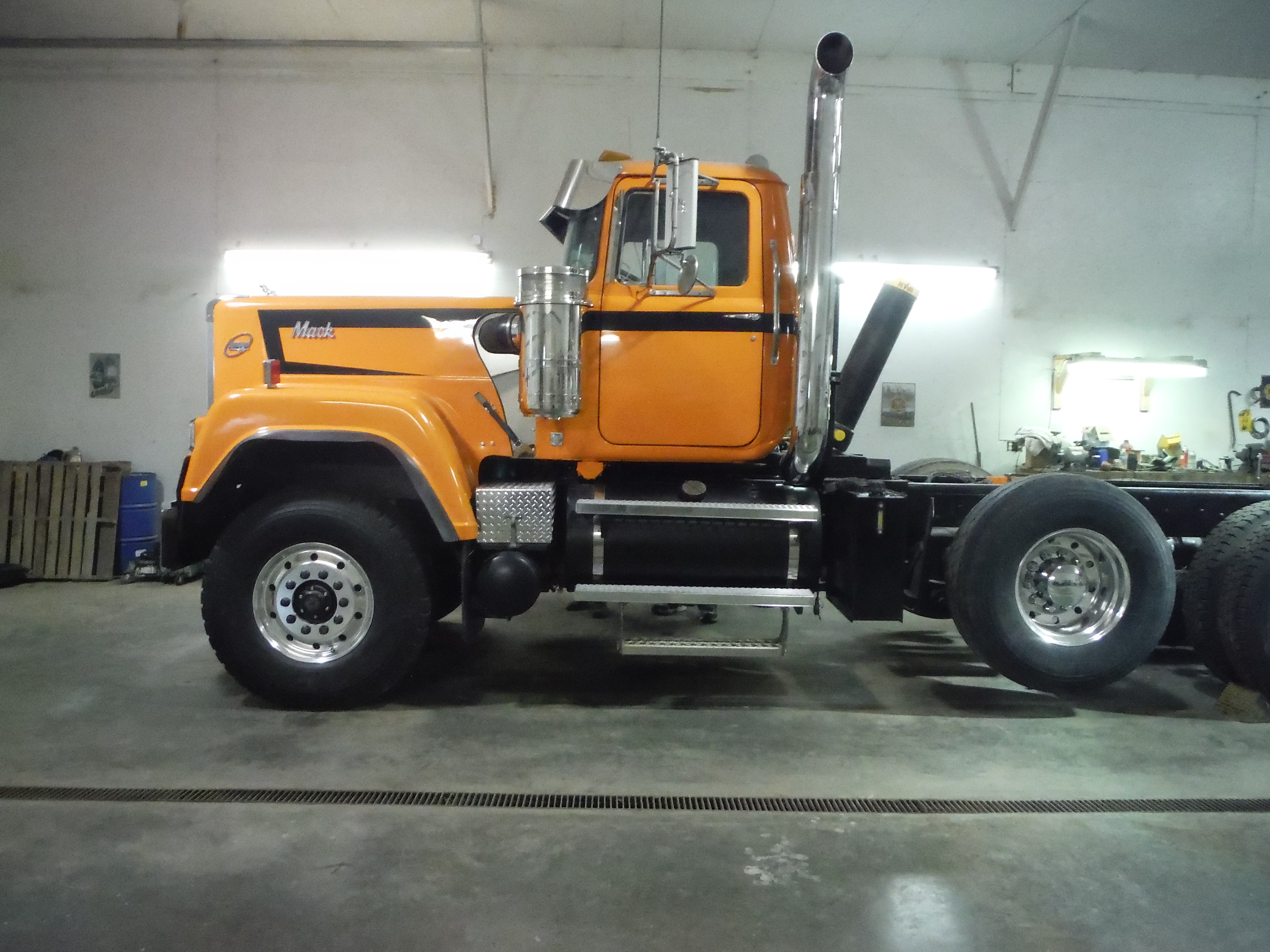

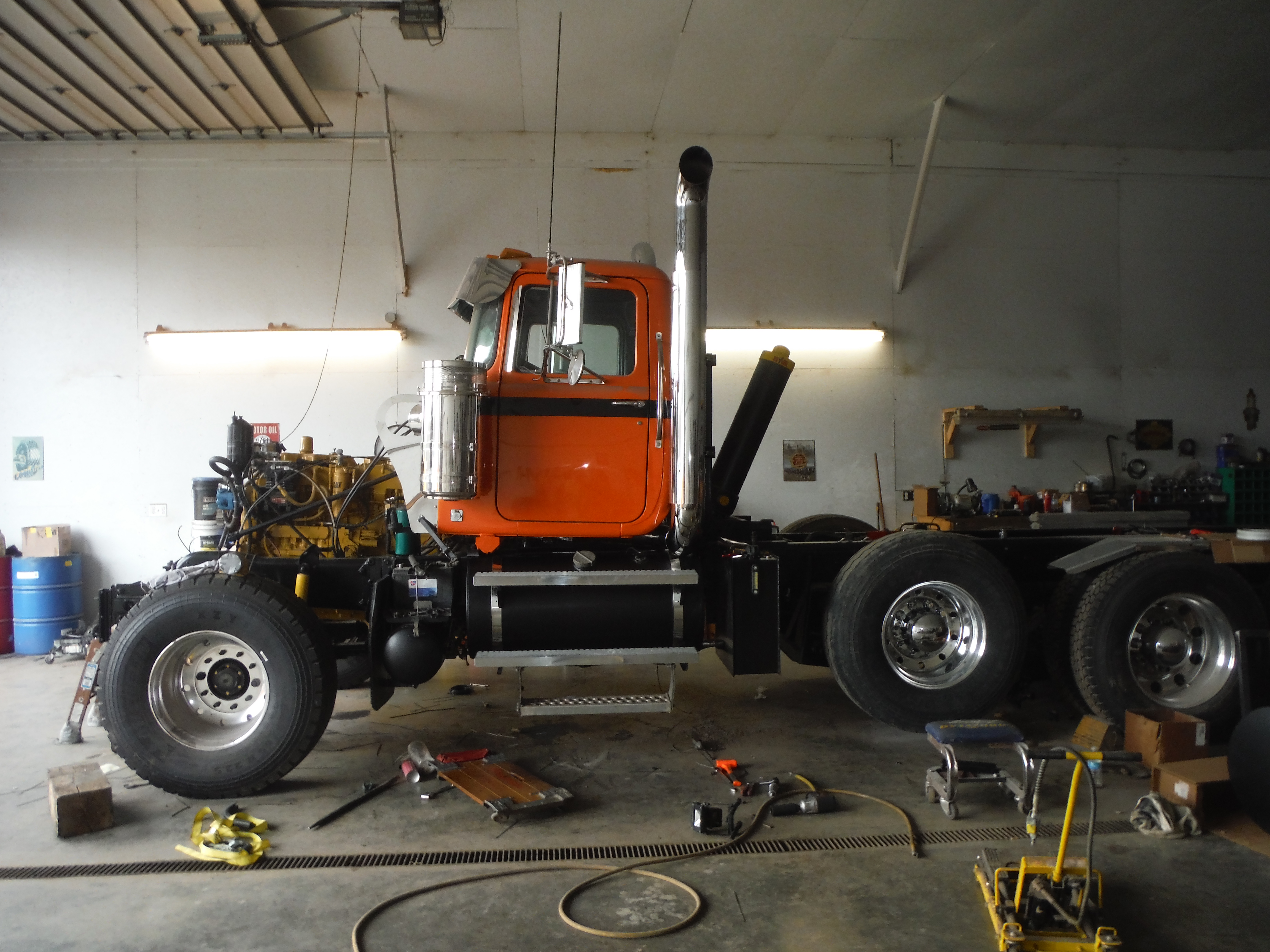

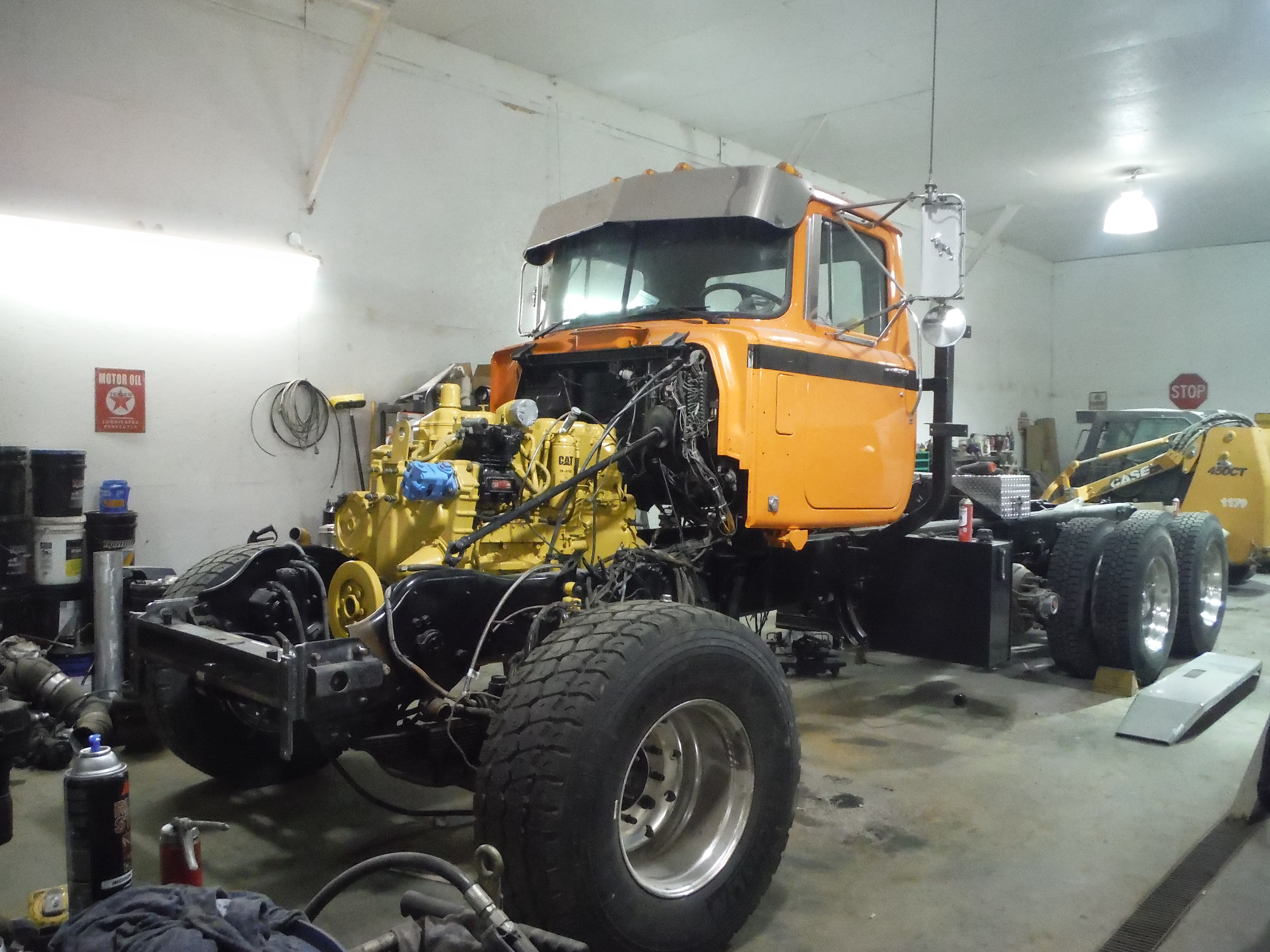

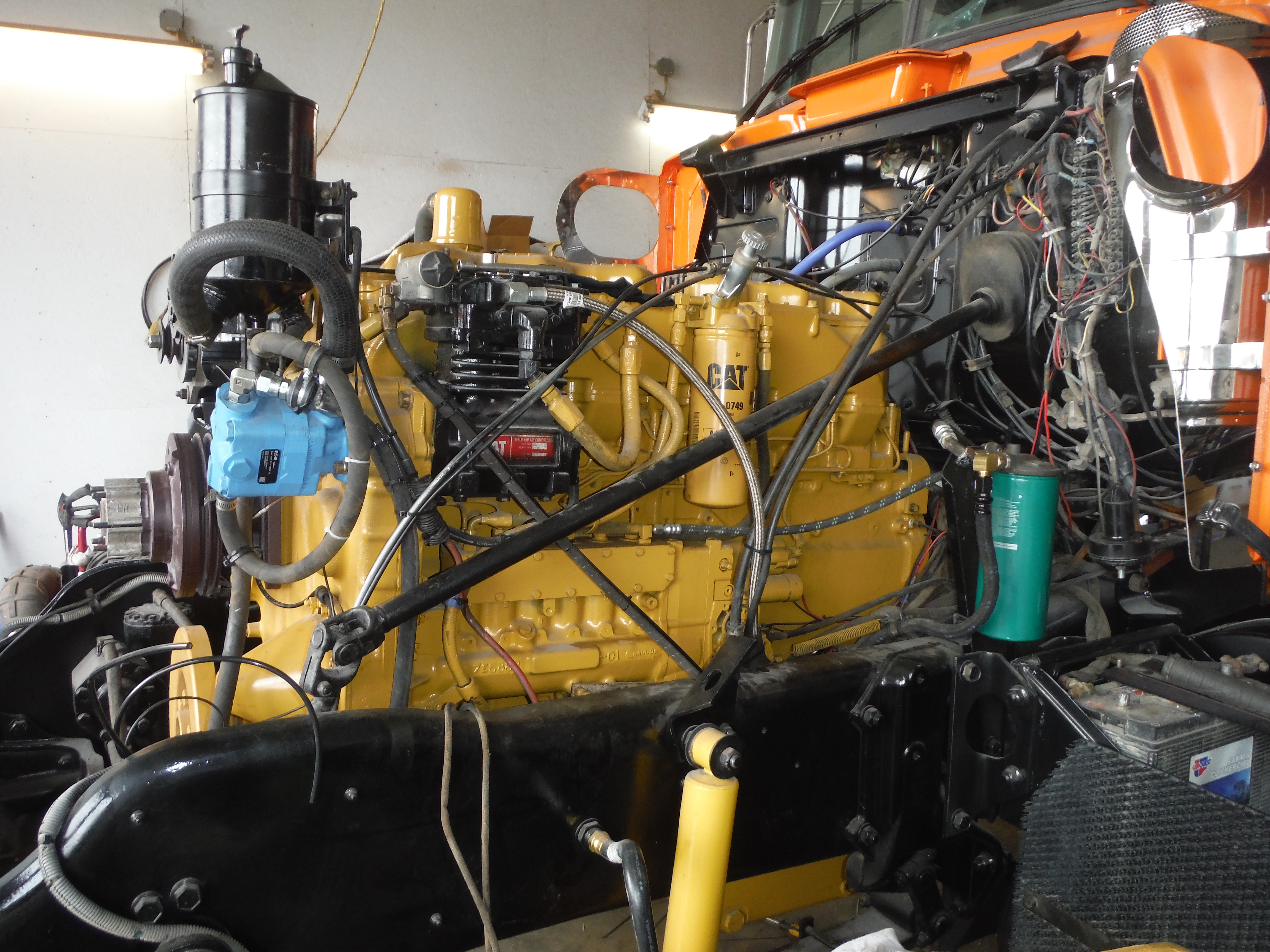

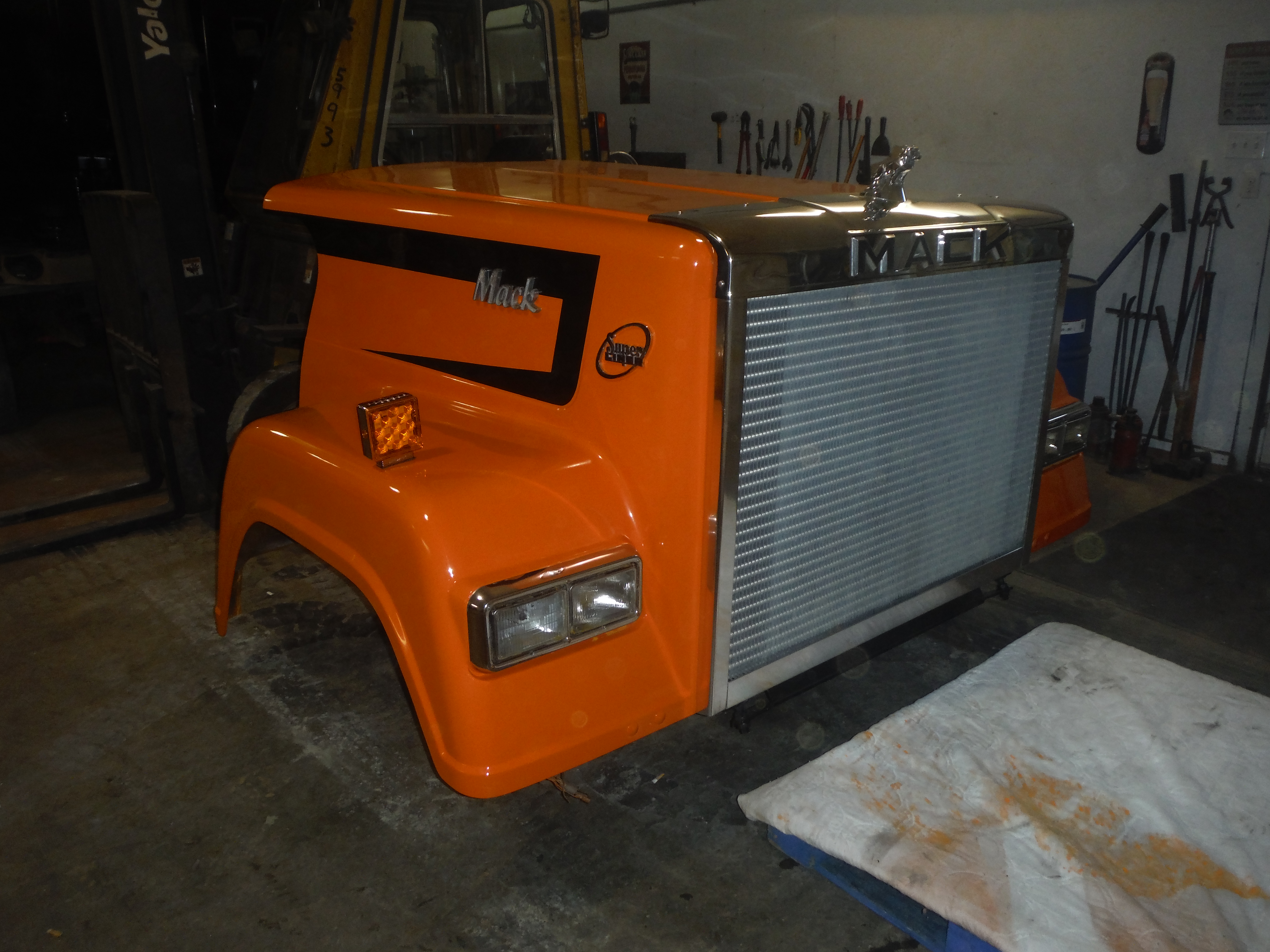

G'day mate,i've been loking everywhere for a picture a front engine mount for a cat into a mack.I'm building a R700 with a 3406b cat motor.I couldn't find anything,then bingo,there are your pictures.
Could I please ask what the diameter of the engine mount holes are?
Can I also ask the distance off the mounting face to the centre of the engine holes? Anything else you think might help
I'm going to have to make one, this will help heaps
Thanks heaps

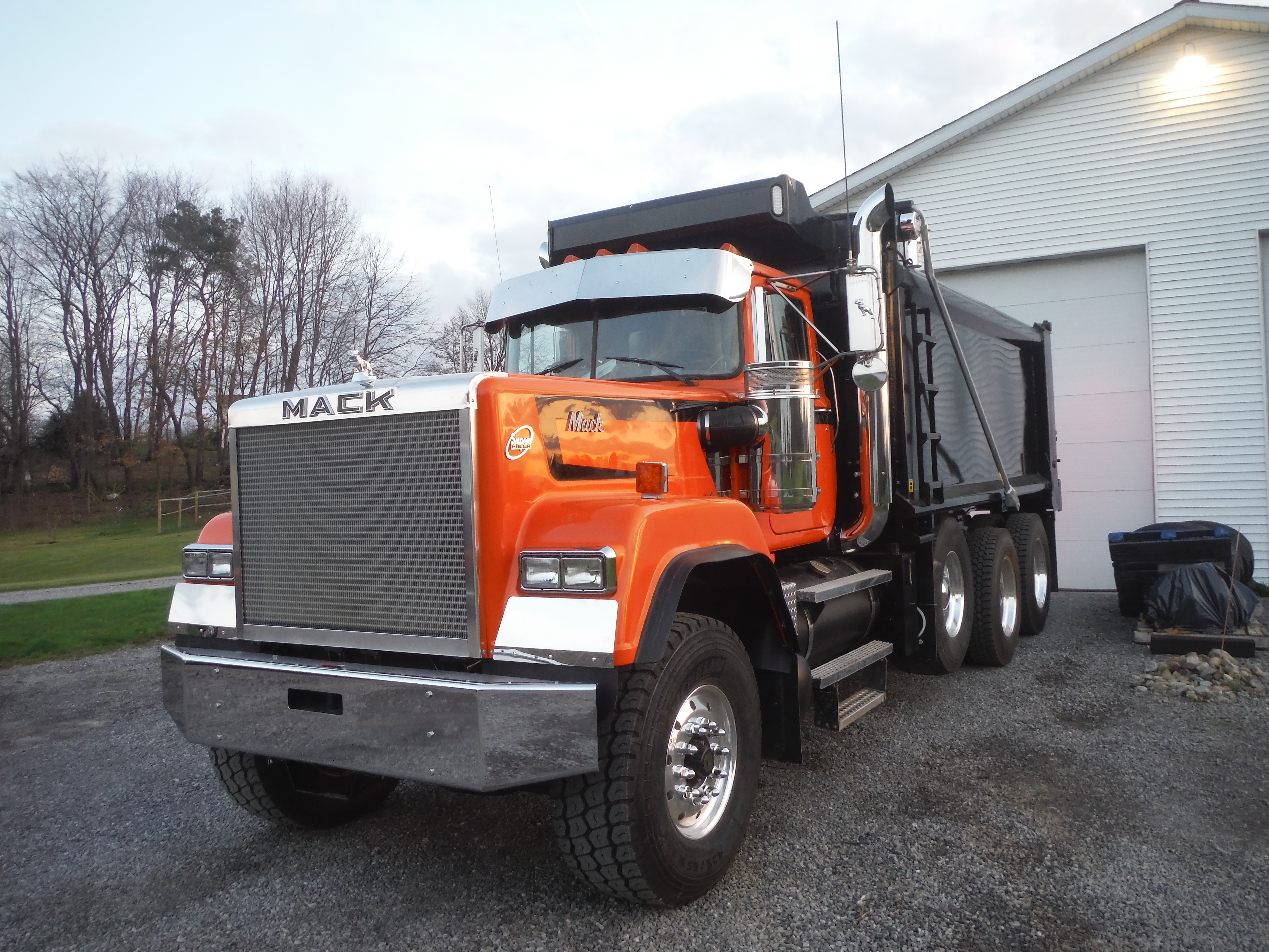

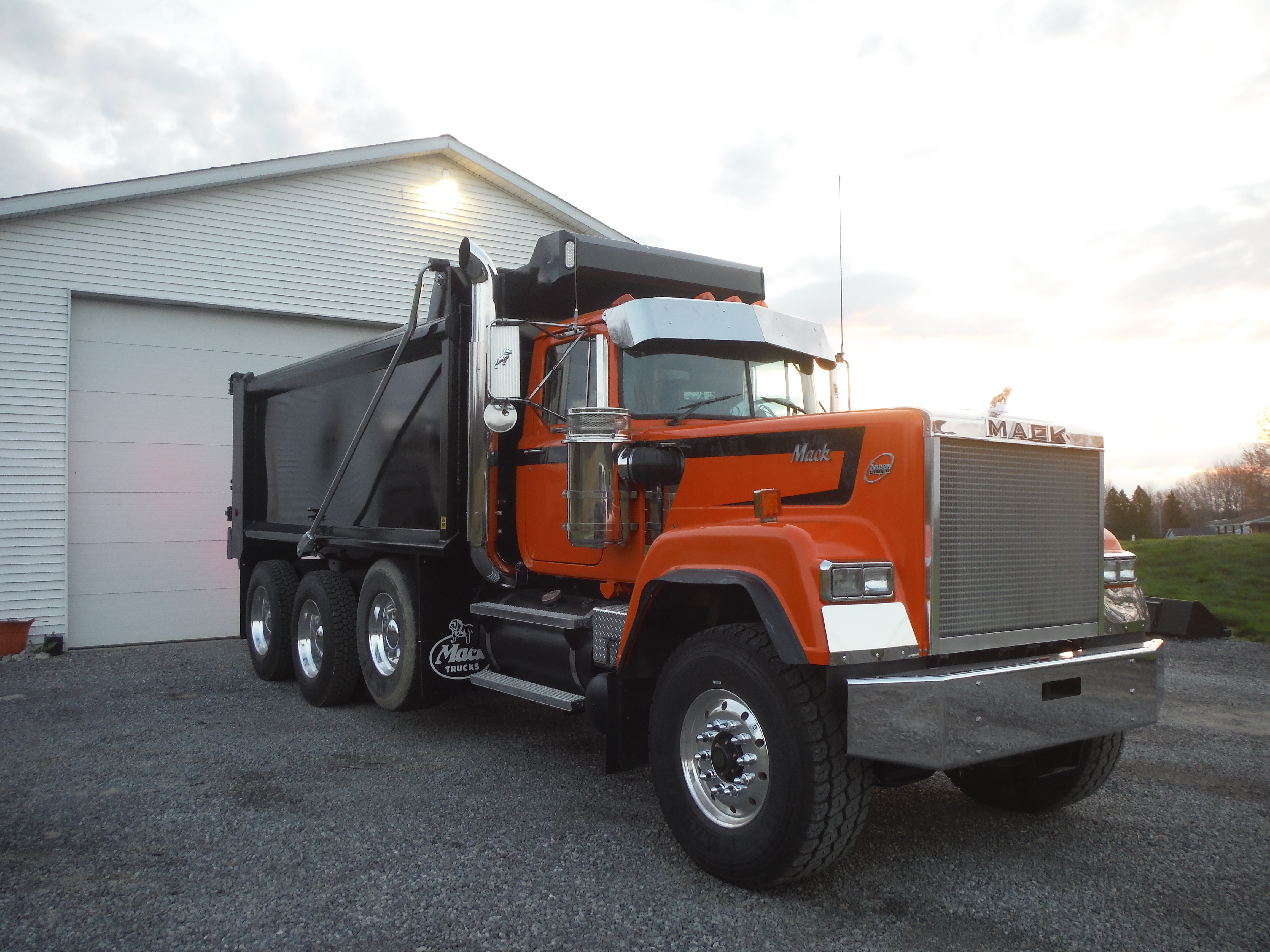

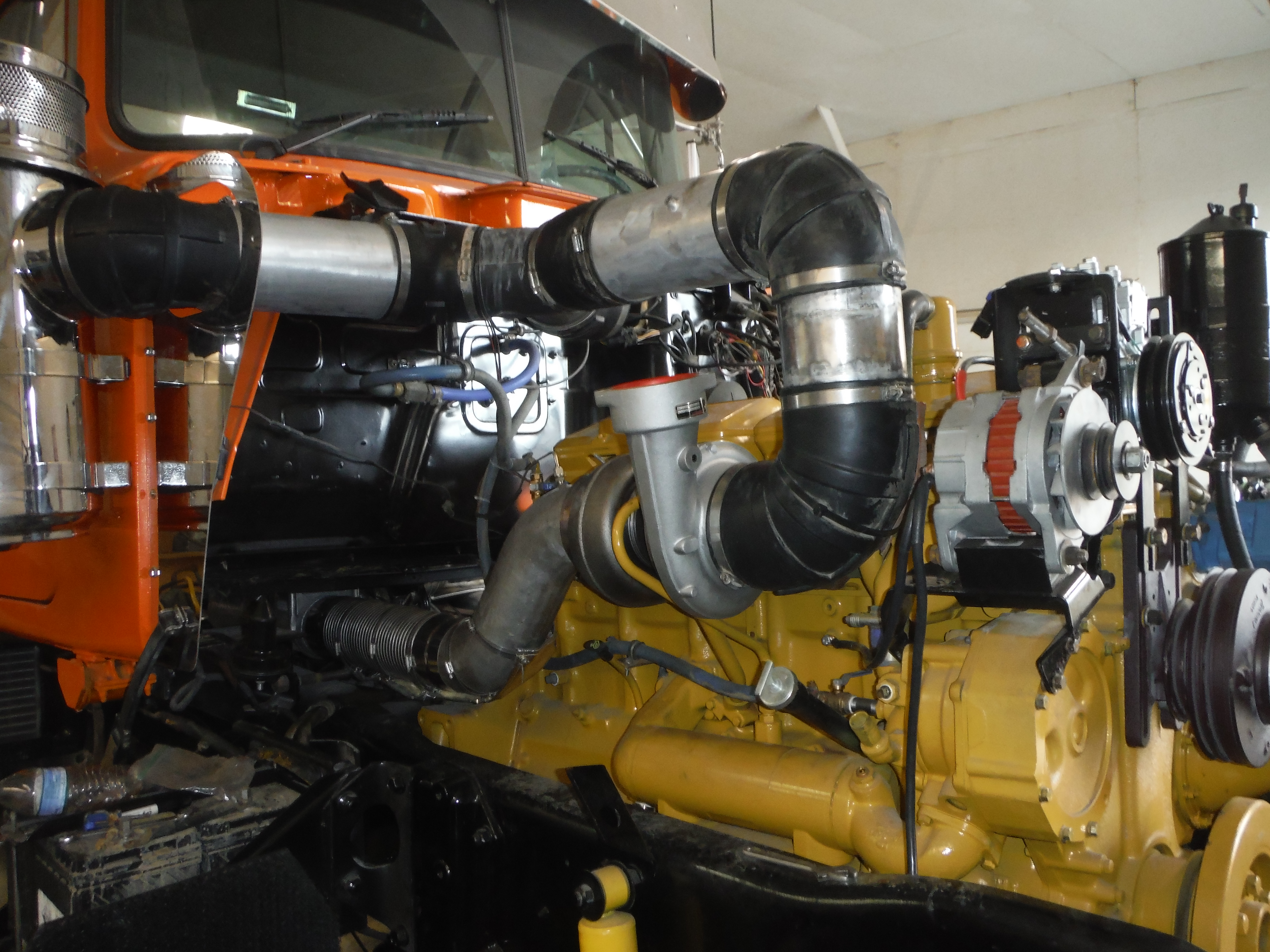

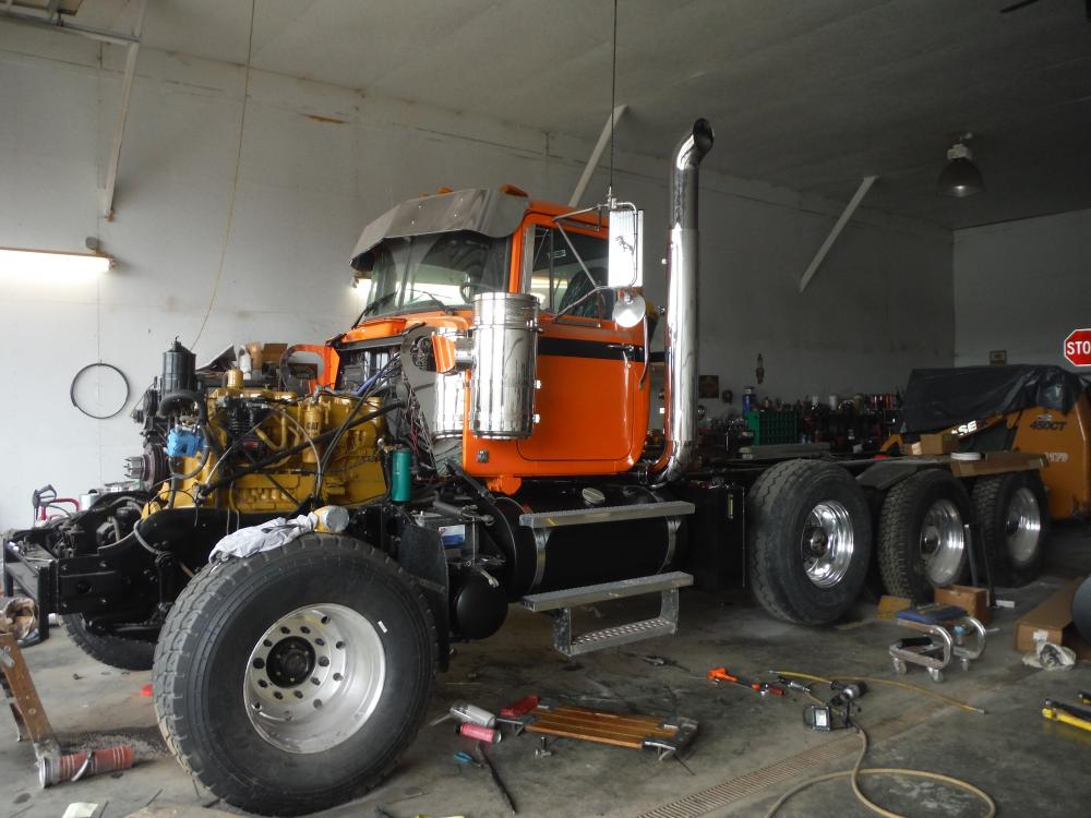

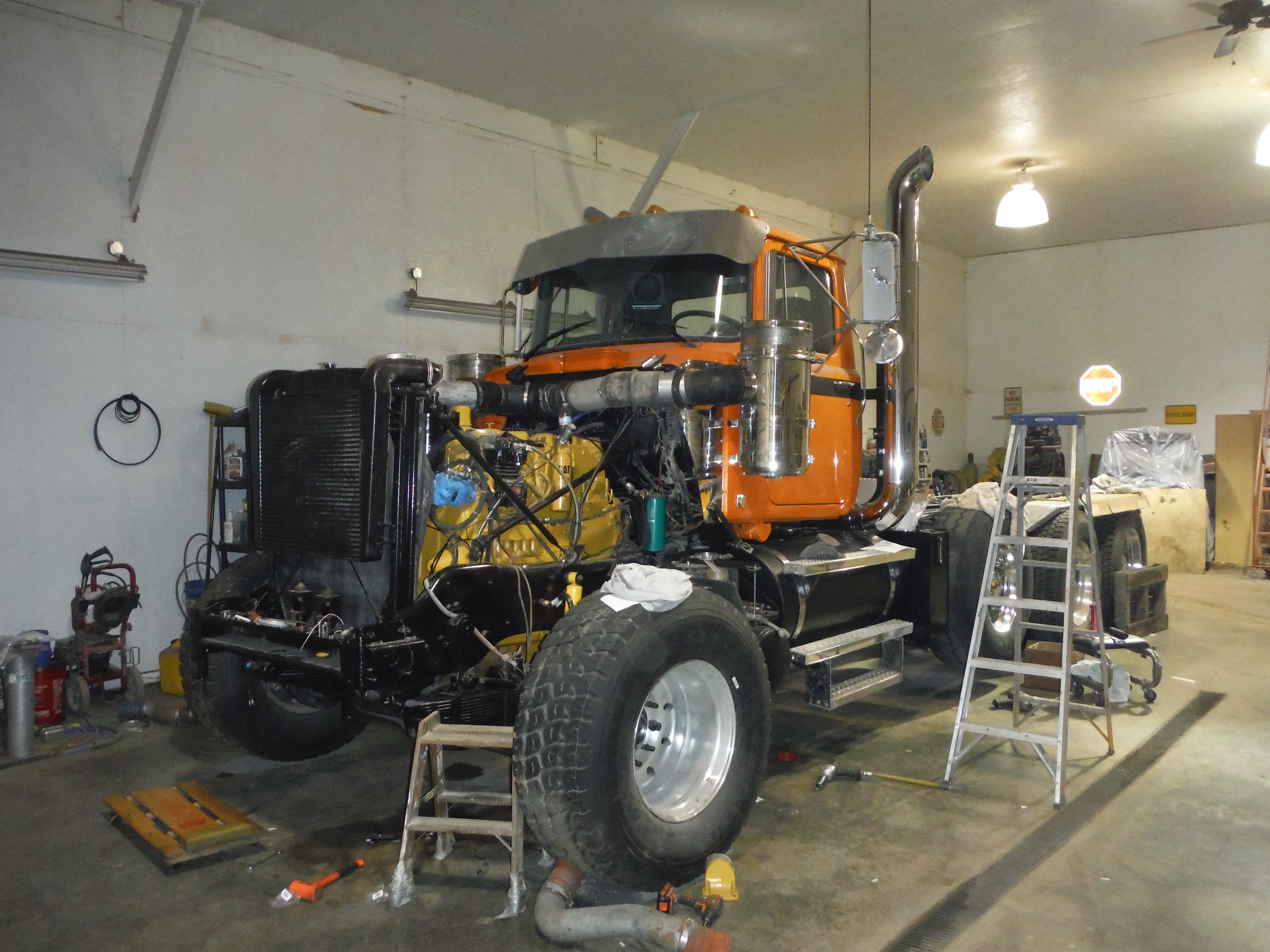

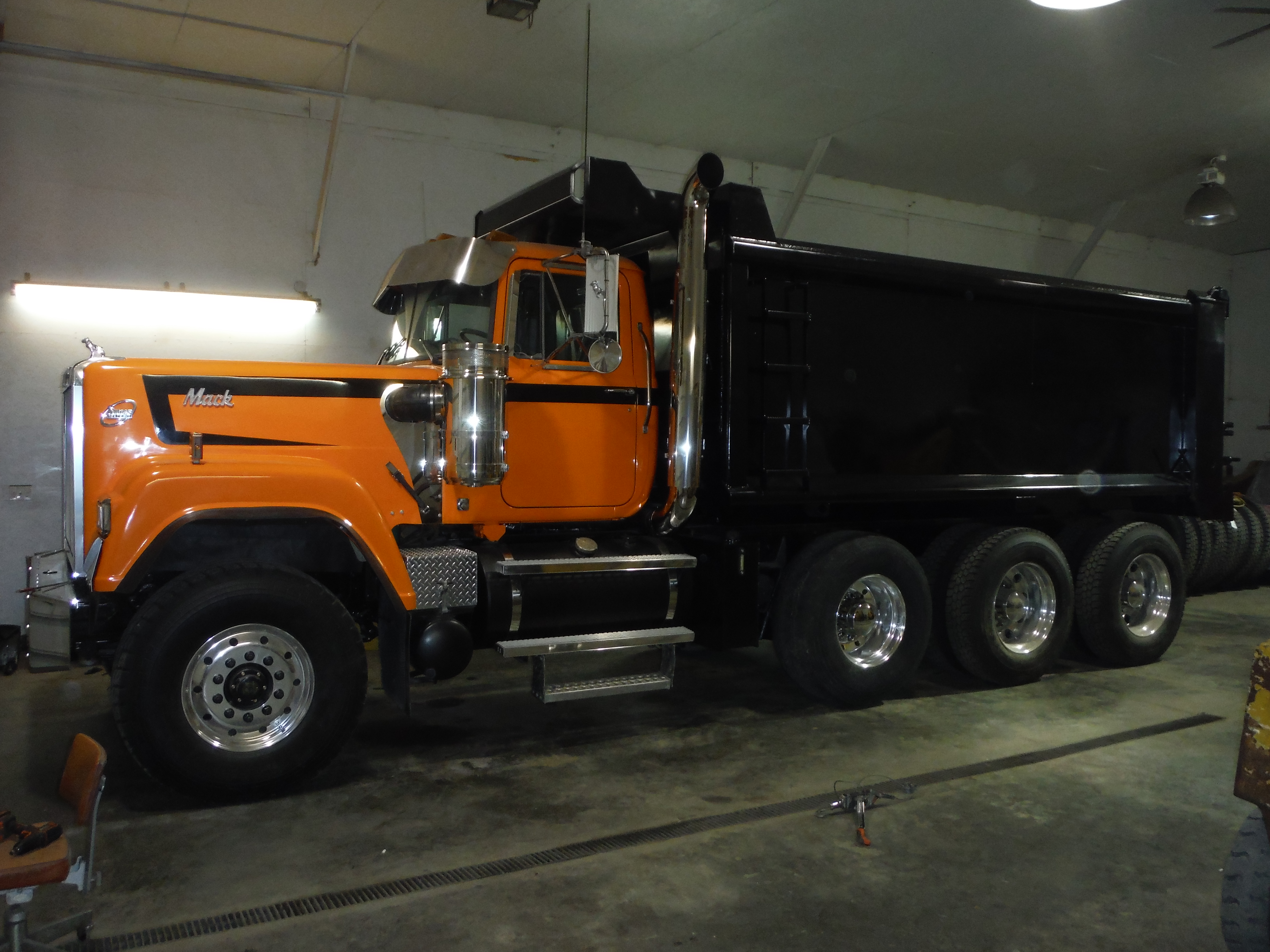

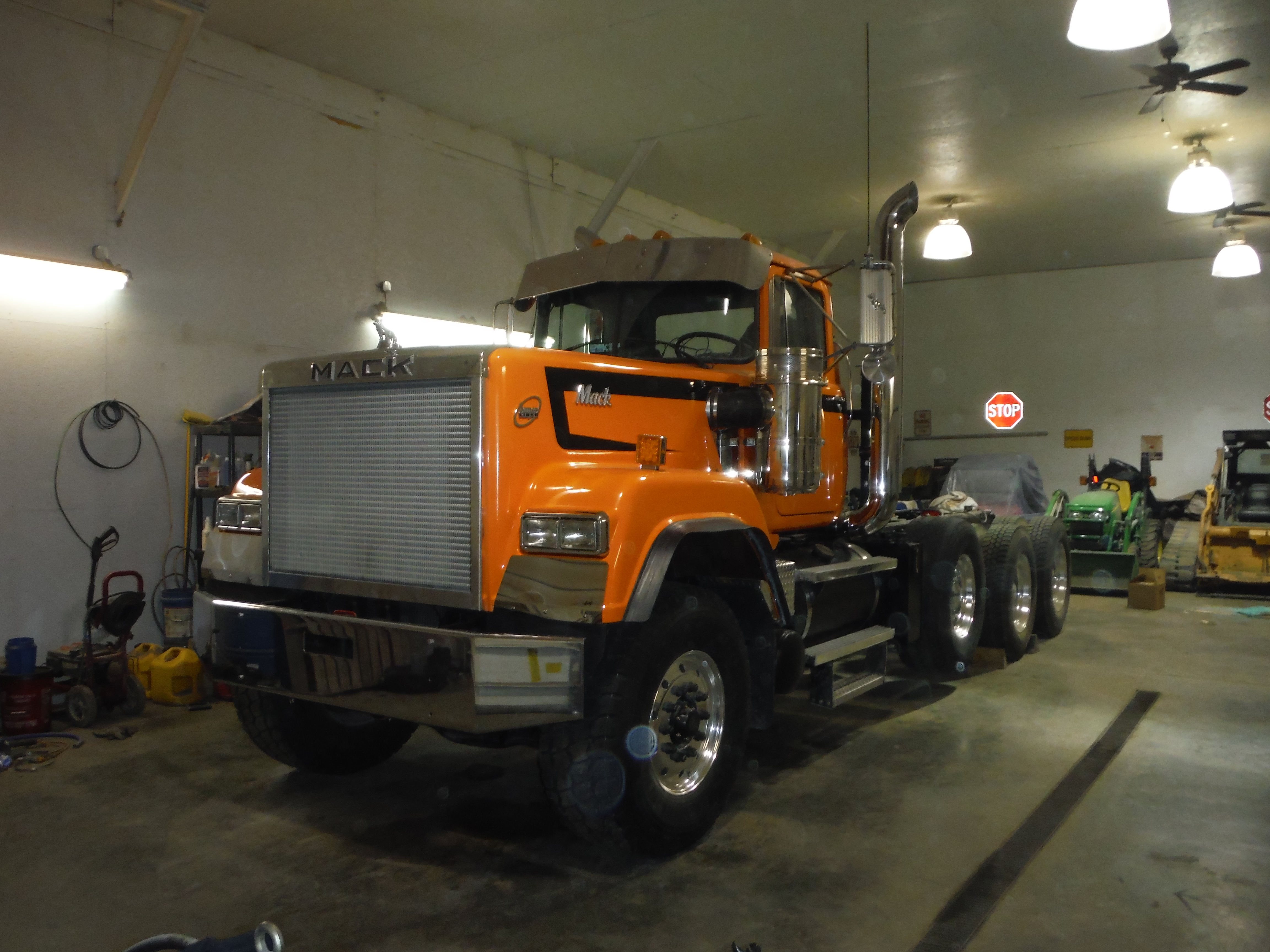

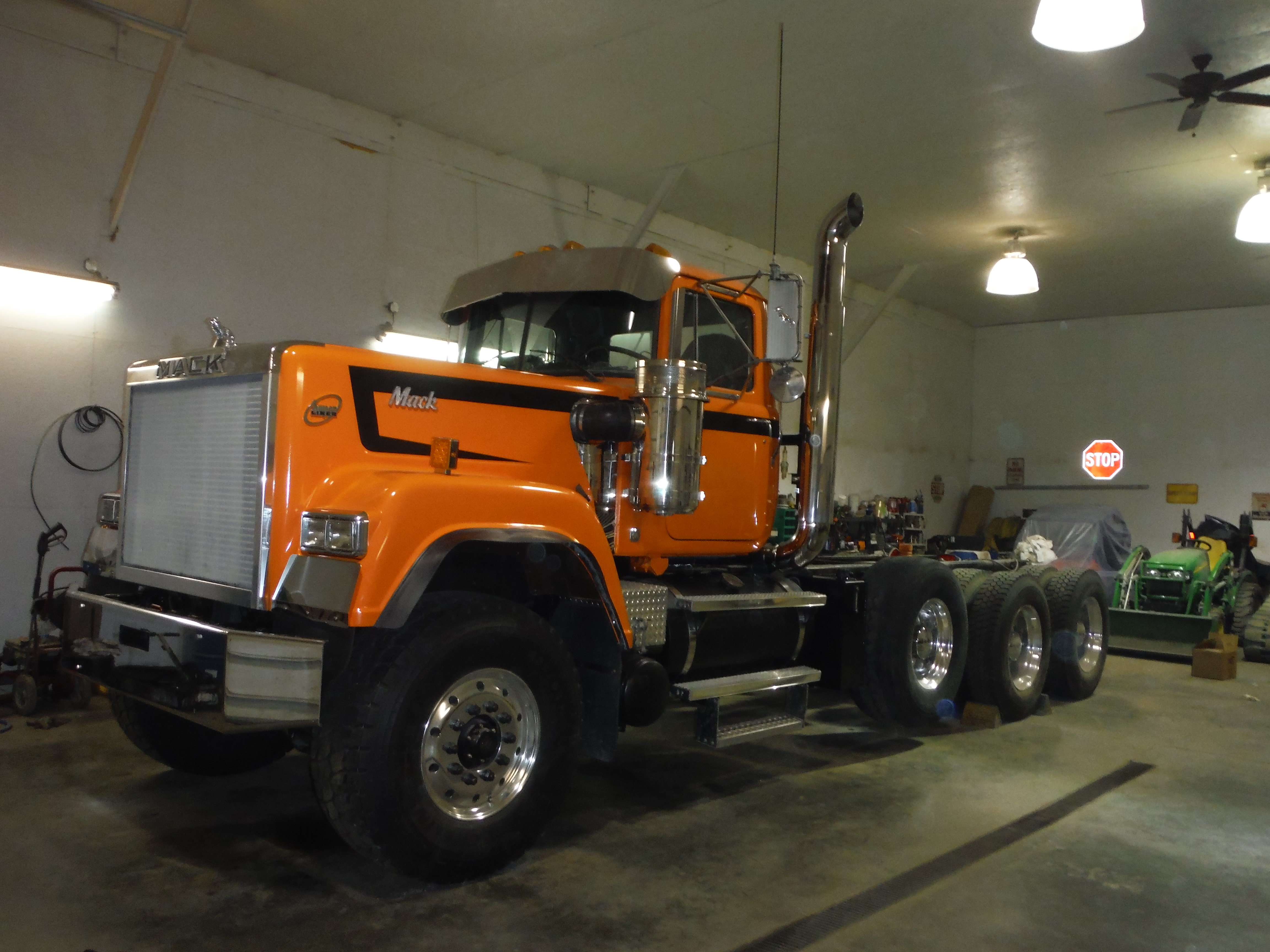

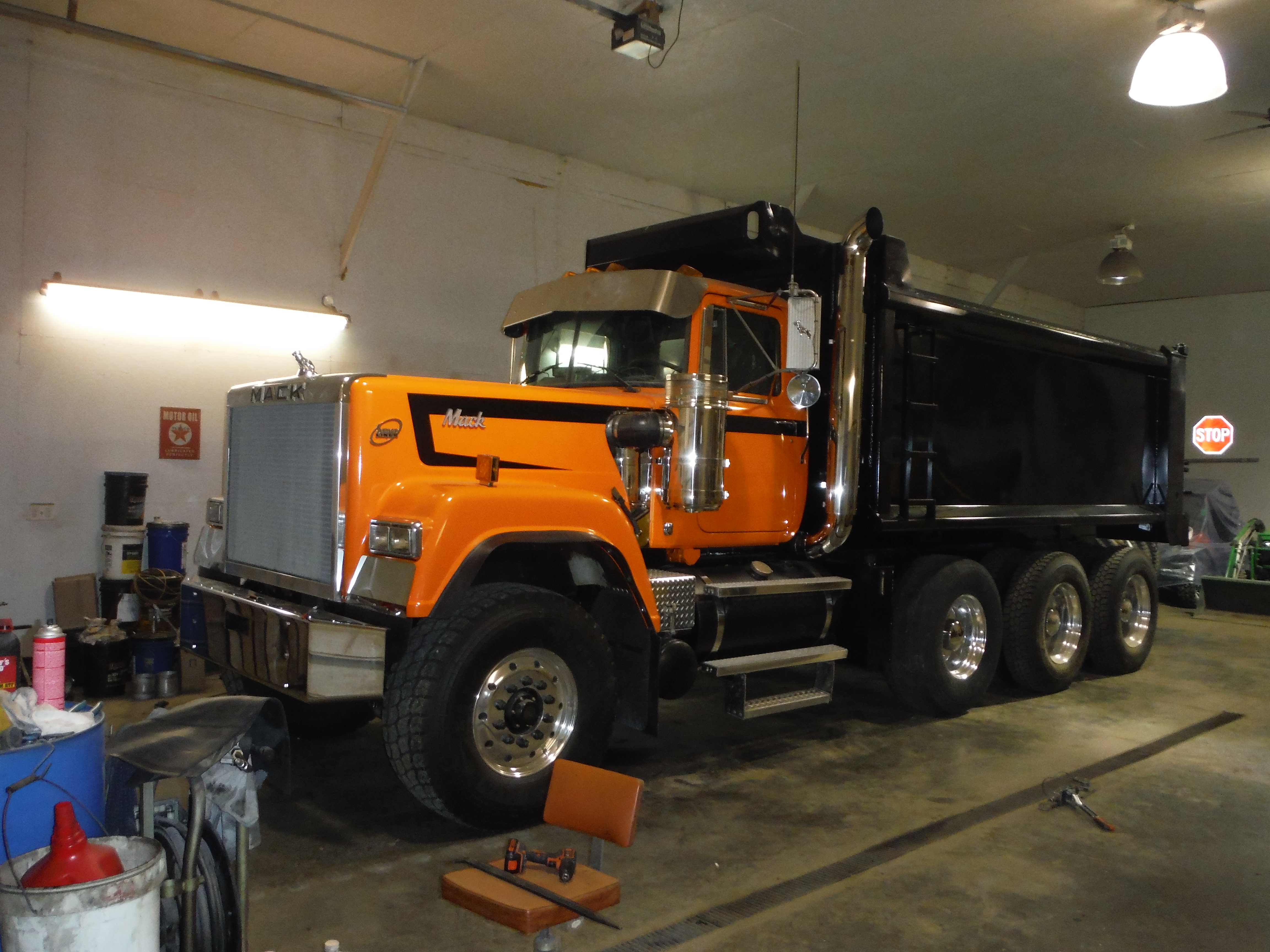

Thanks for the kind words guys, but yes for the most part it has come out as I had imagined a year ago when i got it back home and started a plan ! Changed the paint color from what I had originally  decided on, but you'll have that. I'll try and put a tape to the front engine mount today. Can tell you that rear mounts need moved back 5 or 6 inches and the stock cat mount in the front did'nt come back quite far enough to bolt up, had to notch engine cradle about the width of a bolt.But if you're gonna fab one you should be able to make that up in your mount.  Have a good day !
Thanks guys, mackey , it's steel. Pic of it on first page of thread. For our friend down under and any one else it can help. The front mount is 6 1/8 " from back of cross member to center of mounting bolt. hole size will depend on your engine mount rubber size. Rear mounts at bell housing need to move back 5 1/2" , hope this helps others, I had some time in figuring out the mounting, but the bonus I discovered was,on a superliner all you have to do is move the rear mount back one set of holes so that rear holes of mount are in front holes of forward cab mount ! Easy as pie when u know !

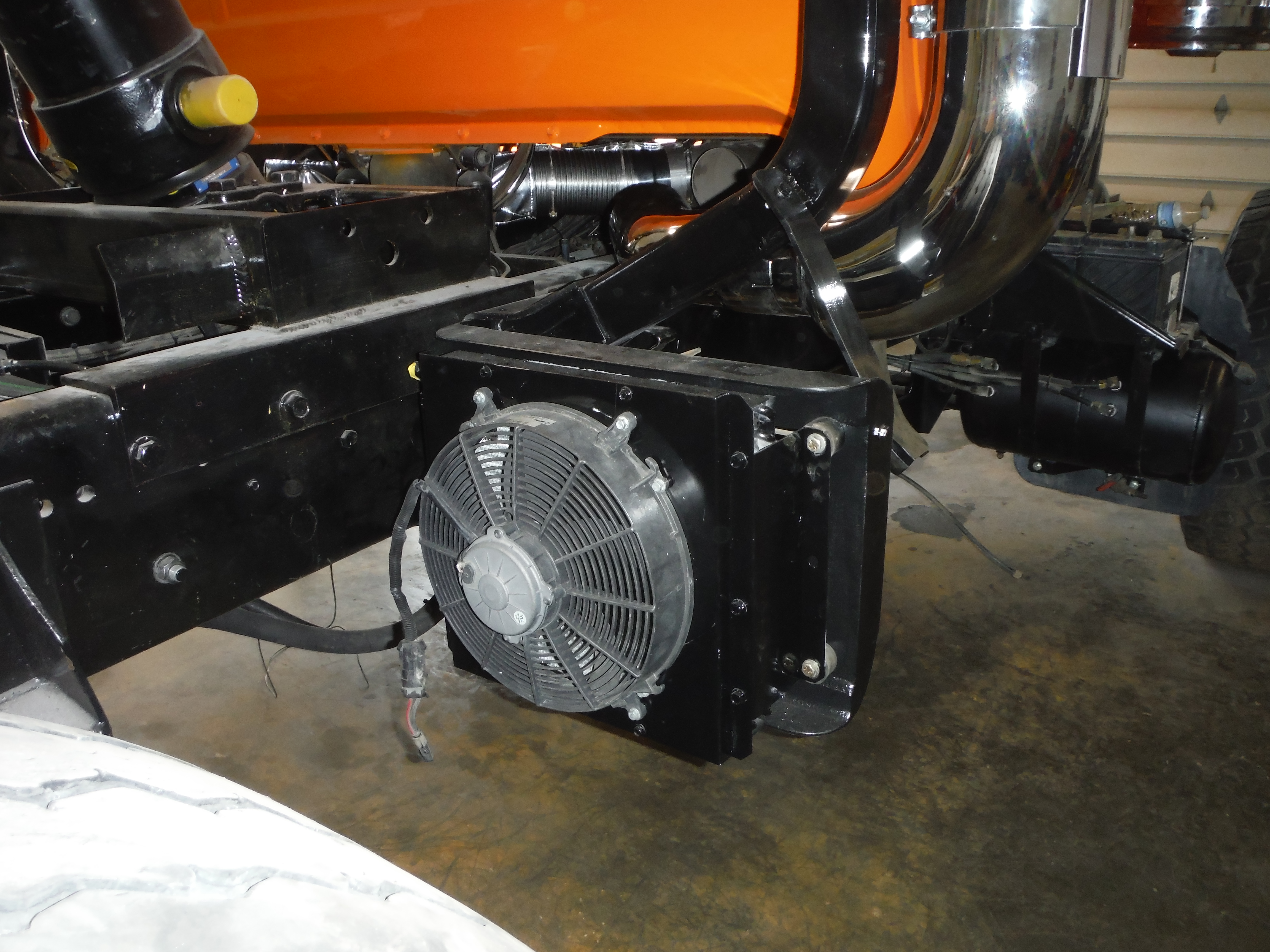

On 3/30/2017 at 6:07 AM, superdog405 said:
Been alot of modifications getting the air cleaners and cat engine to work, but we're almost there ! The one pic is the AC side of a APU I am using for my condenser .
I've never seen front rims dished that deep . great looking truck.
