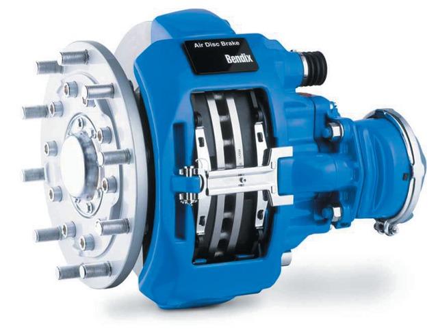

The early disc brakes had a can a arm/lever style, the new Bendix or Meritor ones are direct acting with an air piston. Like day and night. I have the old style Bendix on my '92 Marmon, makes a difference OTR and replacing all the pads on 3 axles isn't a big job.Replaced 3 calipers and one Anti Skid Sensor in 22 years.  The newest are the same design as railcars use.   Paul

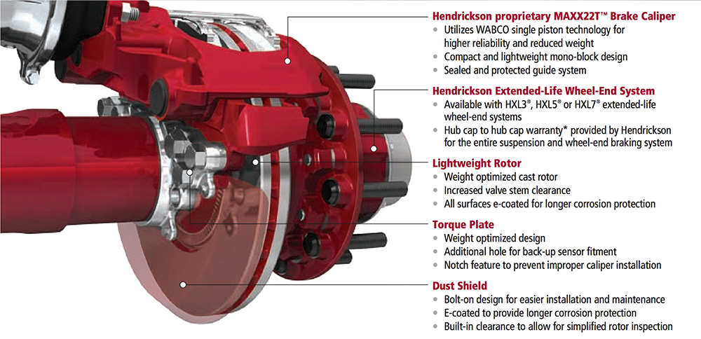

It is a new system designed by Bendix-Spicer, Fuji Heavy Industries and Rockwell International. It was originally designed for the ACELA and the Japanese Bullet Trains. Found it works great on freights and subways. Worked it's way to trailers and trucks.
Pads are available all over now, Napa can get them.
This is for trailer conversion about 3 grand for the entire package for two axles.
New style Bendix same as R.R. units.
