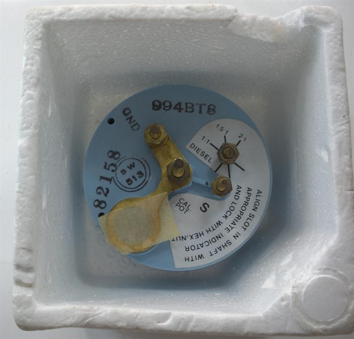

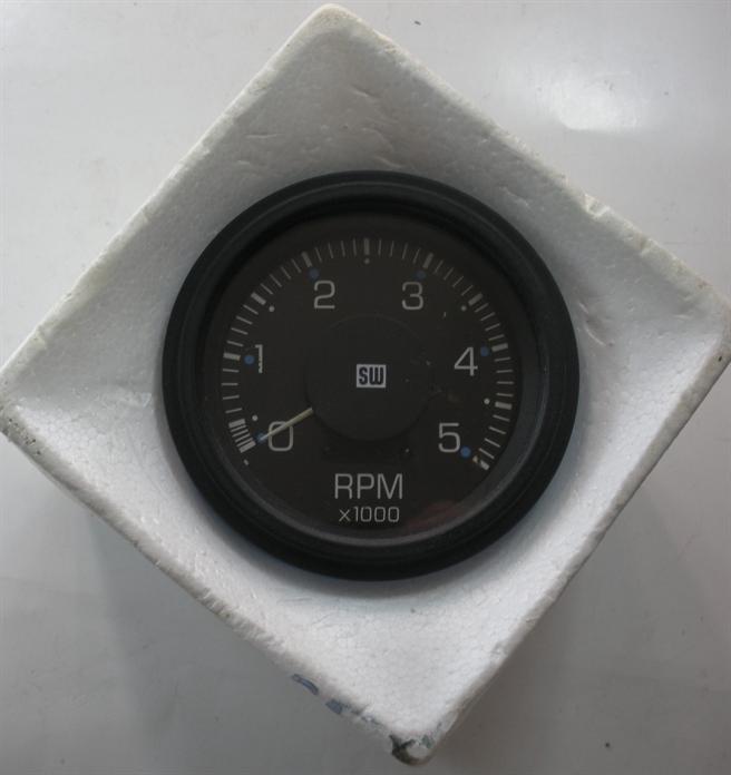

 If your truck is still set up a positive ground, some tachs were made to run positive or negative grounds.  I have a  Stewart Warner generic 4 cycle engine  #3347 tach, with a Stewart Warner # 994BT8 electrical sender. The tach can be used with gas or diesel engines. Auto Meter made on for the British Land Rovers and Jags  Positive ground a few years ago.
The wiring schematic is generic, some cars like my 55 chevy and many older Chrysler products  have a ballast resistor to cut voltage down to the coils. Do both coils connect to the distributor cap or do you have a dual ignition like many older Fire trucks as a back up system in case of failure on a call?  Can you take a photo of the coils and the distributor(s)  so we can see both the primary and secondary wires to the distributor?   Paulswtach1.jpgswtach2.jpg
