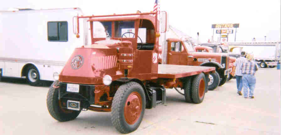

My 33 and 34 and my AC Six with their pneumatic tires and the later style AC Brakes would do it no problem. Would I do it? Nope. 35 or 40  would be no sweat on the roads in Va. where we are. The large sprocket just make it less stressful on the drive train on modern roads.

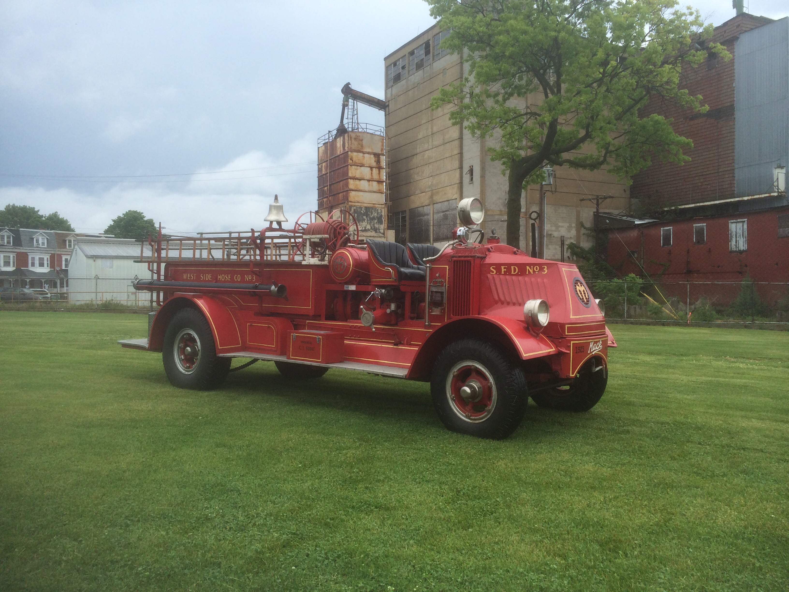

All my 30's AC and AC Six have MACK factory Vacuum Boosted assist (basically early power brakes) on the four wheel brakes. The brake on the back of the transaxle  that is lever actuated is a factory mechanical Disk brake unit. With modern composite linings , ALL the linkages rebushed and with the close side of the factory adjustments it will stop fine.
I don't plan on 50 mph but 35 or 40  with a reserve.

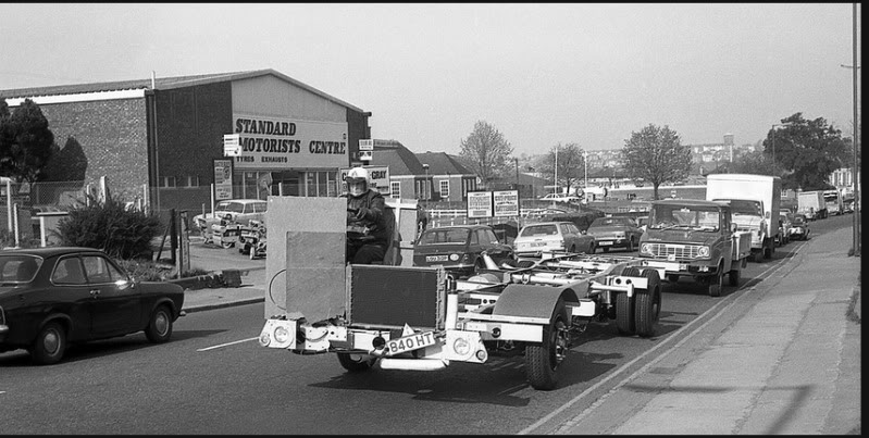

Wimps..!!!!  LOL
these guys drive a bus chassis from factory to body builders 200 miles away at 70mph... grab a cup of tea, thumb a ride back... and next day do it all again.... hardy guys, always got my respect when they passed ME on the motorway...!!!  :D
BC Mack
My grandfather delivered Model A Fords from the Chester PA plant.  How much of a vehicle he got depended on what he was delivering.  He often sat on a wooden box while delivering truck chassis.   They gave him money for the return train ride, but if he hitched a ride he could keep the money.  One time he was delivering a truck chassis in the winter.  It slid off the road nose first into a snow bank up to the windshield.  He got pulled out and continued on his way without a scratch on it.  Mike
