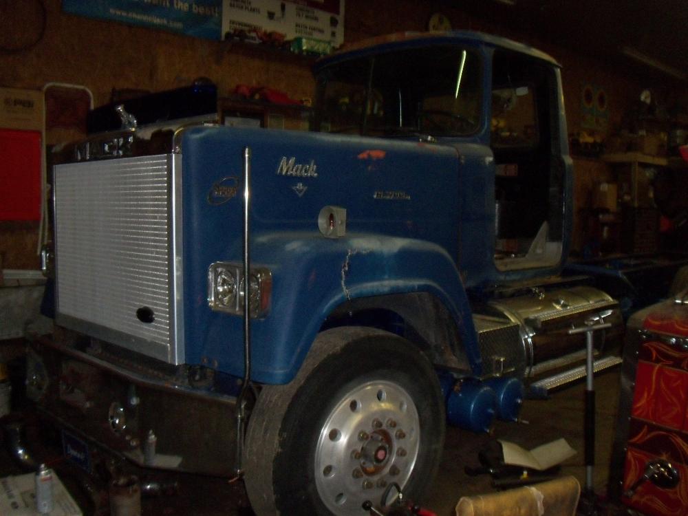

The one hooked to the lowboy was my Dads Superliner which he used to drive for A A Robbins and then R I Lampus. The block truck we used to lift the bed is still owned by Lampus. My dad is the mechanic at Lampus' plant in Cambridge Springs(AKA the old Robbins plant). He likes stuff to be well taken care of which he's passed on to My Brother and I.

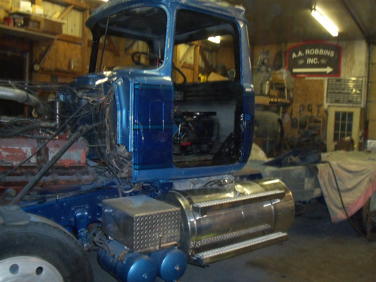

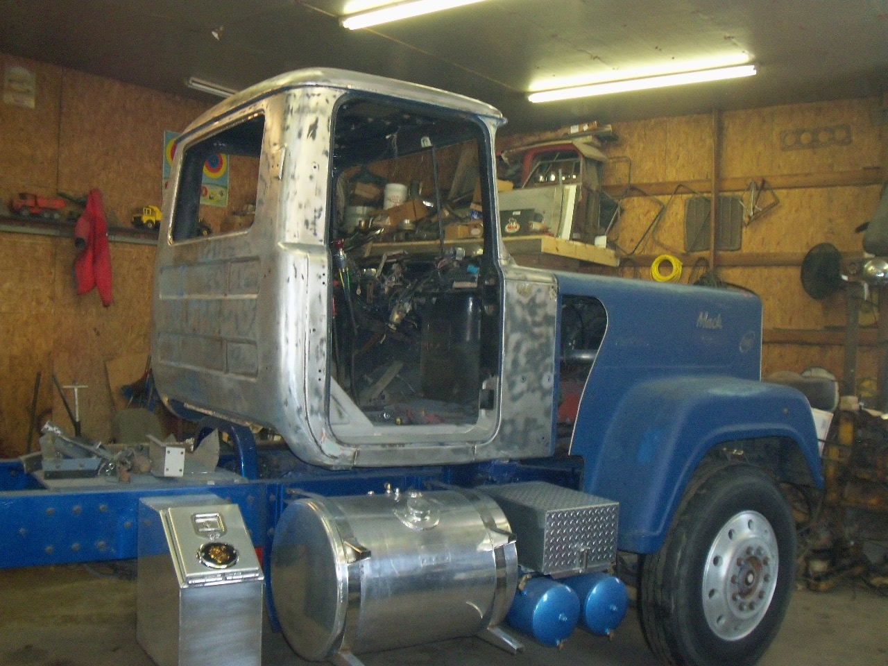

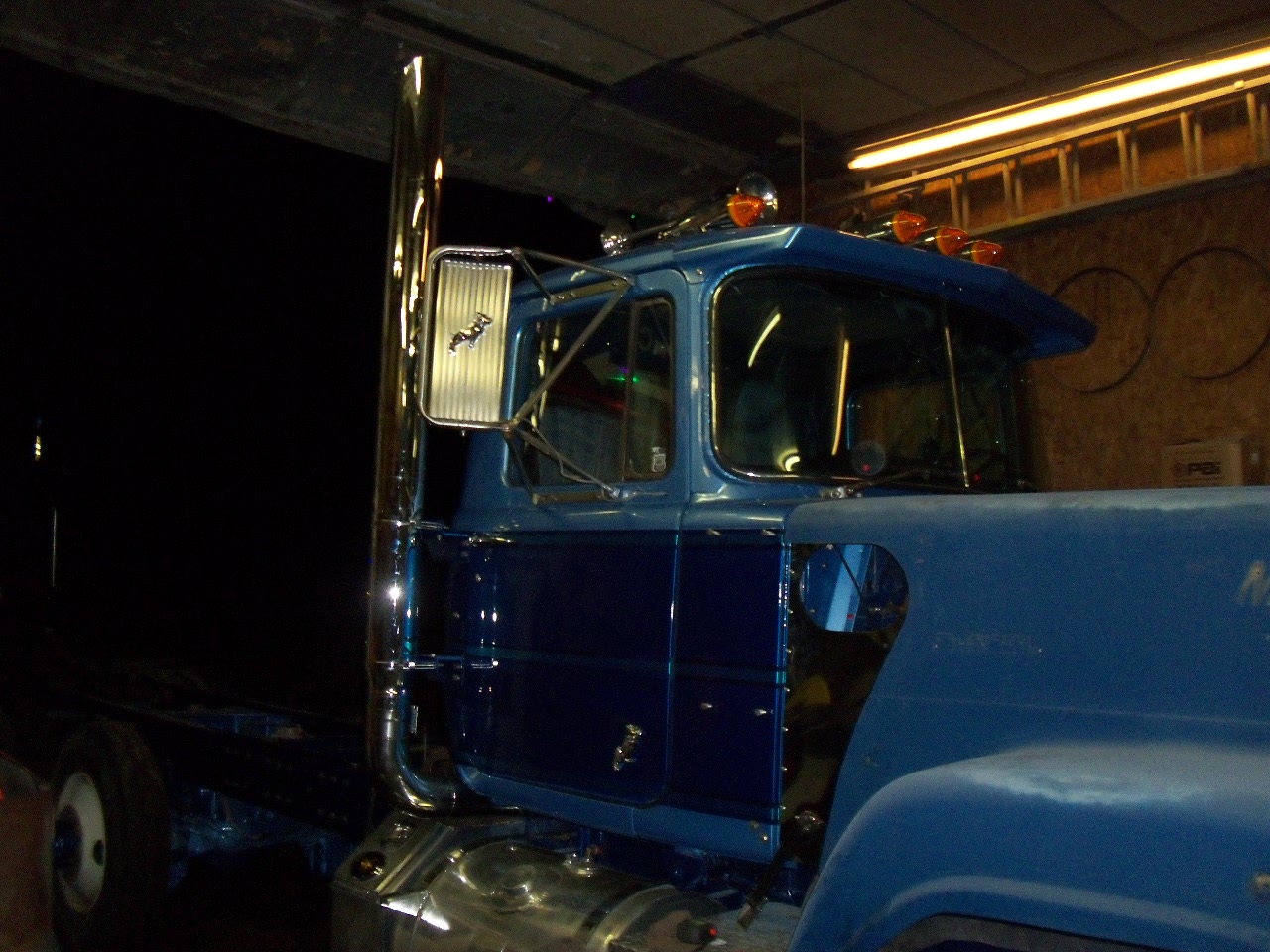

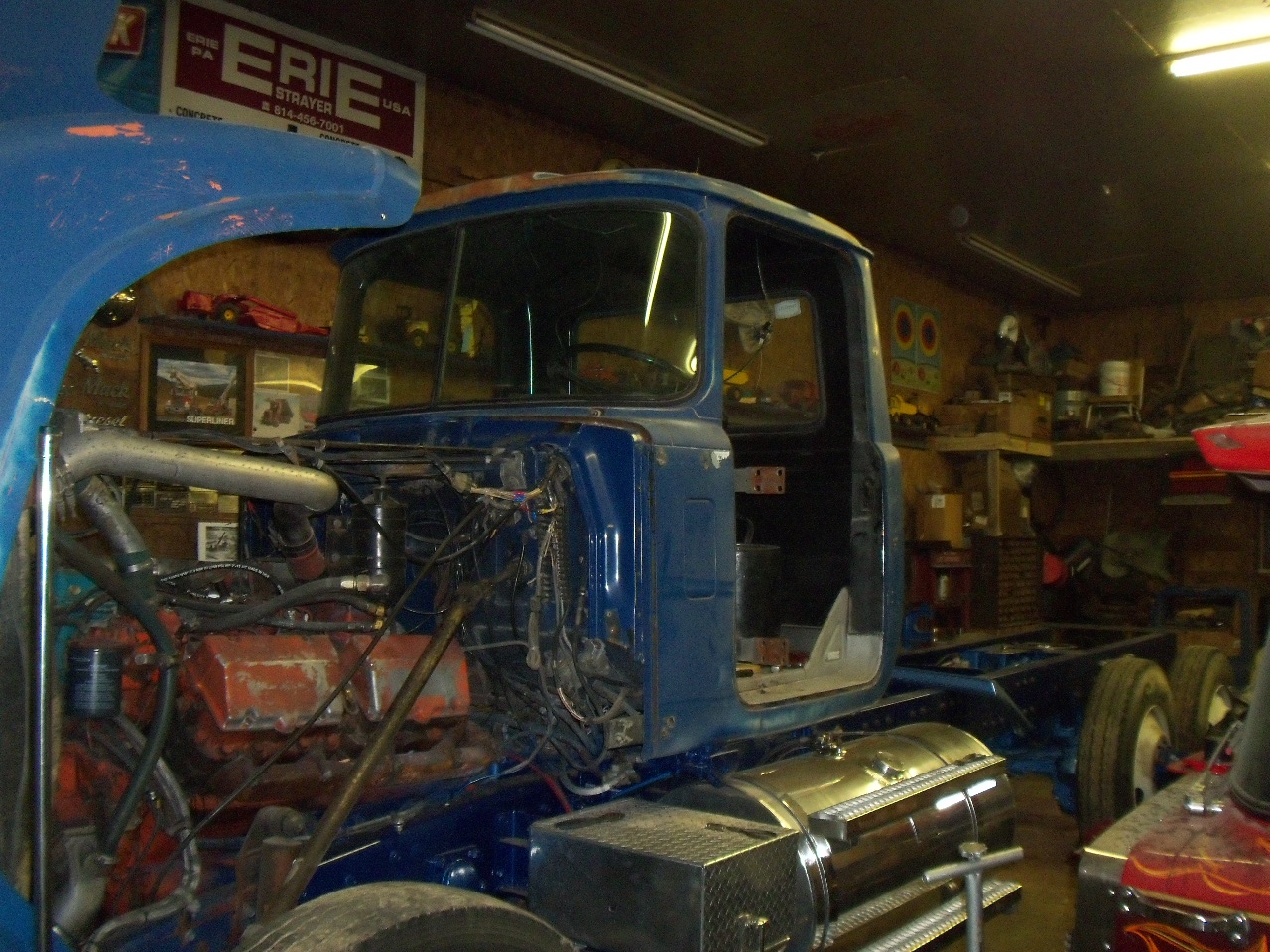

Thanks Guys. There's been a lot of late nights on this project.
2 hours ago, r686st said:
Could you give part numbers, dimensions and information on the exhaust you used?

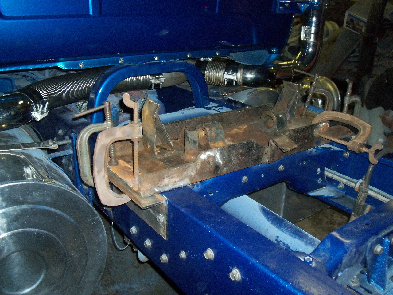

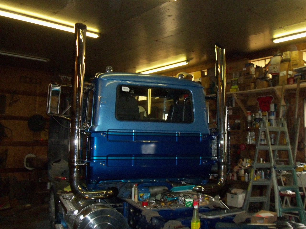

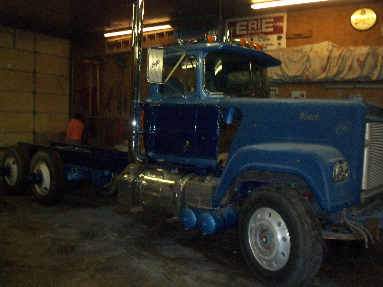

The stacks are 6 in. I got them off my cousin a few years ago and I shortened them. As far as the y pipe that was custom built by my brother Ben out of 5 in. stainless with a divider so it smokes evenly. He's one hell of a welder. I didn't get that gift in life but he sure did. The elbows are ones that we've kept off Superliners that we robbed parts from etc. I cut them to fit because we moved the stacks forward to make more room to fit the dump bed. I think elbows and Y pipes off a W900 KW wound have worked but there not stainless and I had every thing here to do it.

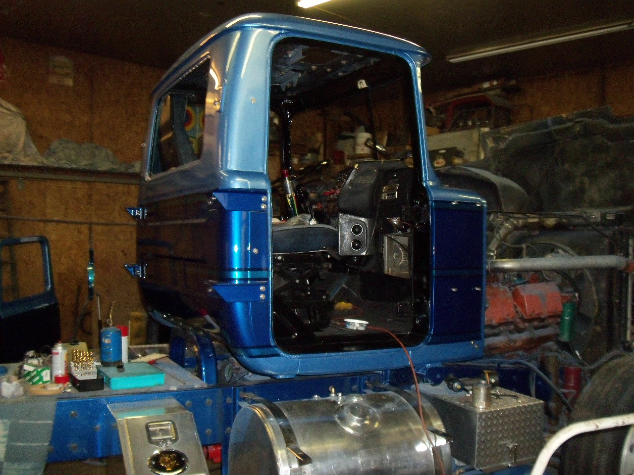

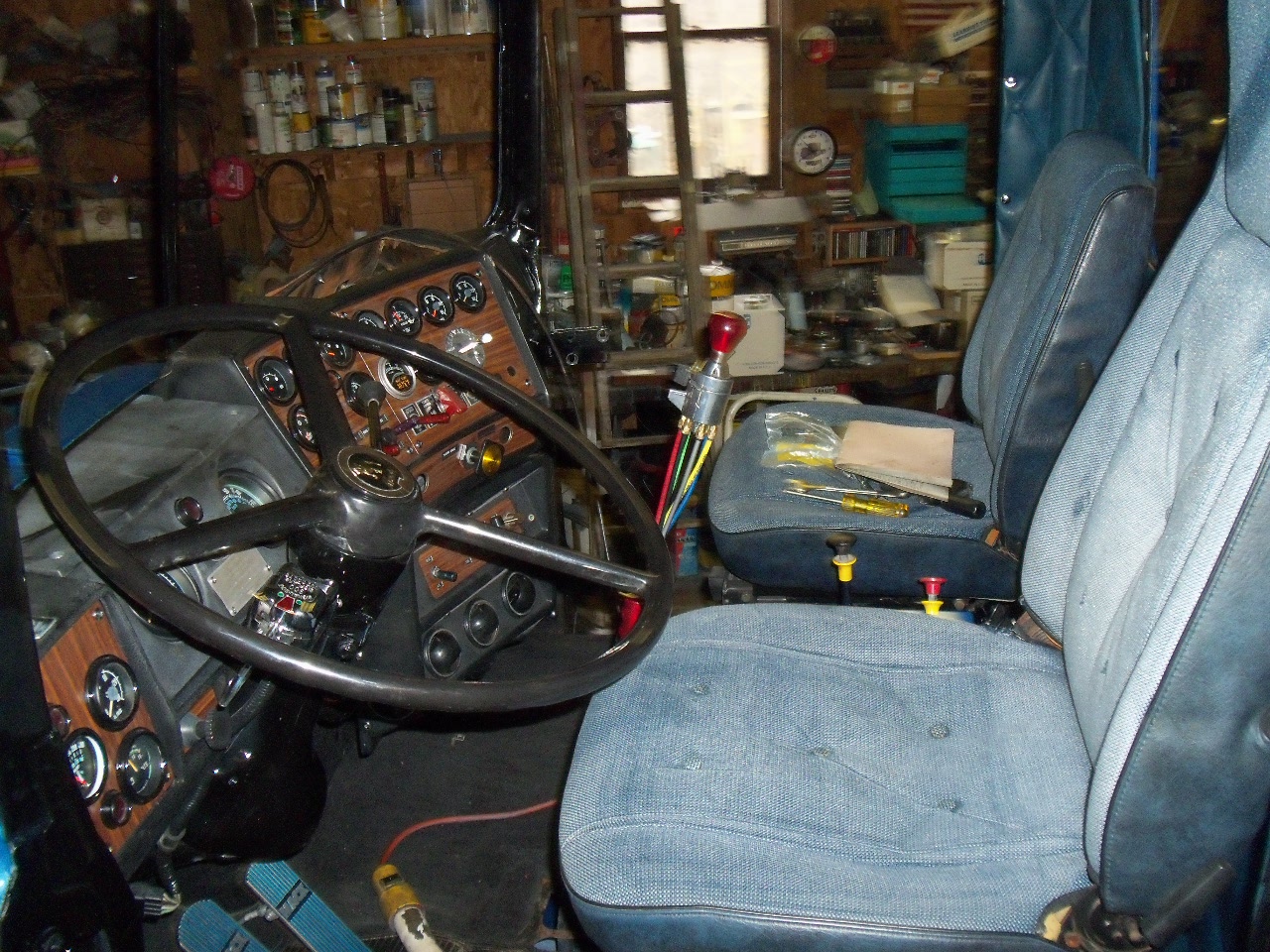

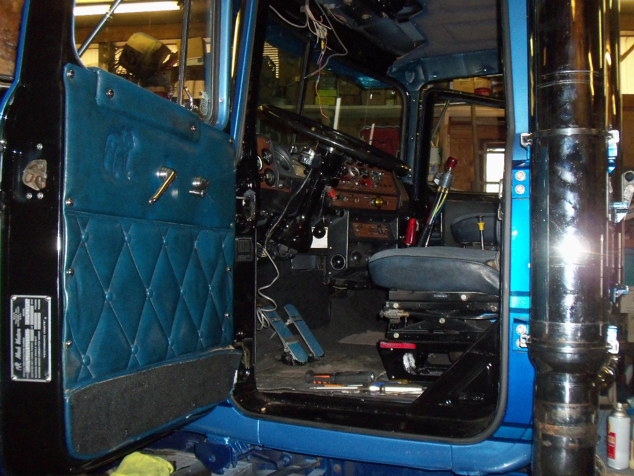

That cab... and that interior... came out AMAZING!  Can't wait to see the rest.  Hope you hang a stock air cleaner on it.  Totally takes me back to my childhood when you saw dolled-up Superliners like this running around.
Thanks Guy! Yes I put on a stock air cleaner on it. I'm going for the sharp old school look like you would have seen back in the 80's. That's kind of how I pretty much plan all my truck projects.
