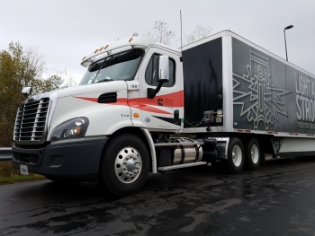

EAST LIBERTY, OH -- Cummins' new X12 engine is slated to hit the street sometime early this year, probably shortly after its formal launch in February or March. The engine was introduced in August 2016 and I had a short drive with it then around the 11-kilometer track at the Transportation Research Center in East Liberty, Ohio. It wasn't much of an opportunity to get to know the engine, but it whet my appetite. Cummins invited me to drive the new X12 this past November on a longer real-world route, starting from the plant in Jamestown, New York, where the X12 is to be built.

For this test drive in a van trailer grossing 61,100 pounds, I ran about 150 kilometers on a nice mix of interstate, and flat and hilly two lane roads. I headed west on I-86 from the plant in Lakewood, New York, to North East, Pennsylvania, where I flipped back east on I-90. I got onto New York State Route 5 at Ripley, New York,, headed east to Westfield, and then back south to the plant on State Route 394 and 430. It's a great route to test an engine like this because it's exactly the kind of terrain on which it will operate in real life.
The engine was installed in a Freightliner Cascadia daycab with a manual transmission. I opted for the manual because it gave me a better feel for what the engine could do, unaffected by an automated transmission with ideas of its own. It was a 10-speed Eaton manual with a 0.78:1 OD ratio, 3.58:1 rears and 11R22.5 tires -- a typical spec’ for a regional or pickup-and-delivery operation.
