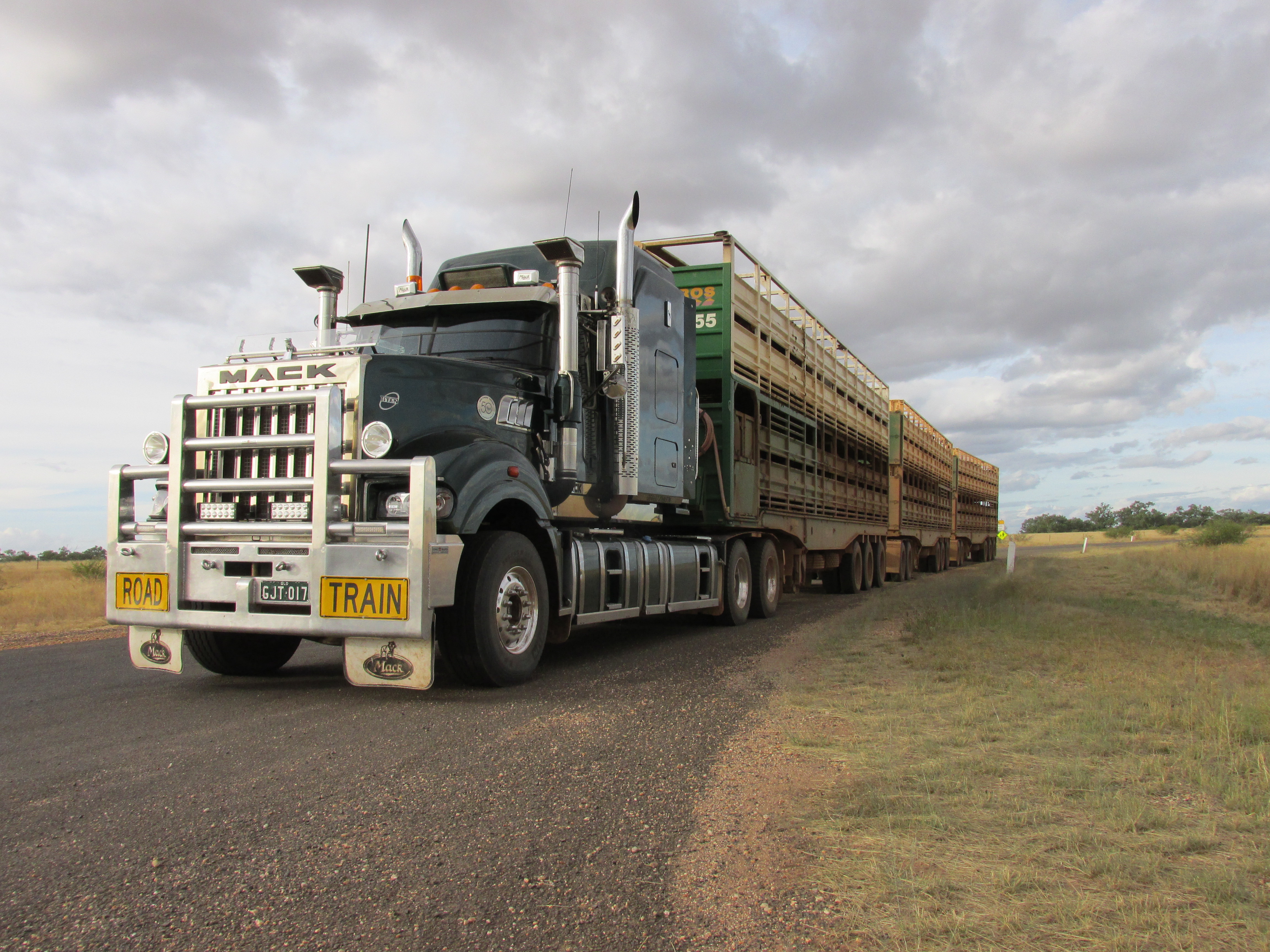

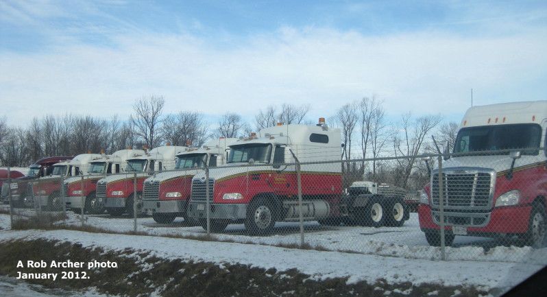

http://img.photobucket.com/albums/v284/bluejaysfan/Freight%20Hauler%20Fleets%20-/ACTIVE%20TRANSPORT/activetransporttractorline1-22-12.jpg~original
