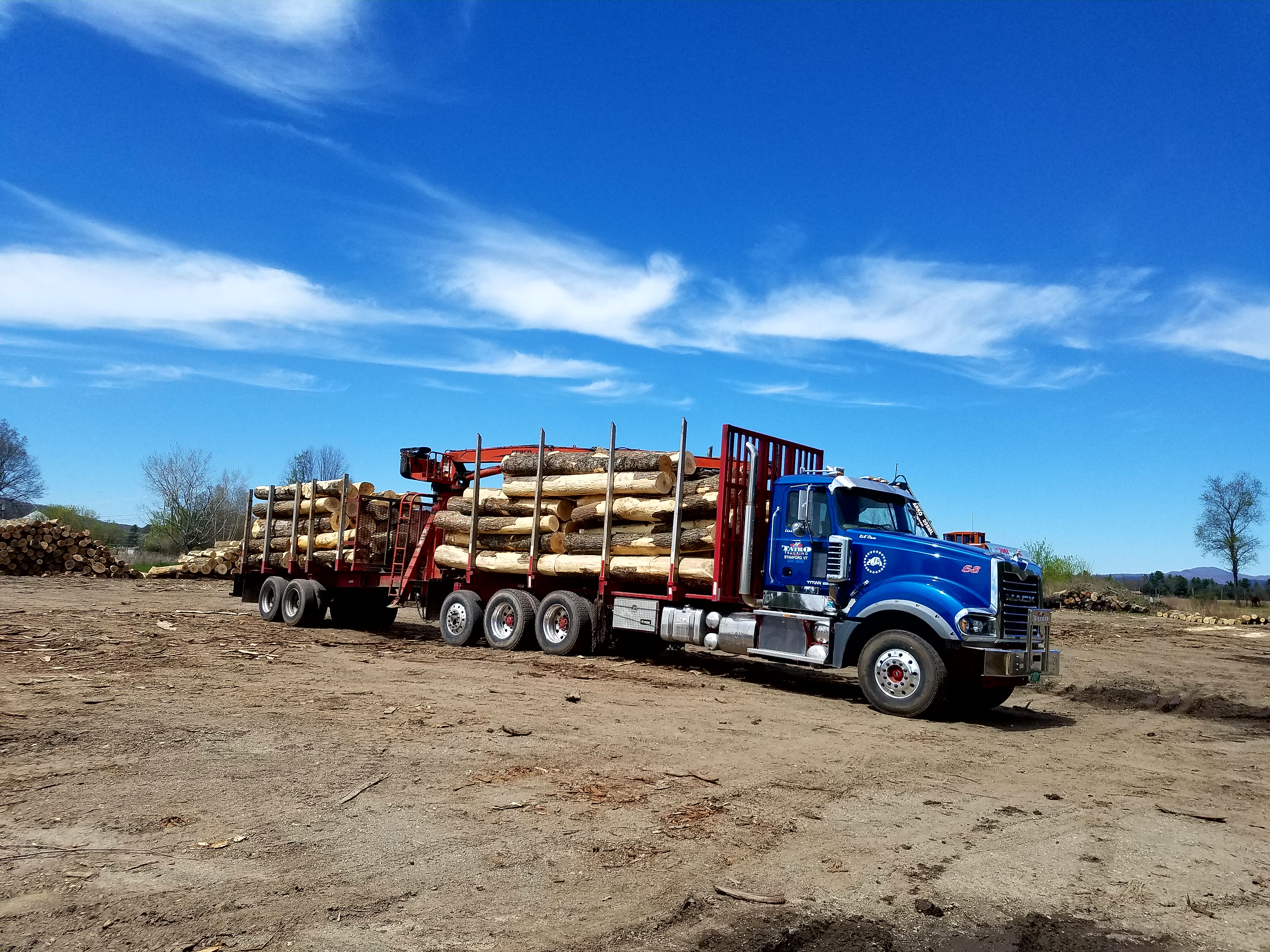

For us the titans are efficient as anything else. All the other loggers in our area run ether western star with dd16 or kenworth with Cummins isx 15 . We ran mack e7 engines for years they did the job but on steep hill starts in the woods they didn't have enough power and the engine break sucked . For us the 16 liter engine works better
