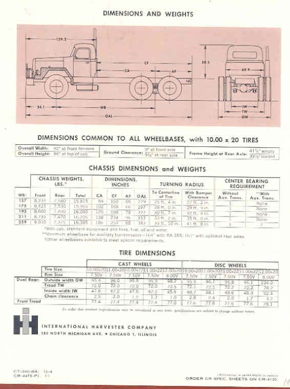

Wow, thanks alot.  That is very cool, I couldn't find  alot of info on them.  You don't happen to have the same brochure for an F210D?  Maybe I could compare the info on the two, and it would answer some of my questions.  Andy

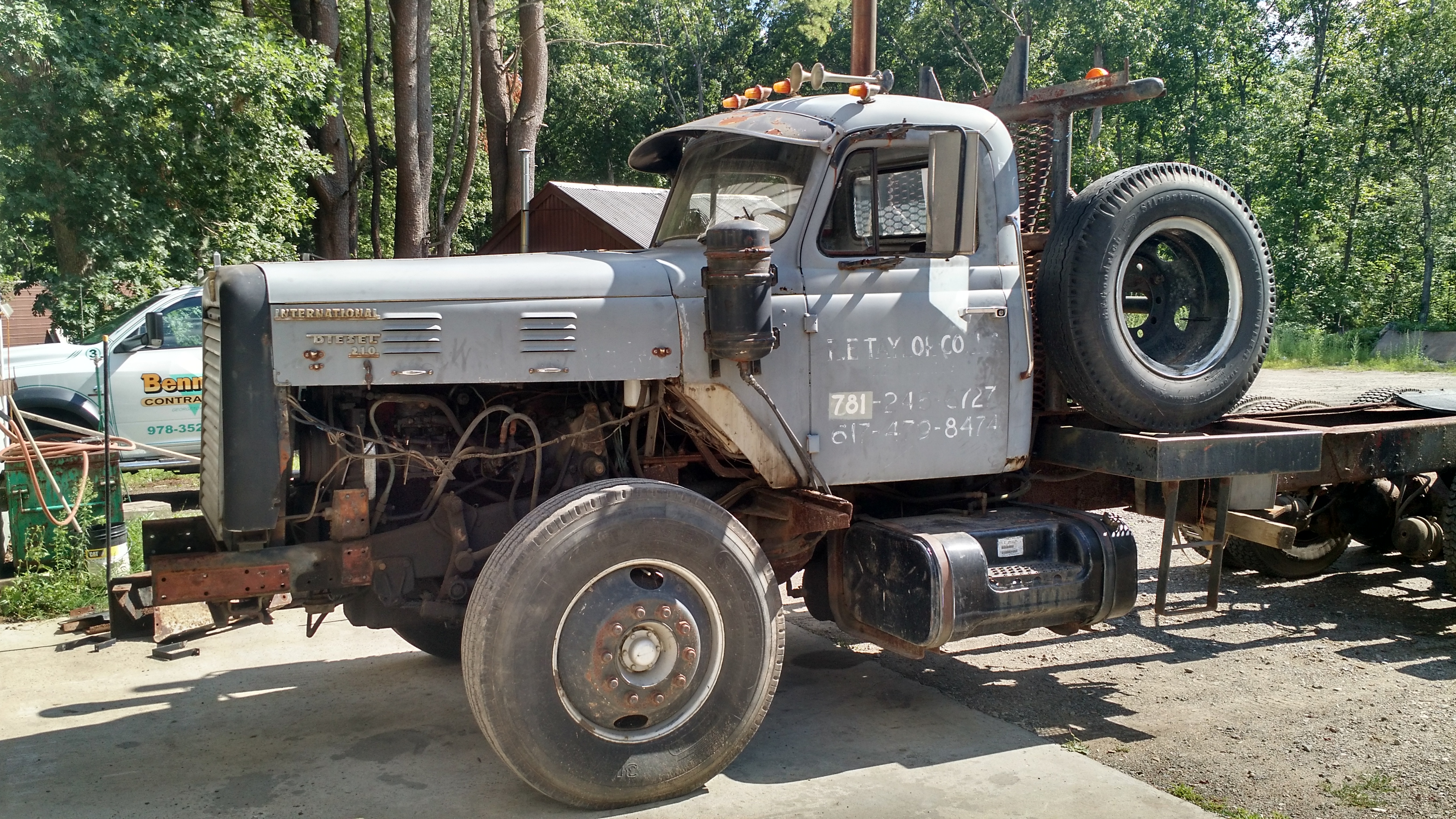

Thanks for the info, I was able to talk to Ron, and he is a very nice guy and gave me some good info and much needed encouragement.  He has a guy that can repop the fenders, so that is a relief for me.  He also said he had the same sort of frame issues with his truck.  I would love to not have to fix the frame, but to me I need to fix it before doing anything to this truck.  I looked it over again this weekend and after my researching frame repair I think I have the most economical solution in mind.  My plan is to move the rear axles forward roughly 3 feet, splice in new inner rails in from about a foot under the cab and splice new outer rails in about 4 feet behind the inner splice.  I sent some info to PG Adams, and waiting for a quote.  I also have a line on a used mag drill for short money, I'm hoping to check that out tomorrow.
As I was looking more closely at the truck I found that it was originally a tractor and the wheelbase was as you see it in the pictures.  On the VIN tag it is listed as having a 270" WB, and it was most definitely a tractor.  The frame was stretched, but the splice is right behind the rear axles.  Andy

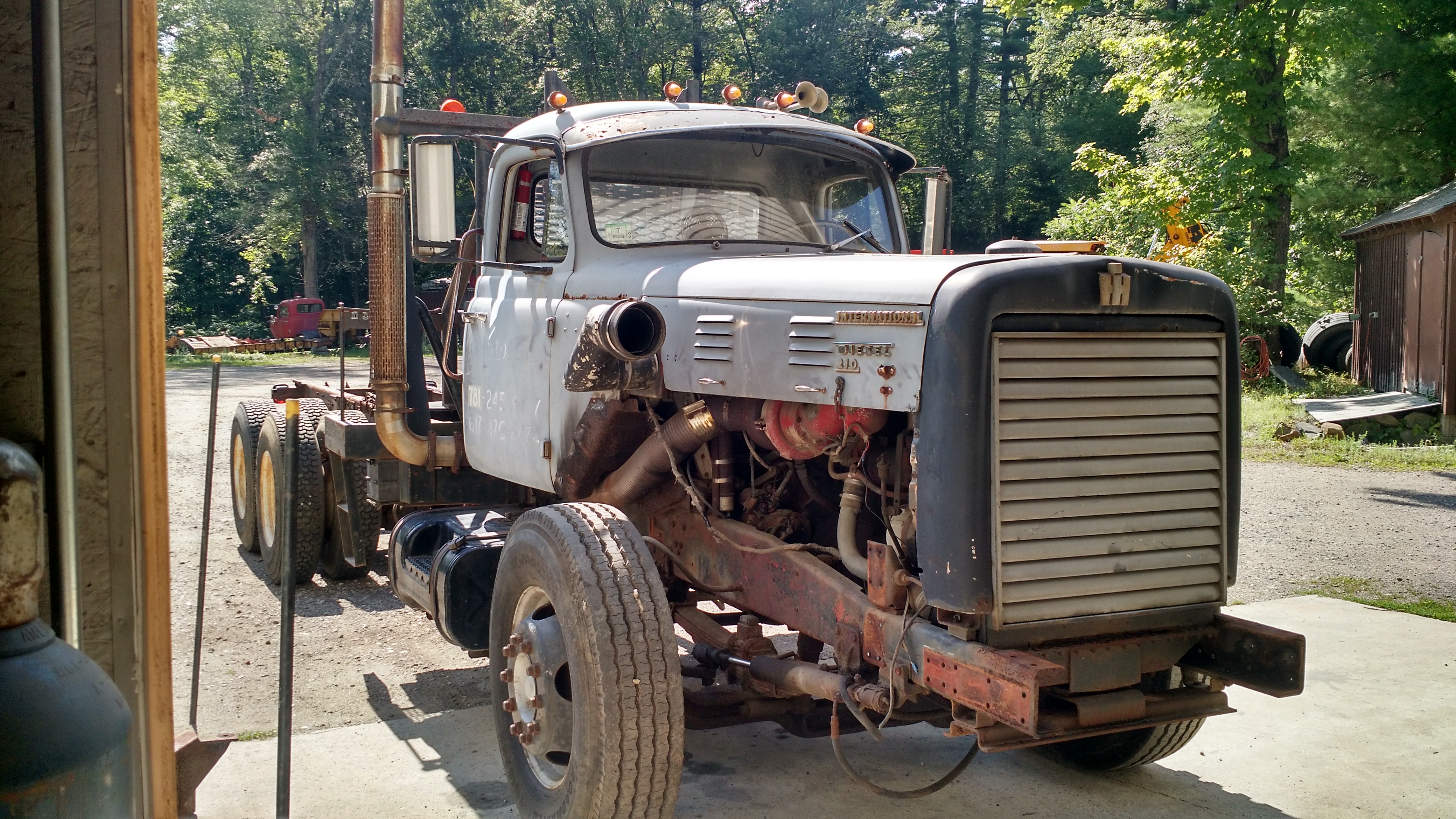

Got a little done, it was hot and mostly all torch work.  I wanted to get the winch off, but being as busy as it is there wasn't a machine in the yard to pick it off.  Instead, I focused on the front of the truck.  I'm hoping to get the winch off during the week sometime, then maybe pull the DS rail on Sunday.  There is a huge lifting eye on the engine, I'm hoping I can rig up a gantry of some sort to support the engine from there.  Cribbing it likley won't be easy.
I realized I made a mistake, the WB is 217" on the truck currently, and that is what the VIN data plate reflects.  I think I'm gonna leave the WB it's current length.  Another interesting thing is that it appears the frame was originally red and the cab and fenders were white.  I think I want to leave it grey and black though.
