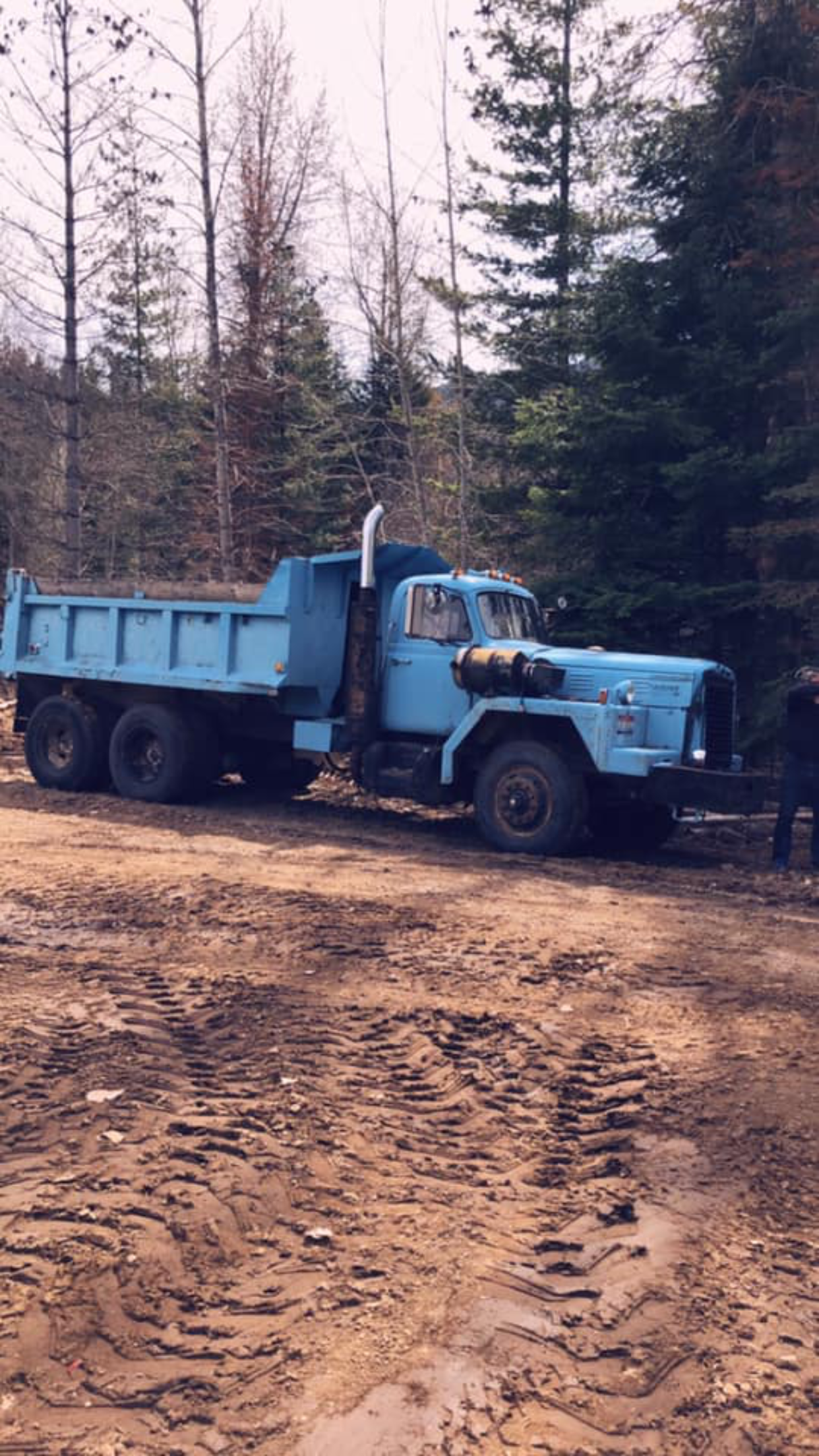

I'll get more pics soon. My truck is a 250 cummins, 5 and 2 speed, 54k gvw. The dump box is definitely a newer addition, they hacked the rear frame rails. I wonder if it was the same wheelbase as yours originally. My truck is solid without rust. It needs tlc but it runs and drives and dumps as is. The paint is pretty poor when you're up close. I'd like to clean it up a bit.
