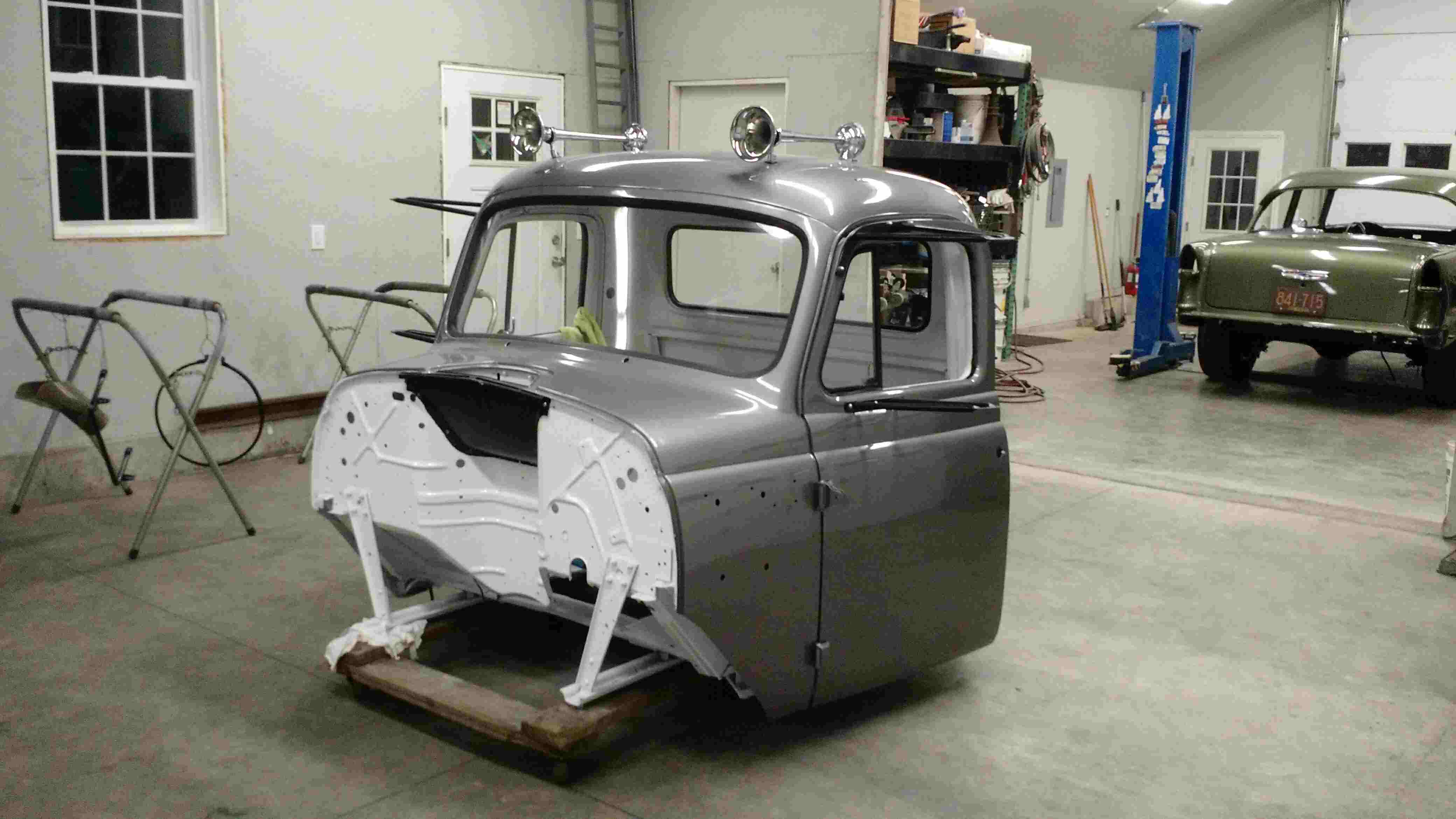

Cab looks great!  What are you doing with wiring new or reusing the original?  Paul
It's definitely a bummer when places like that go out of business, it gets harder and harder to find quality craftsmanship with limited options.  I got an American autowire universal kit for the truck, I'm impressed with it although I haven't installed it yet.  I put a painless kit in my AMX and it was ok, but it was expensive and to me not as well engineered.  Andy
