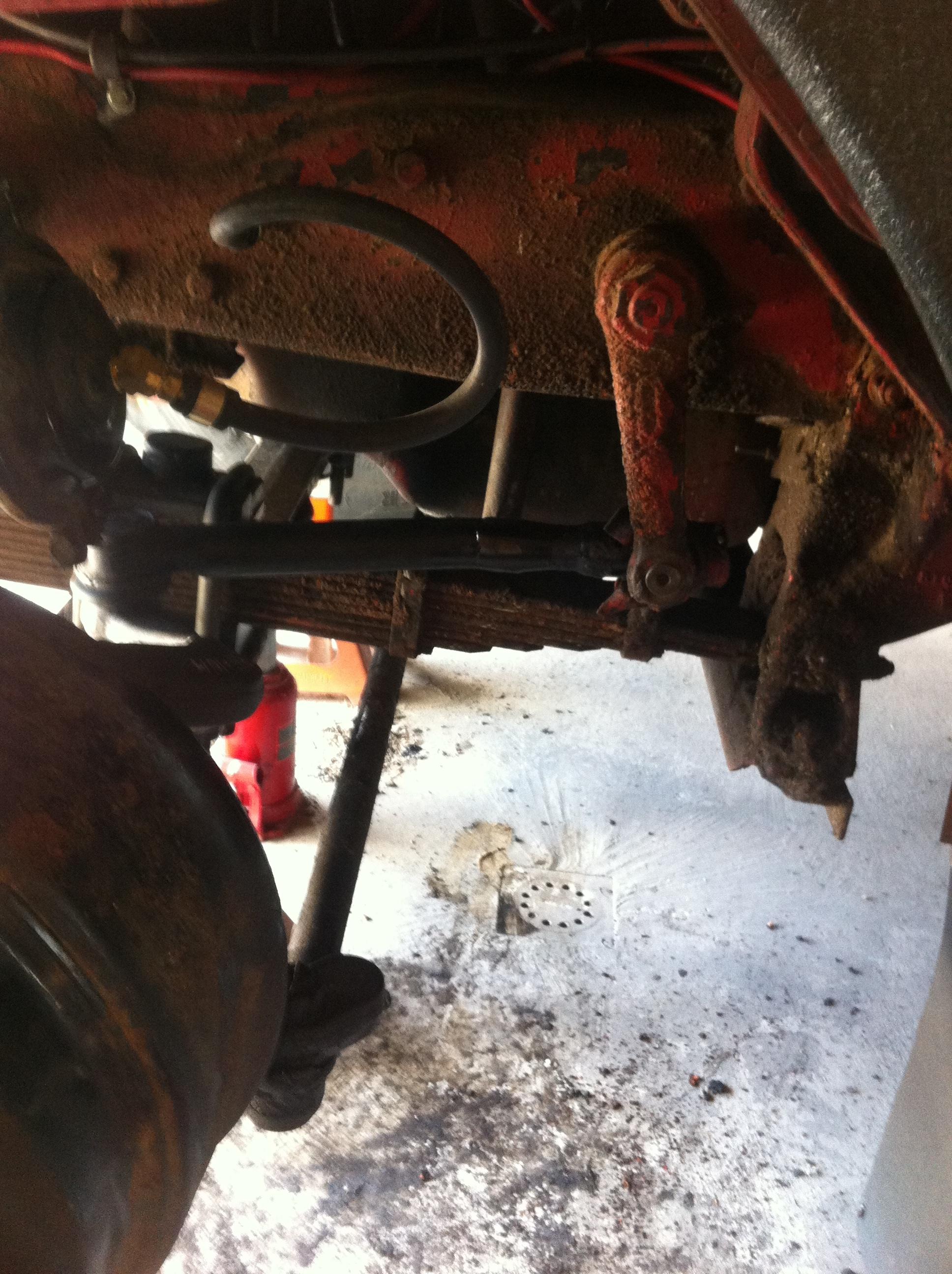

I have seen that mod. done on the draglink on many trucks. If it is done right the repair is just as good as the original part. I have done that more than once and I thought little about it. As far as the dot half of them wouldn't know what to look at and the other half would be to busy checking that your license plate light is working. Hobert I like what your doing to that truck now you need to add powersteering .

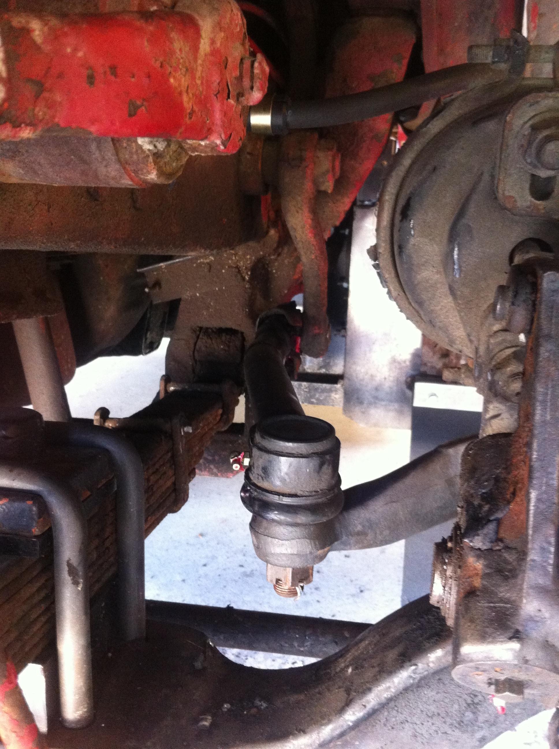

Here's the finished drag link.  I'm happy with results.   New steering arm raised everything inline and the drag link from the sterling I got the new brakes from had the perfect bend. All I did was shorten it and put the mack end on to fit pitman arm.  image.thumb.jpg.548f2b38033c55450d750d462ab5665e.jpgimage.thumb.jpg.79fbd3272d7667d9a654ab8b964fbba5.jpgimage.thumb.jpg.50583a0415cf5e065fffa032b4c1a97f.jpg

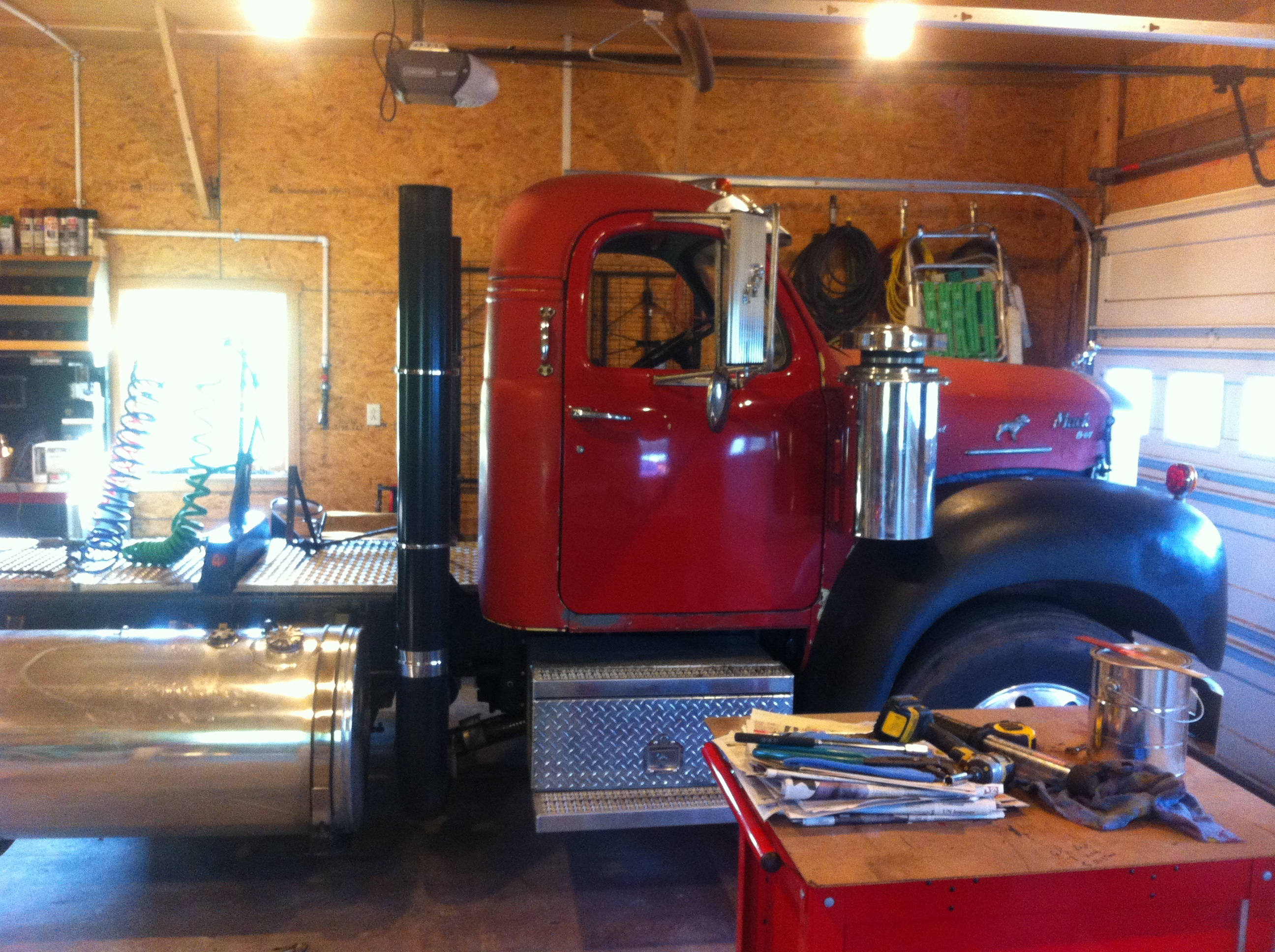

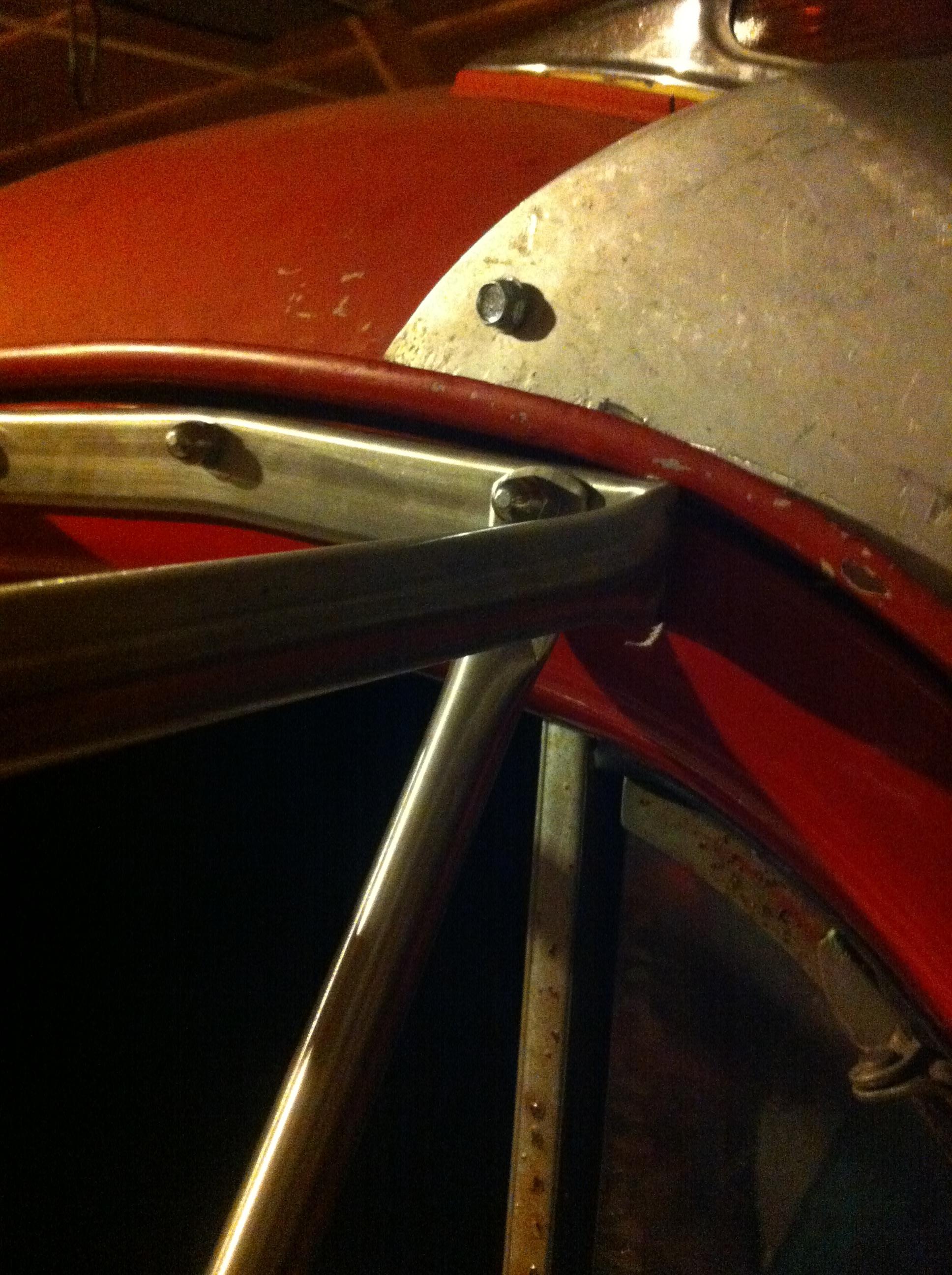

image.thumb.jpg.ee425143bf5f06fb784041508659b49d.jpgI mixed some rustoluem to try and match the old red paint and got pretty close.    I put Watt's stainless mirror brackets on and they fit close but hit the rain gutter on passenger side.
image.thumb.jpg.62eb92046a105e3ba0728ca1d85ad635.jpgim going to have to open some holes up in the top of the door and I should be able to adjust it.

Red looks real close, dang near perfect!  Paul
Hobert that insurance is really reasonable, but you gotta break your wife of drinking that yuppie coffee!😁I noticed that some rust oleum paint cans recommend acetone as a thinner, some don't,I've only sprayed it once( on a garden tractor) with acetone worked fine! Maybe ordinary reducer dilutes the fish oil base?

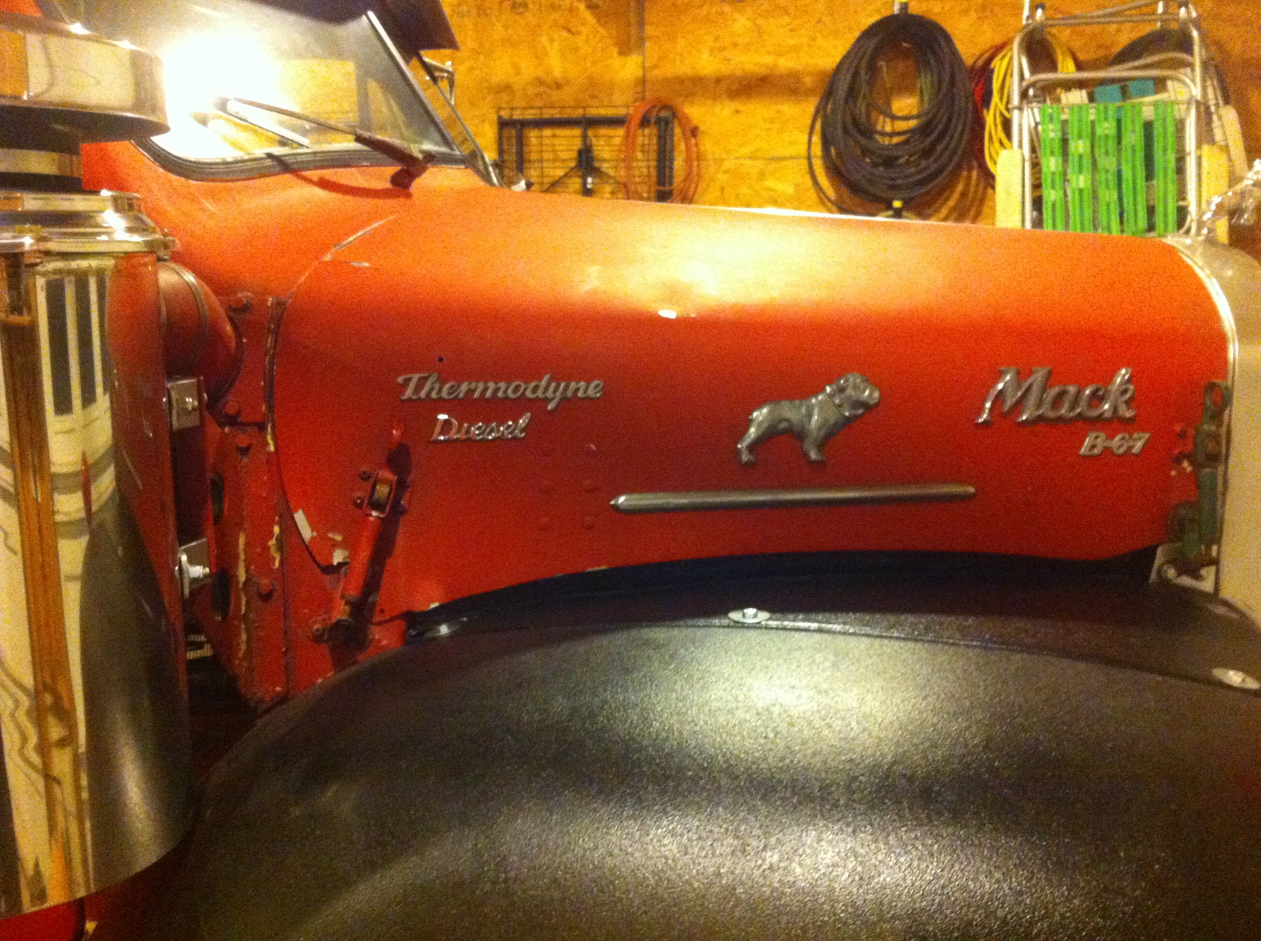

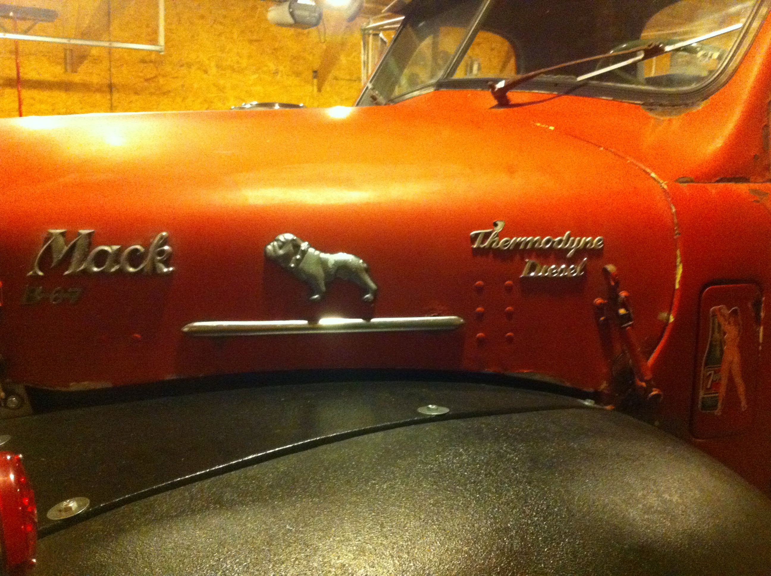

Took truck to a local fire company's car show on Sunday.     Long story short a guy gave me a set of thermodyne emblems.    Now I think I have all emblems on my hood, but on both sides there is 1 extra hole above thermodyne.   Any idea what goes there?
