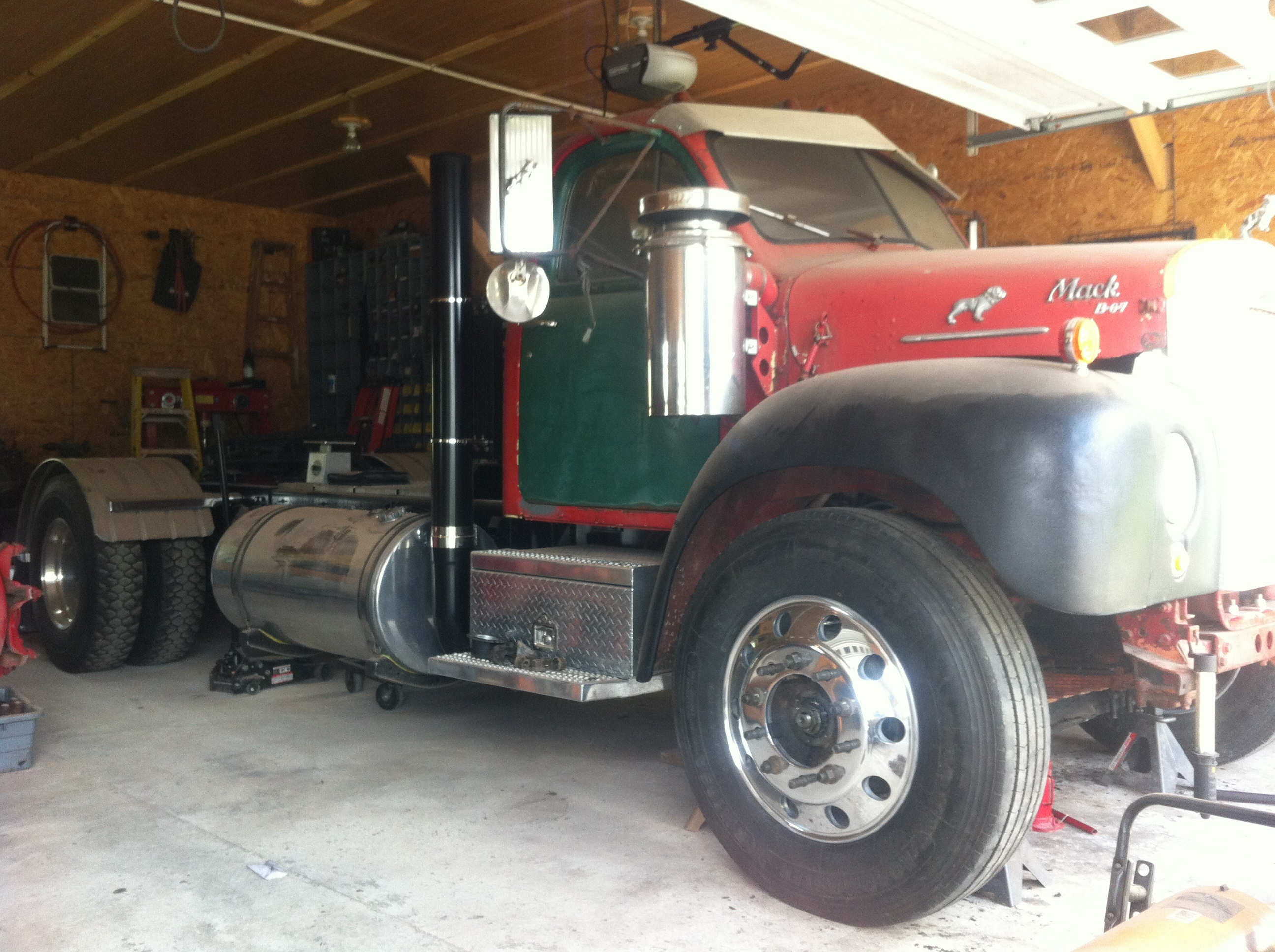

Finally time to start assembly.

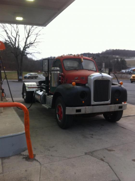

17 hours ago, 57 bcr said:
Out of likes, Hobert! She's looking great! Got to be fun to drive with a wheelbase like that,I mean "smooth" fun!  Al
Thanks,     Goes down the road really nice and straight.   Guess my tape measure held out when I put it back together.    According to GPS tops out at 62.7 mph @ 2100.  A little tighter steering cut would be nice though.

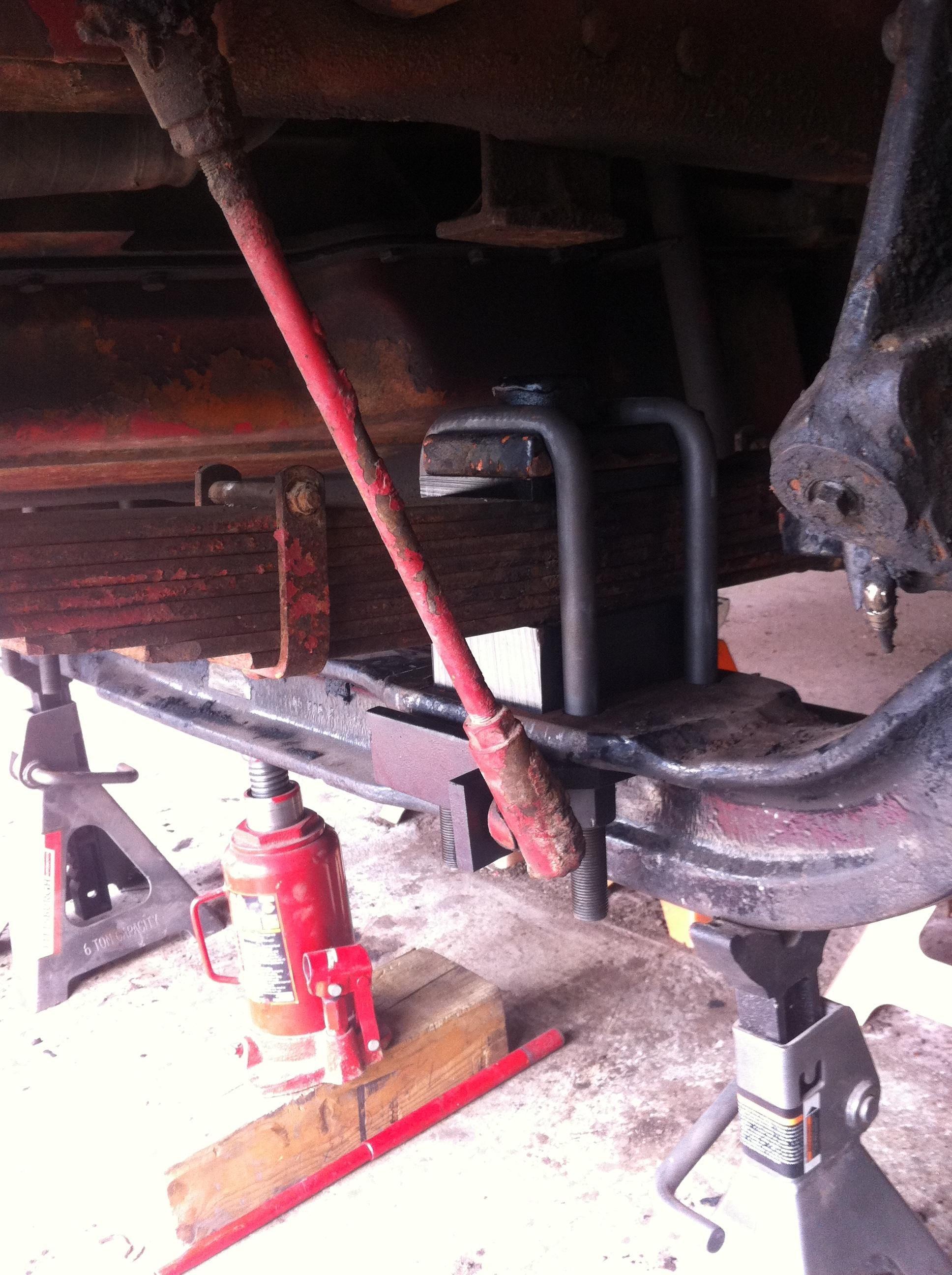

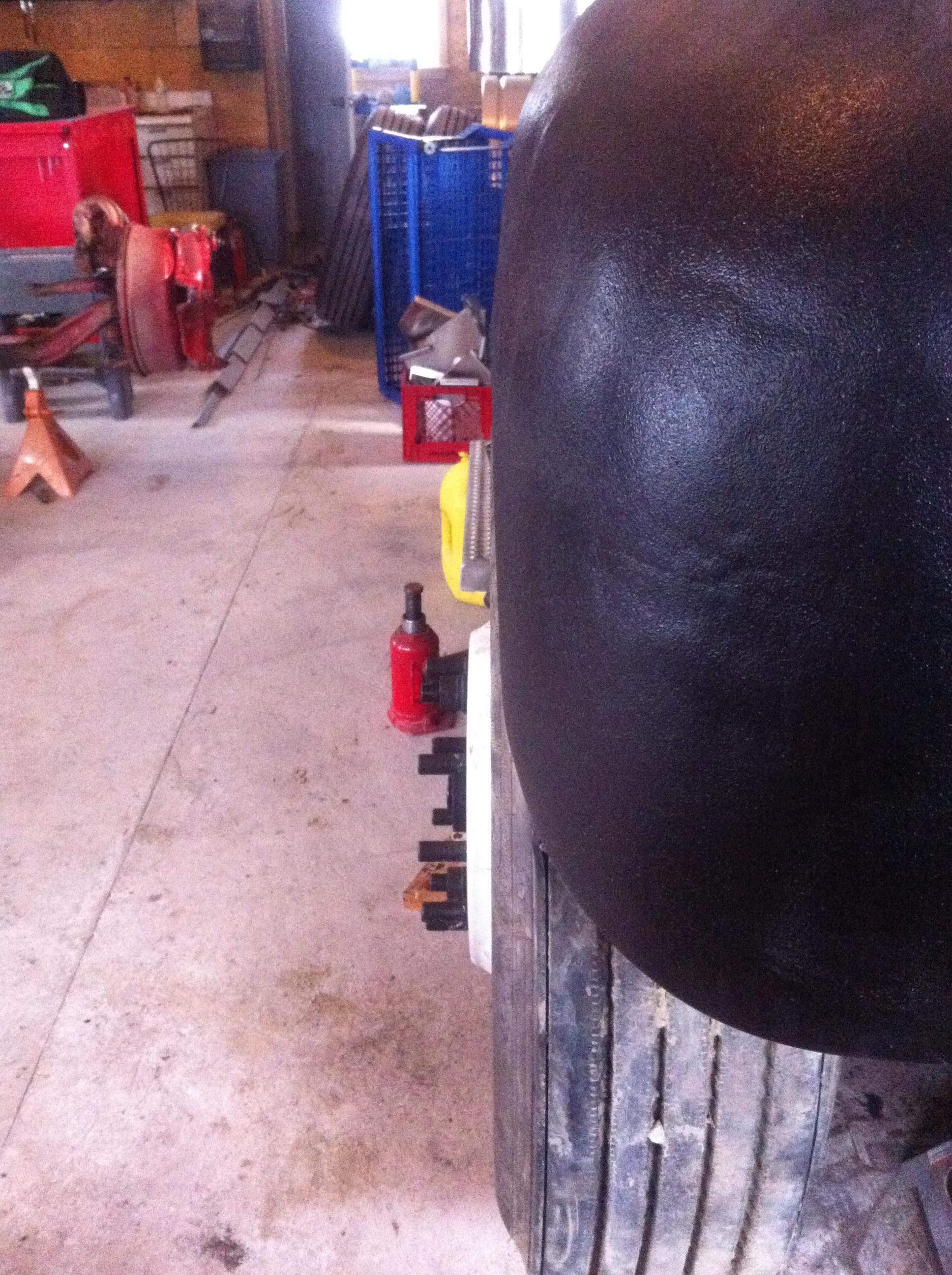

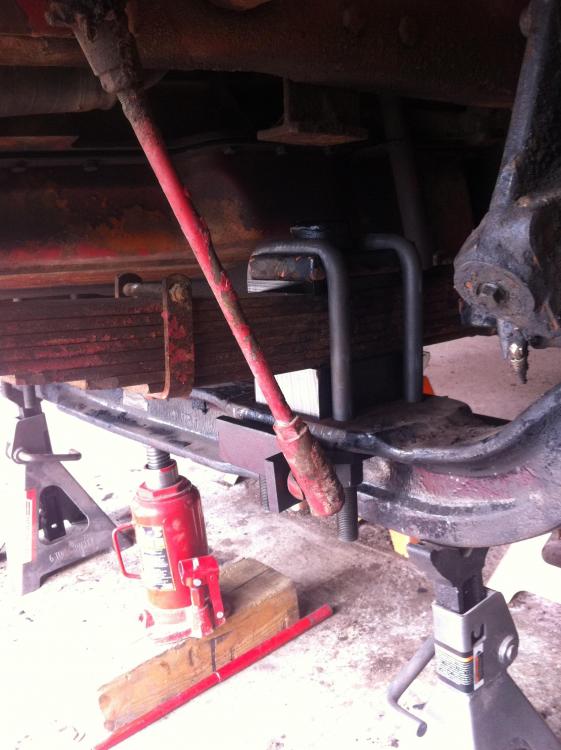

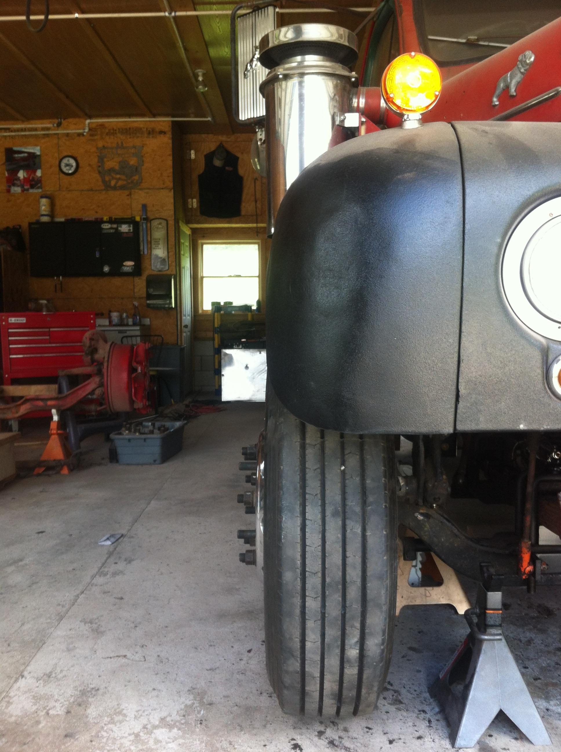

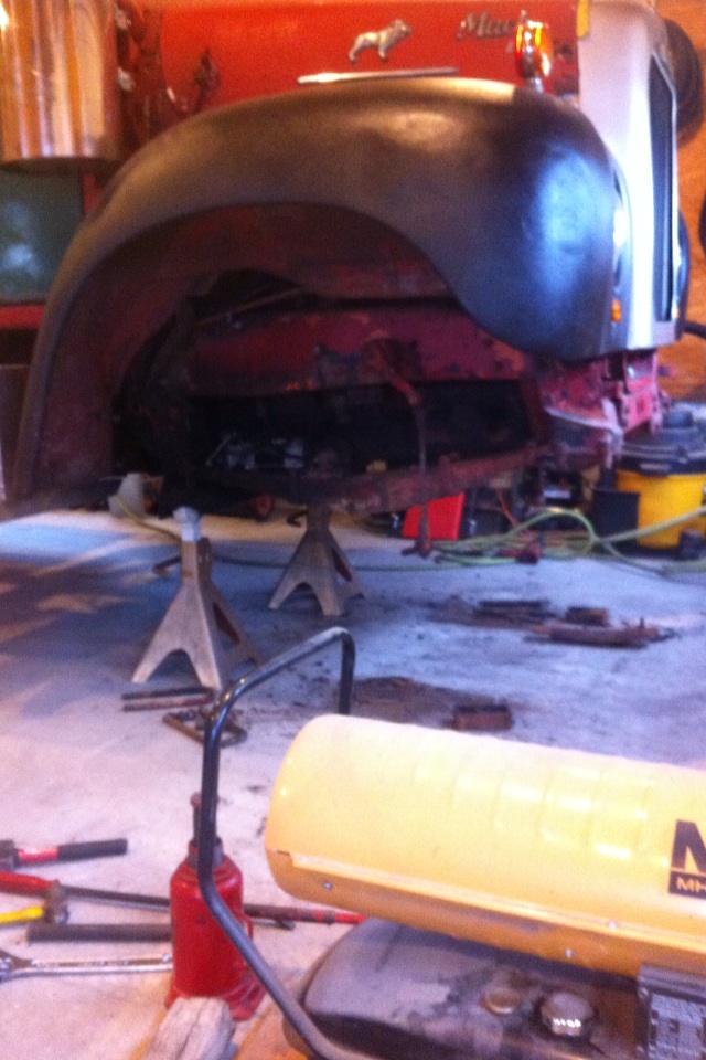

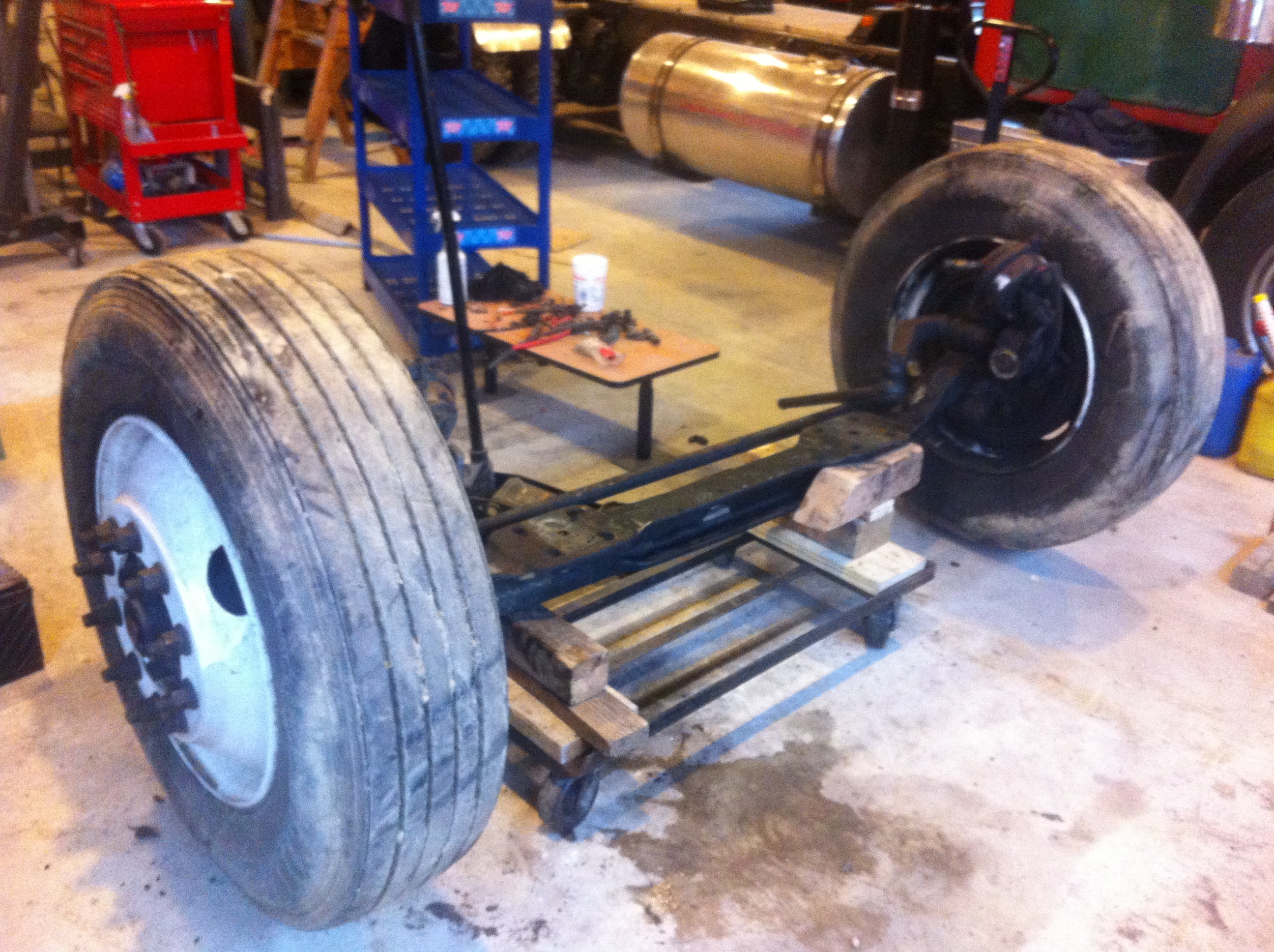

image.jpgfound a front rockwell axle from a fld freightliner.  It has the same center pin distance. It is going to move the tires out 2" further on each side (mine stick in the fender 4" currently".       I should be able to lower the front an 1" or 2".    For $100 it's worth a shot.
Truck is a beauty.  Just out of curiosity-what is motivation for this?   Yeah-old spokes forever guy:rolleyes:

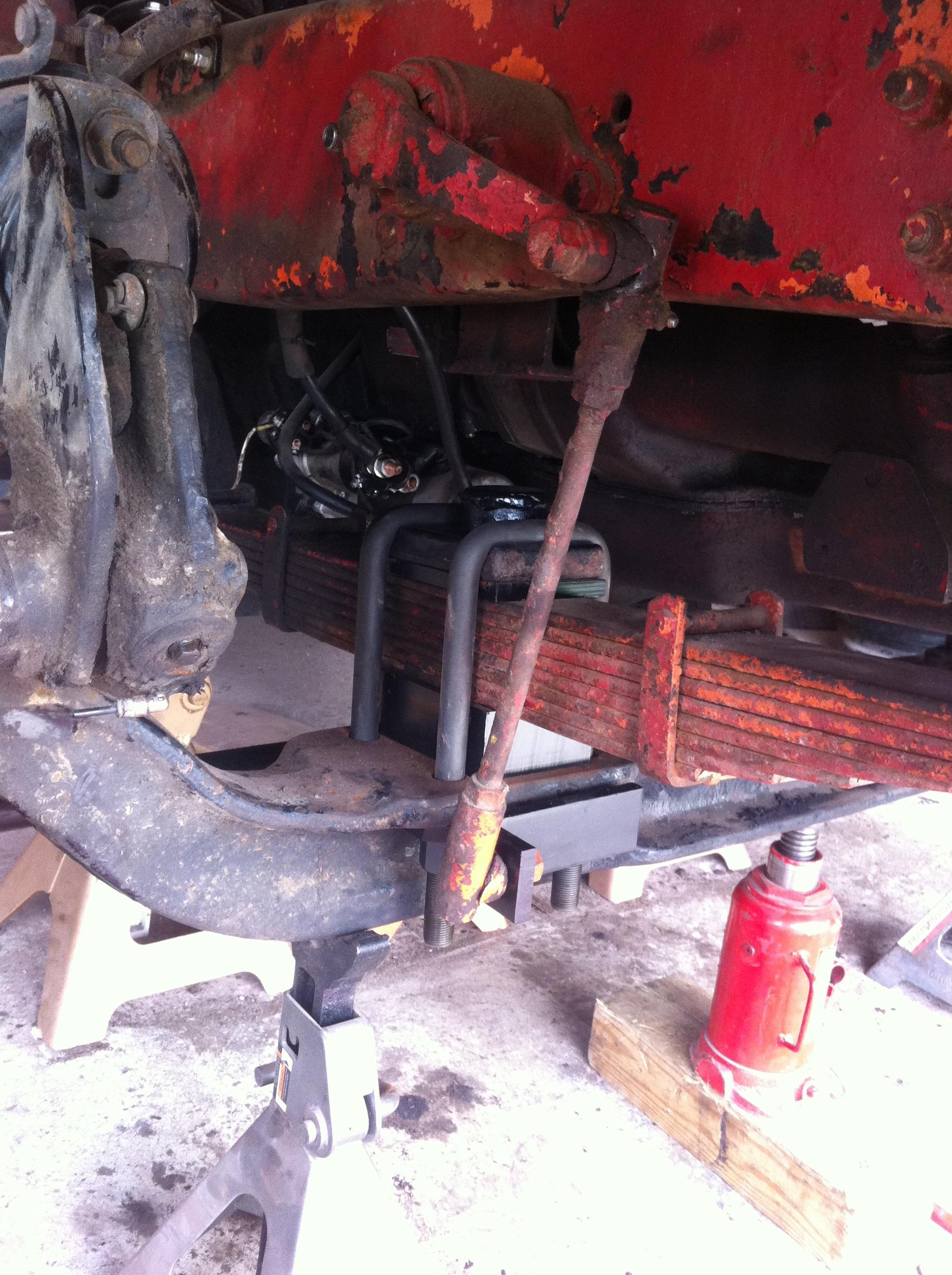

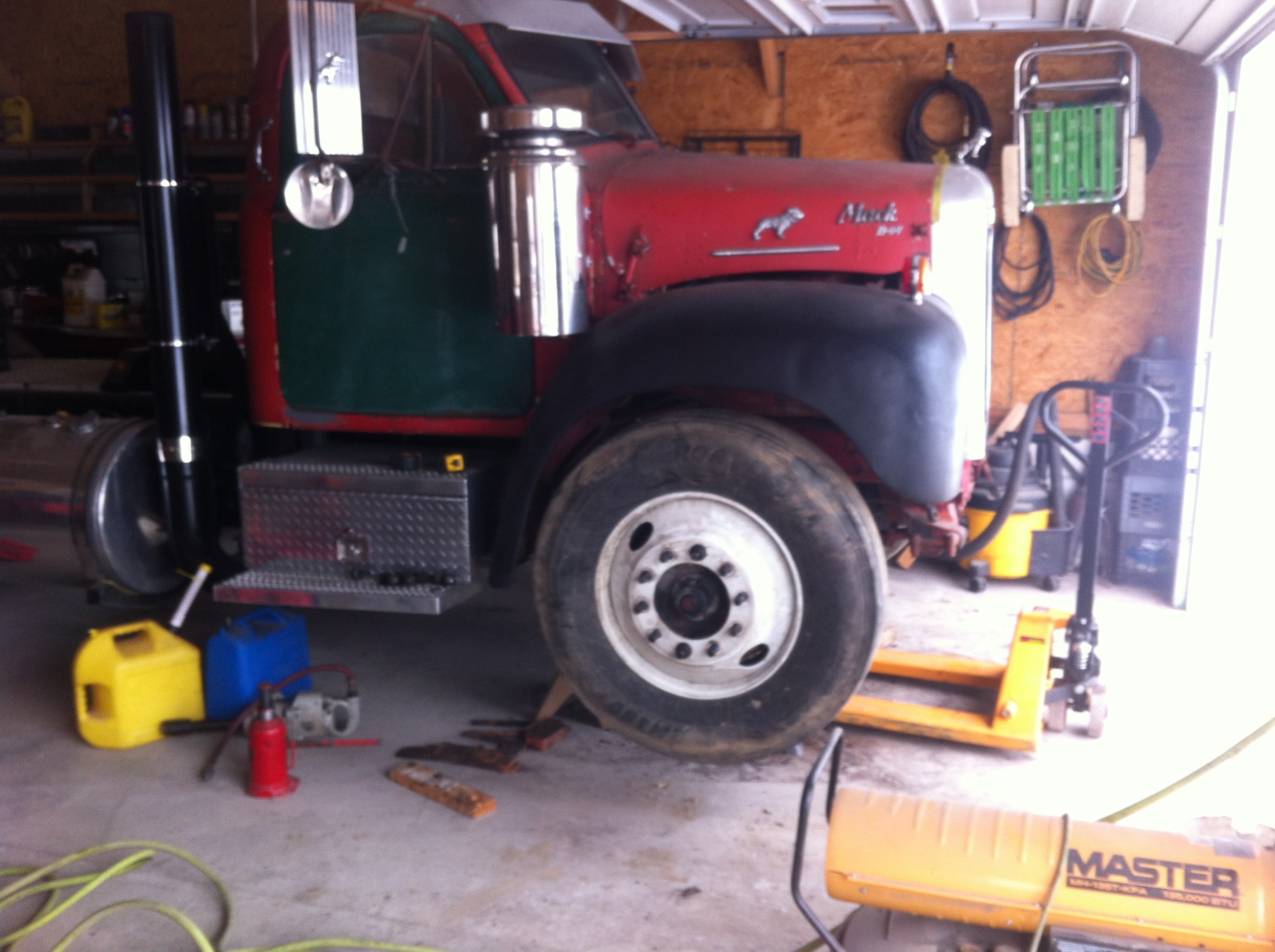

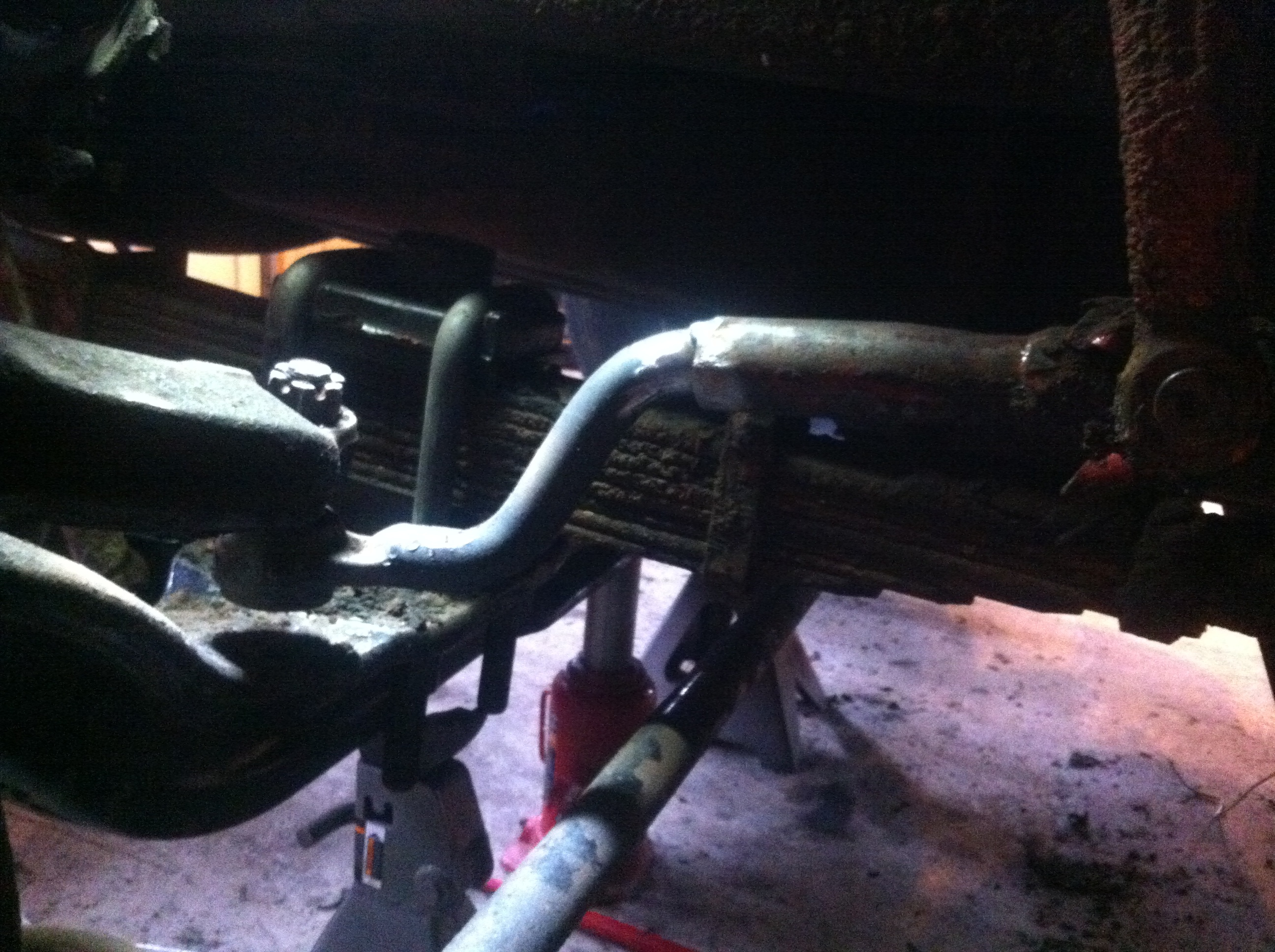

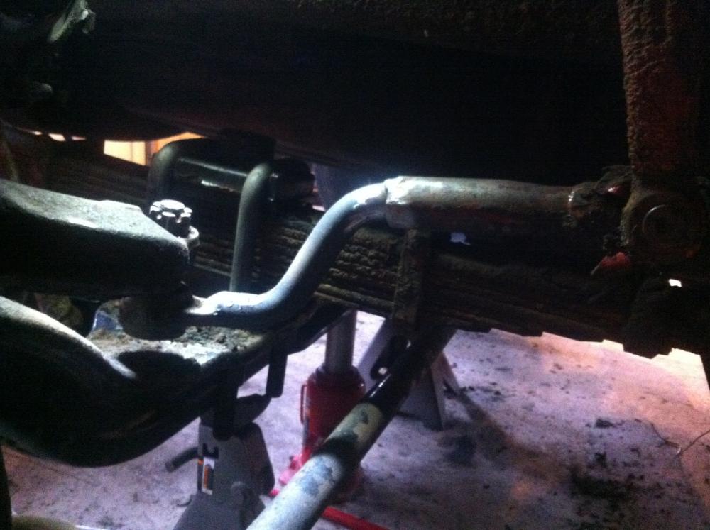

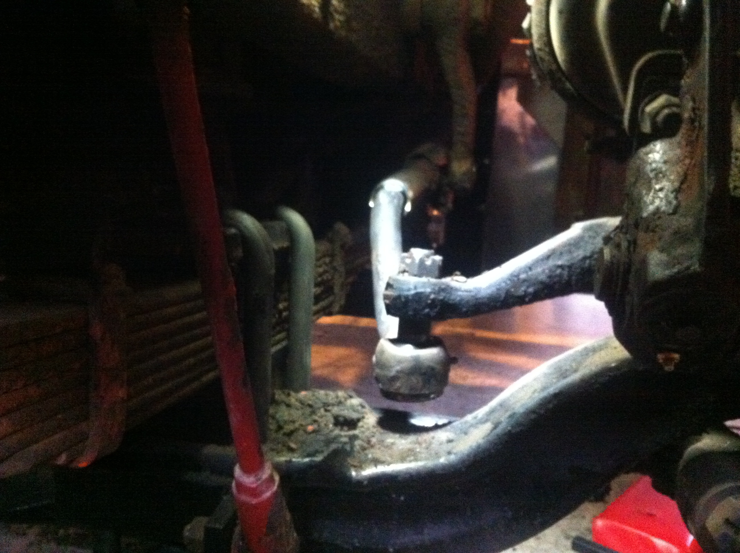

Ifound the steering arm I want to use to get my drag link basically straight.  Only problem is its on our Ottawa jockey truck at work.  It comes out of the knuckle straight then the drag link sits on the top.   most others I've been seeing come from the bottom.  Local vo-tech kids are having a car show at the high school Sunday that I want to attend, it's less then 1 mile so I decided to just make a stepped drag link.   image.thumb.jpg.b3b4790cc103a75c9c3212abefc8c130.jpg it turned out alright, i added a gusset  when I removed it to weld.     My lack of lights limited my test drive but everything worked well.    The new lower stance of the truck is nice, I don't have to unhook the garage door and hold it up with a vise grips to gain an extra  1 1/2".  image.thumb.jpg.1fc4ee294b89b635b320da0191f2db5c.jpg
 I'd put a triangle shaped  gusset on the back outside bend by the steering box. there is too big a potential for too much flex there!   Paul
Edited by 41chevy

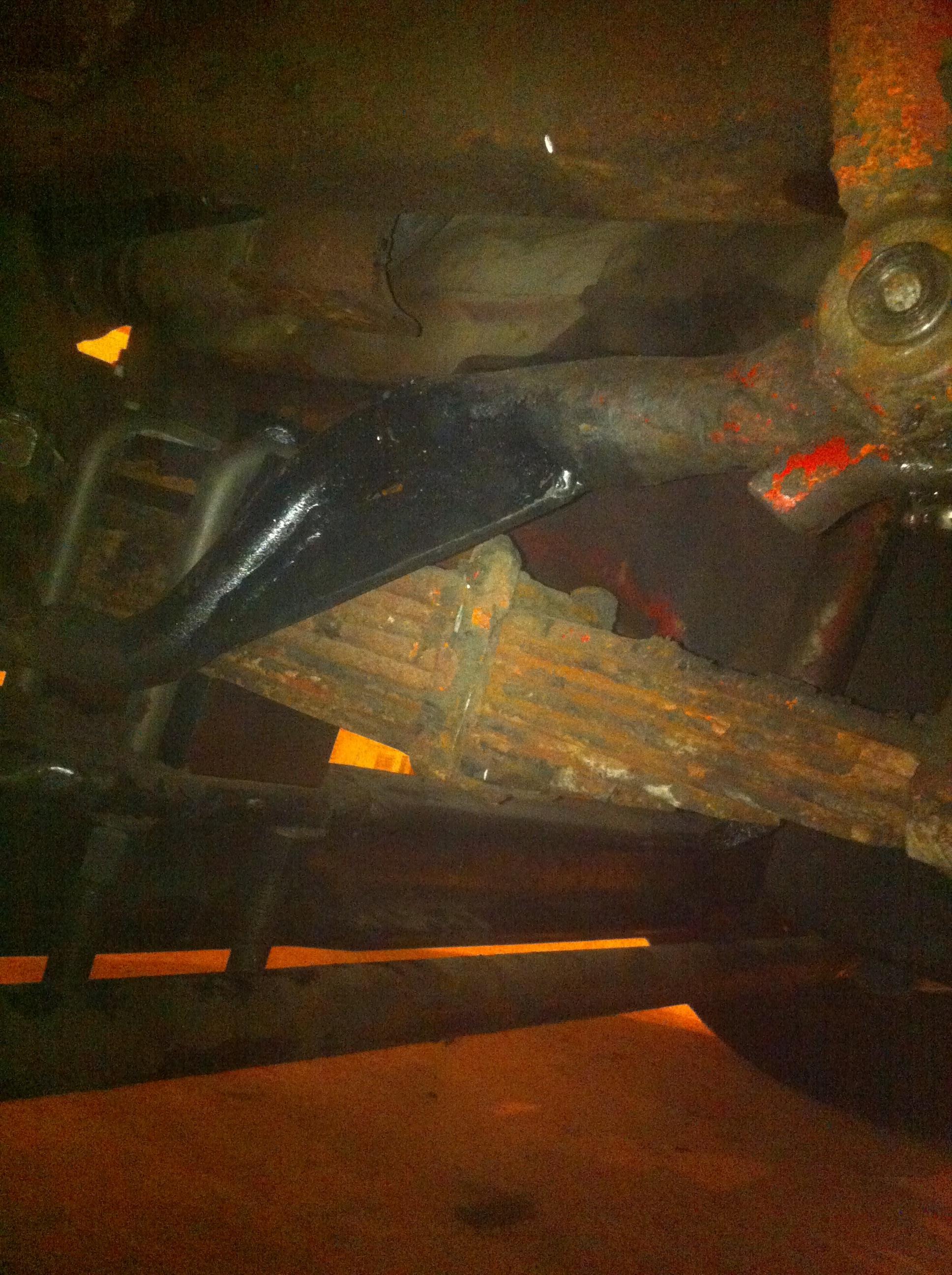

:thumb:  :thumb:
