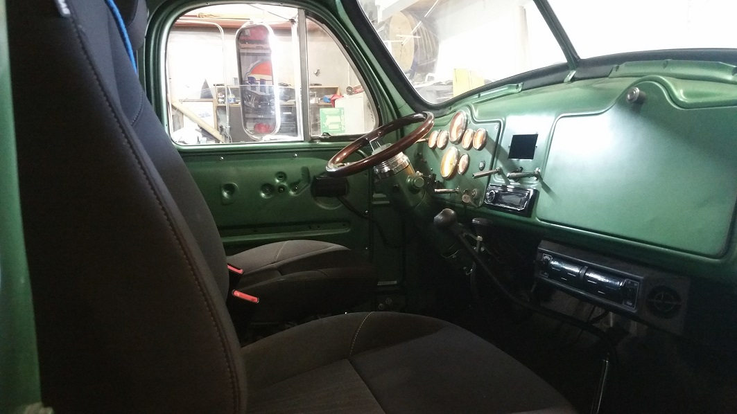

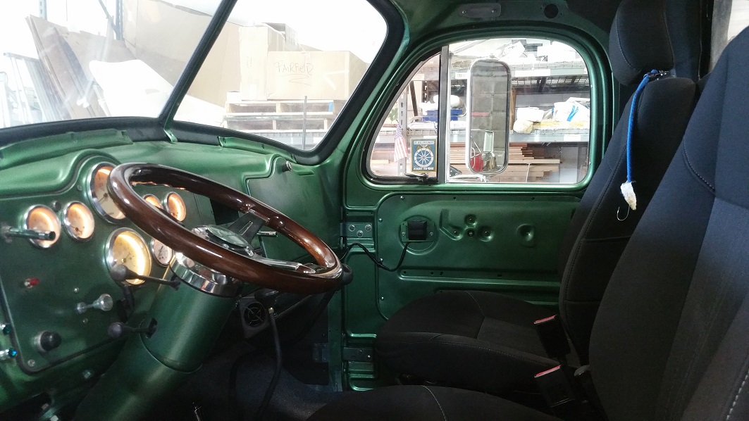

Had some spare parts............

Great work!
What power window kit did you use?  Looks like a universal kinda set up?  I've seen them but wondered how tall they were and if you could get them shoved down in the door once mounted to the panel.
I tried to mock up a Ford window motor right to the original Mack regulator since the teeth look to be identical and would mesh fine.  Only problem there is no room up top without getting in the way of getting the door panel back in the door again.

Thanks Larry, The  window kit I got on ebay from Gearhead Enterprises in Iowa. It does flat glass only and I had plenty of room to get the whole thing in bolted to the door panel. I just had to loosen the bolts holding the new regulator and then tighten them after I got everything situated. They seem to work pretty good so far.The whole kit was only $125. I wanted the window crank switches too but they were way too expensive. You need to go with a worm drive cable because that just curls up inside the door and makes for more clearance.

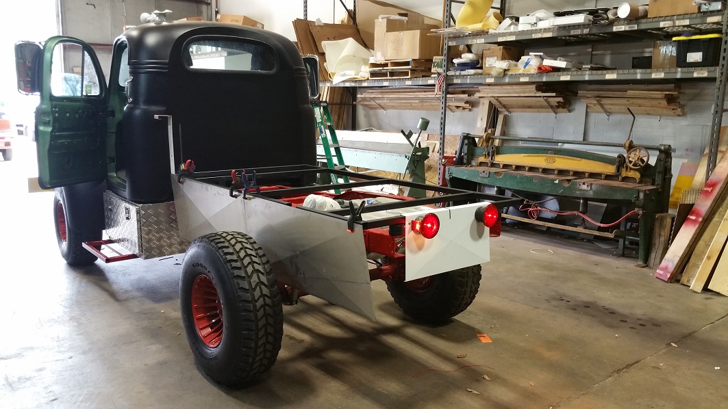

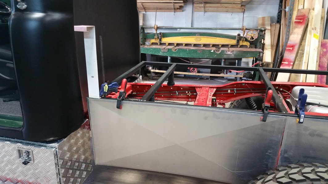

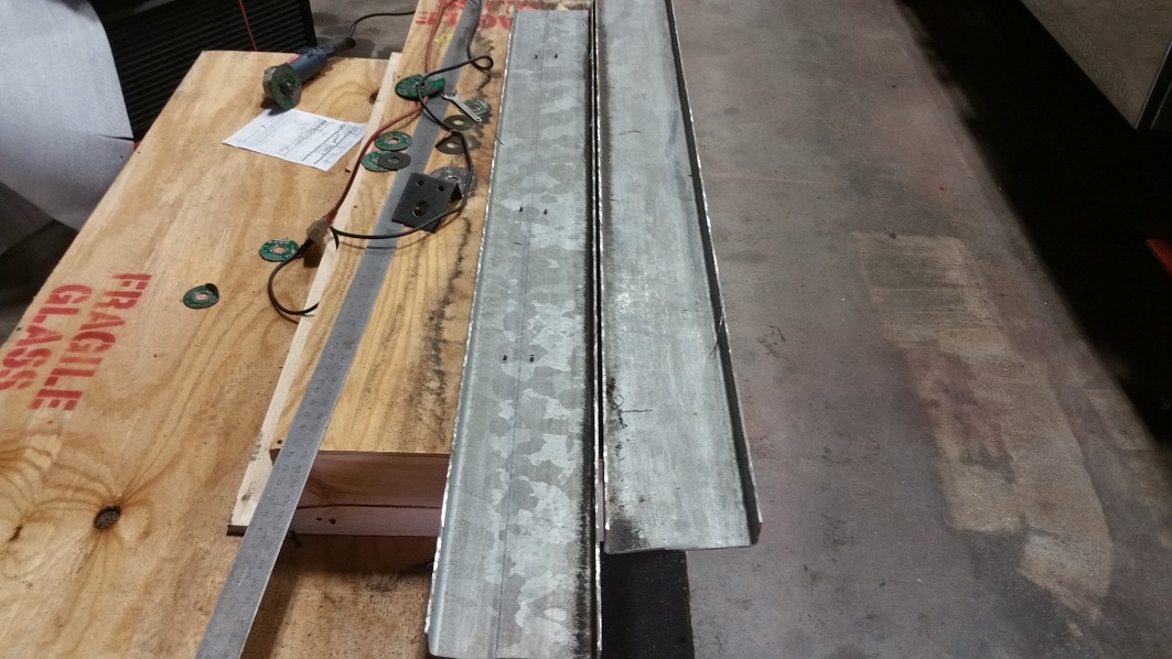

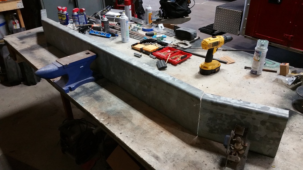

OK so I'm almost ready to register this thing and get an inspection sticker before the end of September when big brother and the state of Calichusetts implements the new inspection sticker regulations Oct. 1.
The new sticker machines are hooked up to live streaming cameras and an outside contractor working for the State of Ma. will be watching from a cubicle someplace making sure that a fine tooth comb is used on everything. From what I've been told no deviations from stock are allowed. all emissions stuff must be present. I want to get this truck through at least once under the existing system because I have a hard time believing the big brother representatives on the other end of the camera are actually qualified to know what they are looking at an will cause me nothing but trouble when they see a Mack body on a Chevy chassis. I hope that once it;s gone through once I'll have an easier time next year.

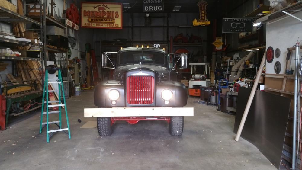

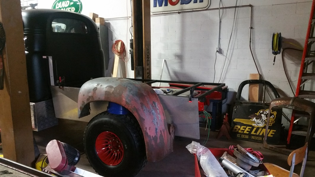

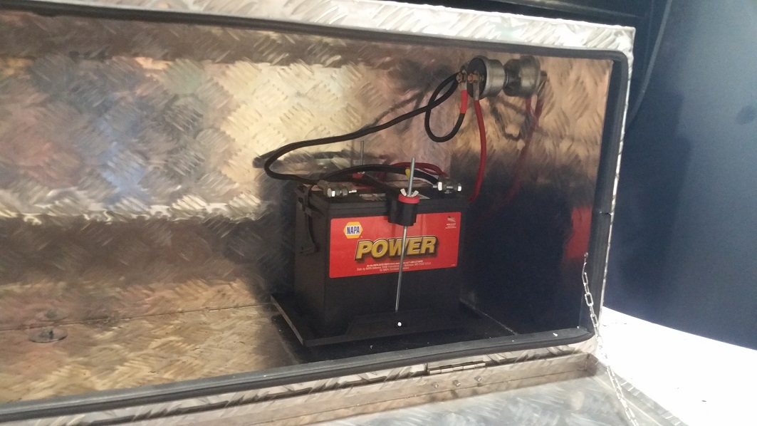

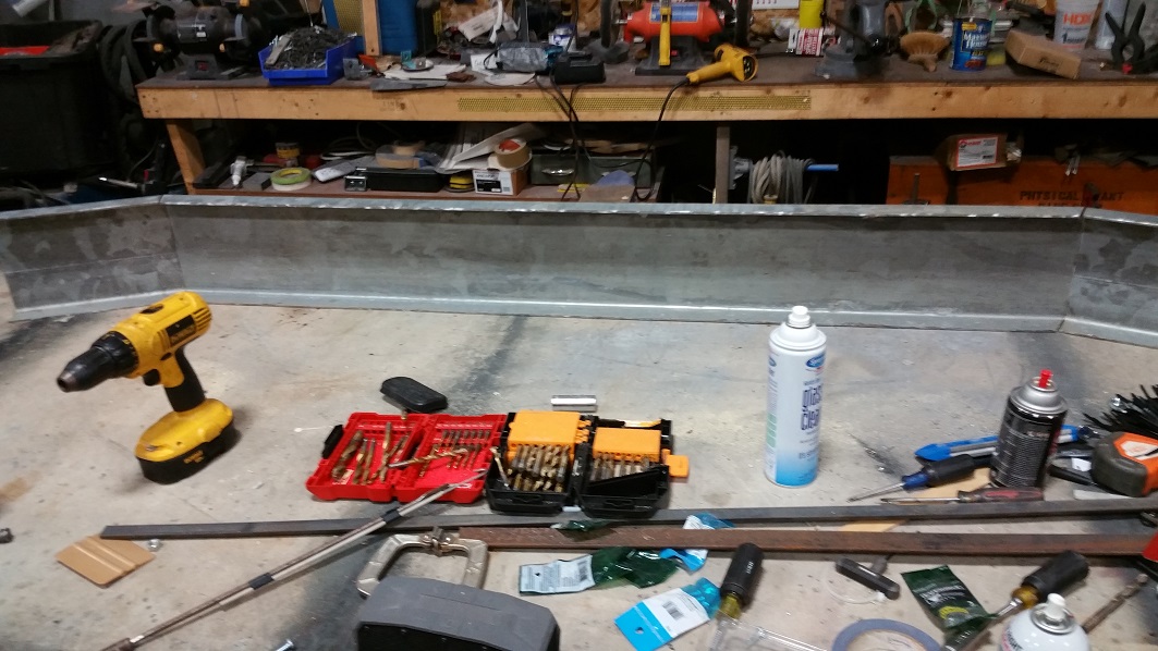

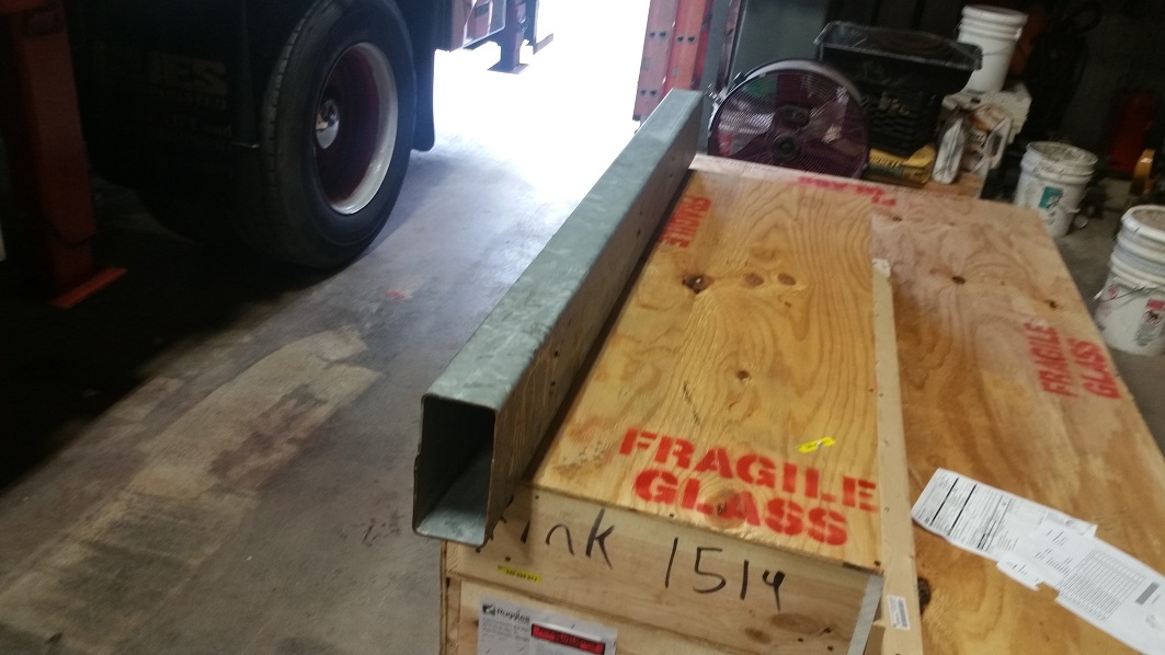

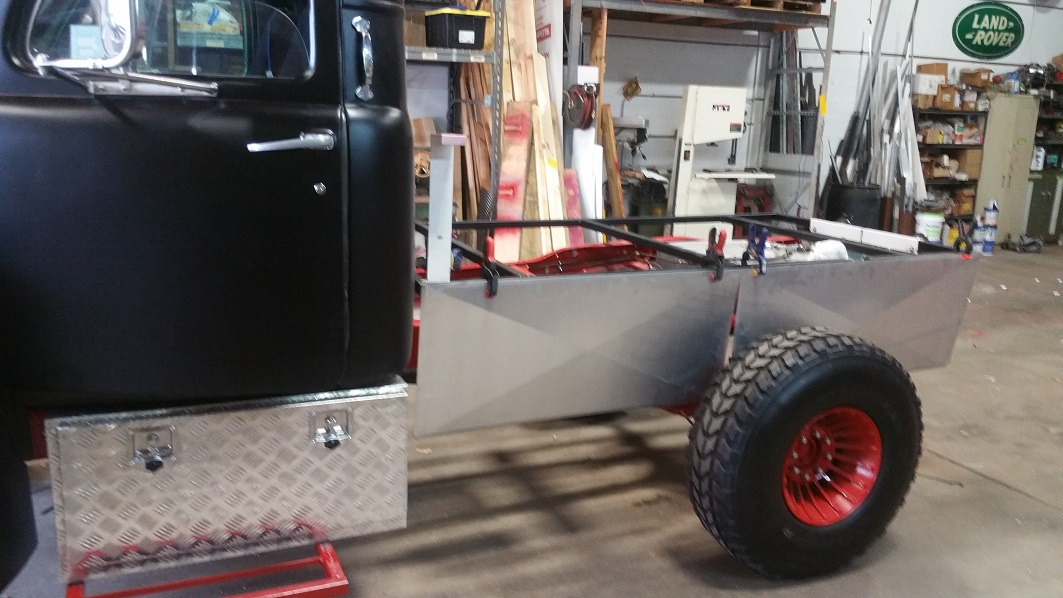

Today I got the toolboxes mounted, battery, cables and batt disconnect in. interior is all buttoned up. made up a temp rear light panel. and did some mockup to get measurements for the bed sides and front bumper.
