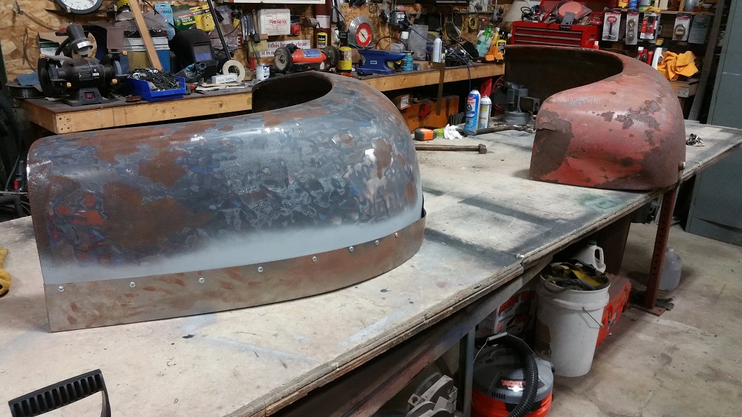

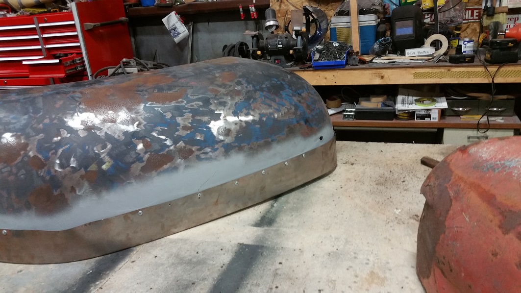

Had some spare parts............
66dc75

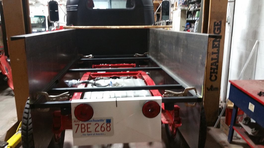

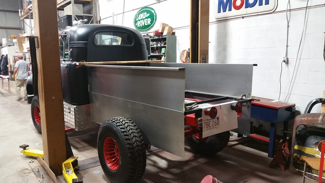

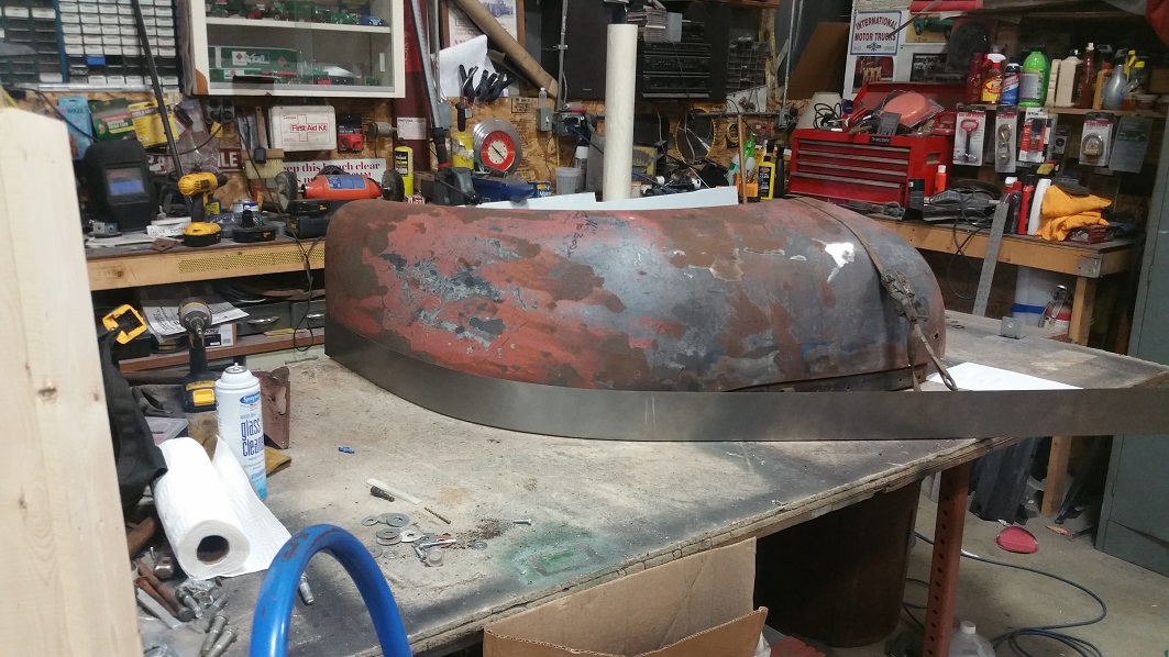

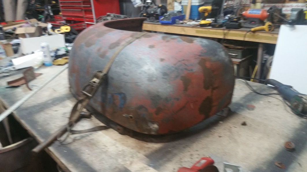

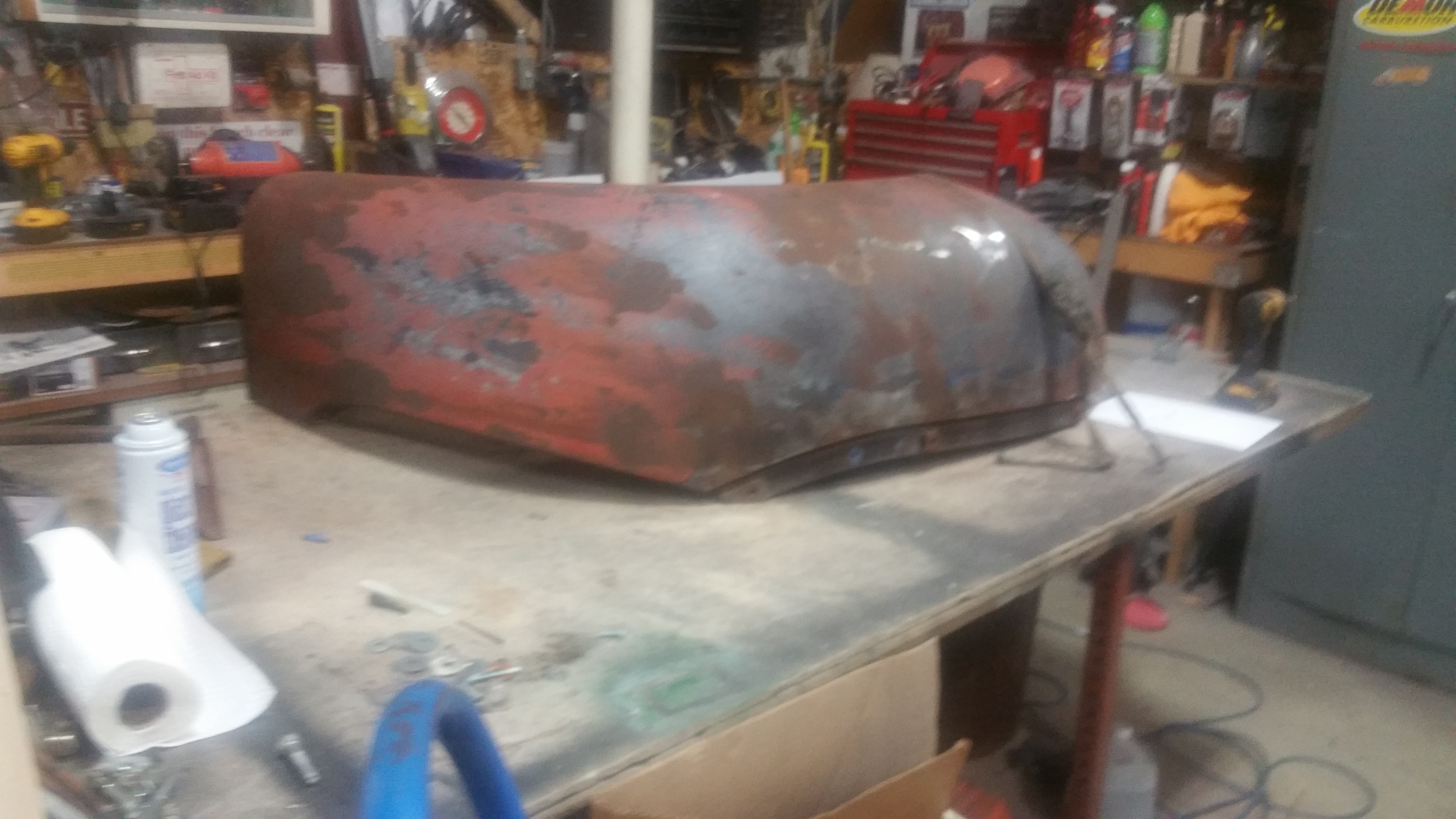

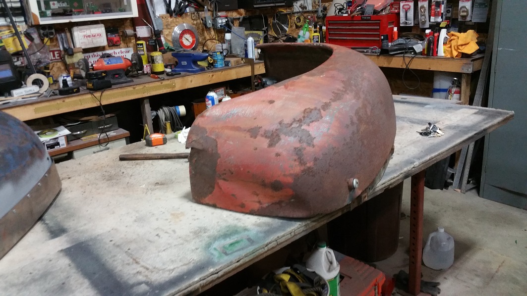

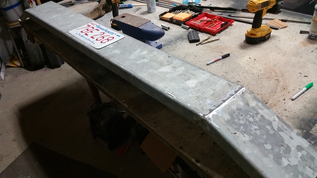

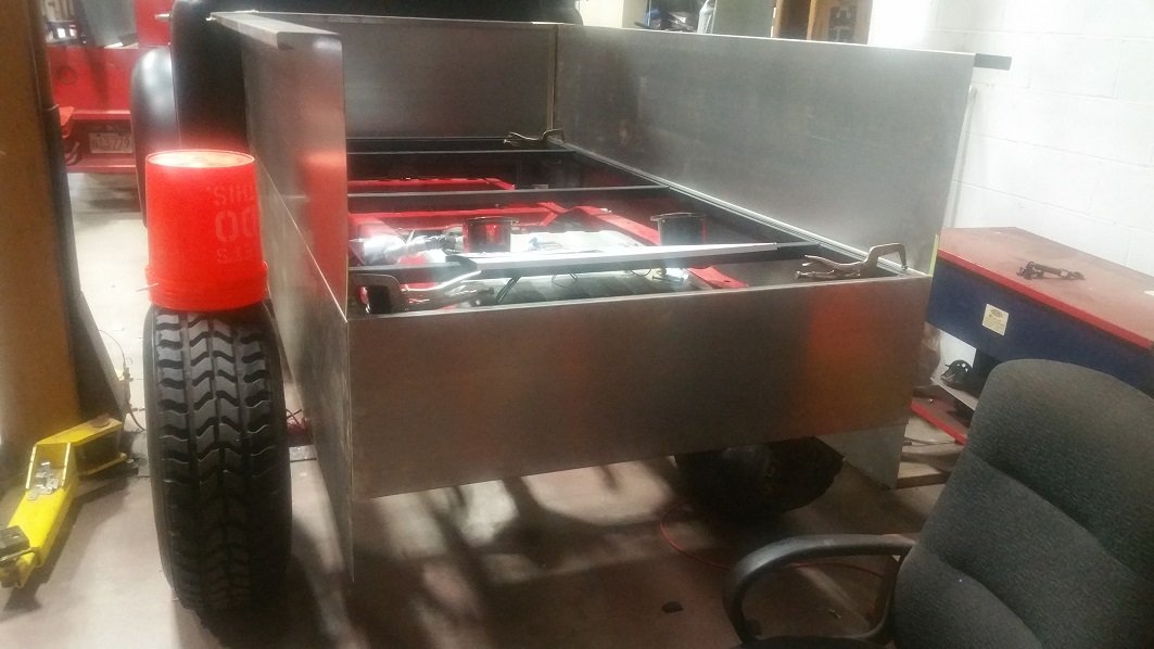

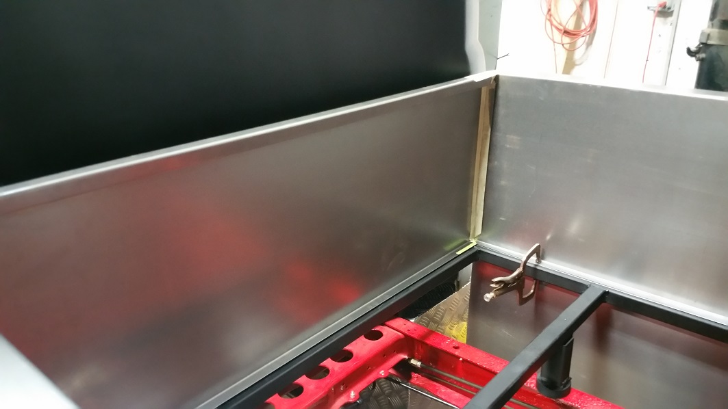

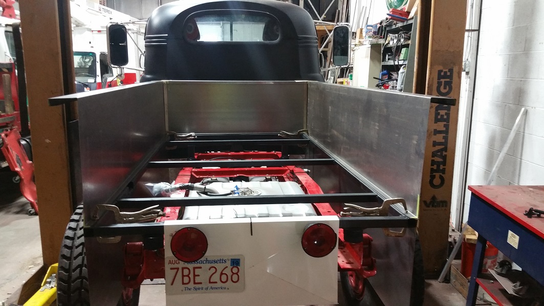

When I had to re-create the rear fenders for a 72 IH fire truck that were a similar shape I made a plywood form and then bent the metal around that while securing it with clamps to hold the shape. I used 12 ga so it was heavy enough to hold the shape without buckling and was easy to weld.
Instead of pop riveting to hold it I'd try tacking it so you can stretch the metal around while heating it to get it to conform. Just my $.02.
Actually that's pretty much the way I'm doing this. I'm going to pull the tek screws out as I tack weld. Ive got a plywood pattern to get the other side the same and to use to drill mounting holes in the bed sides
