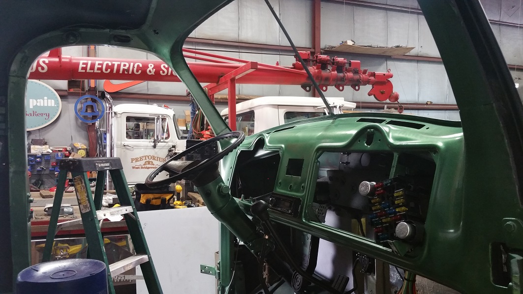

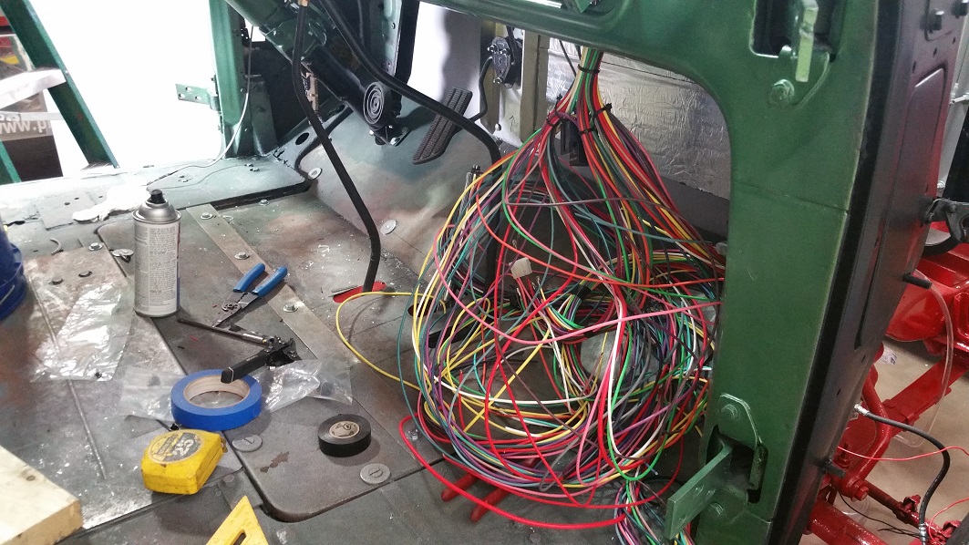

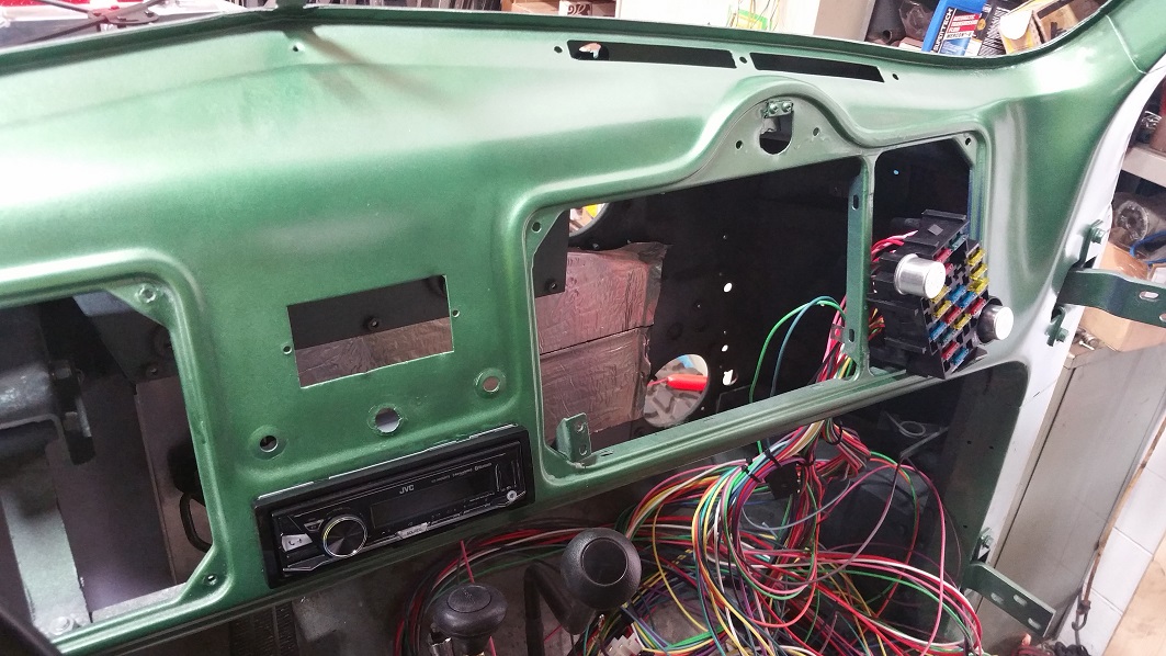

Finally got caught up enough with work to be able to make some progress on this.
 painted the cab interior, got the gas pedal mounted and hooked up, bled the brakes, cut in the stereo, and got the clearance lights on . next up the pile of spaghetti hanging from the dash.

I just used one of those EZ Wire harnesses in a 41 Willys project I'm working on.  Pretty nice stuff, all marked wires.  Only bad was the kit I had to use was the 21 circuit and the fuse panel has NO markings on it.  You have to guess what fuse is what.  I see you got the more typical GM style fuse panel unit(like 12 circuit?).  Much better.  I got roped into this project after it was started, so I had to work with what was there.  Though as tight as this little car is that little fuse panel fit better then then that big GM style.
(notice LOTS of yellow tape to better mark the wires for what they are.  Reading that little print gets hard on the eyes)
