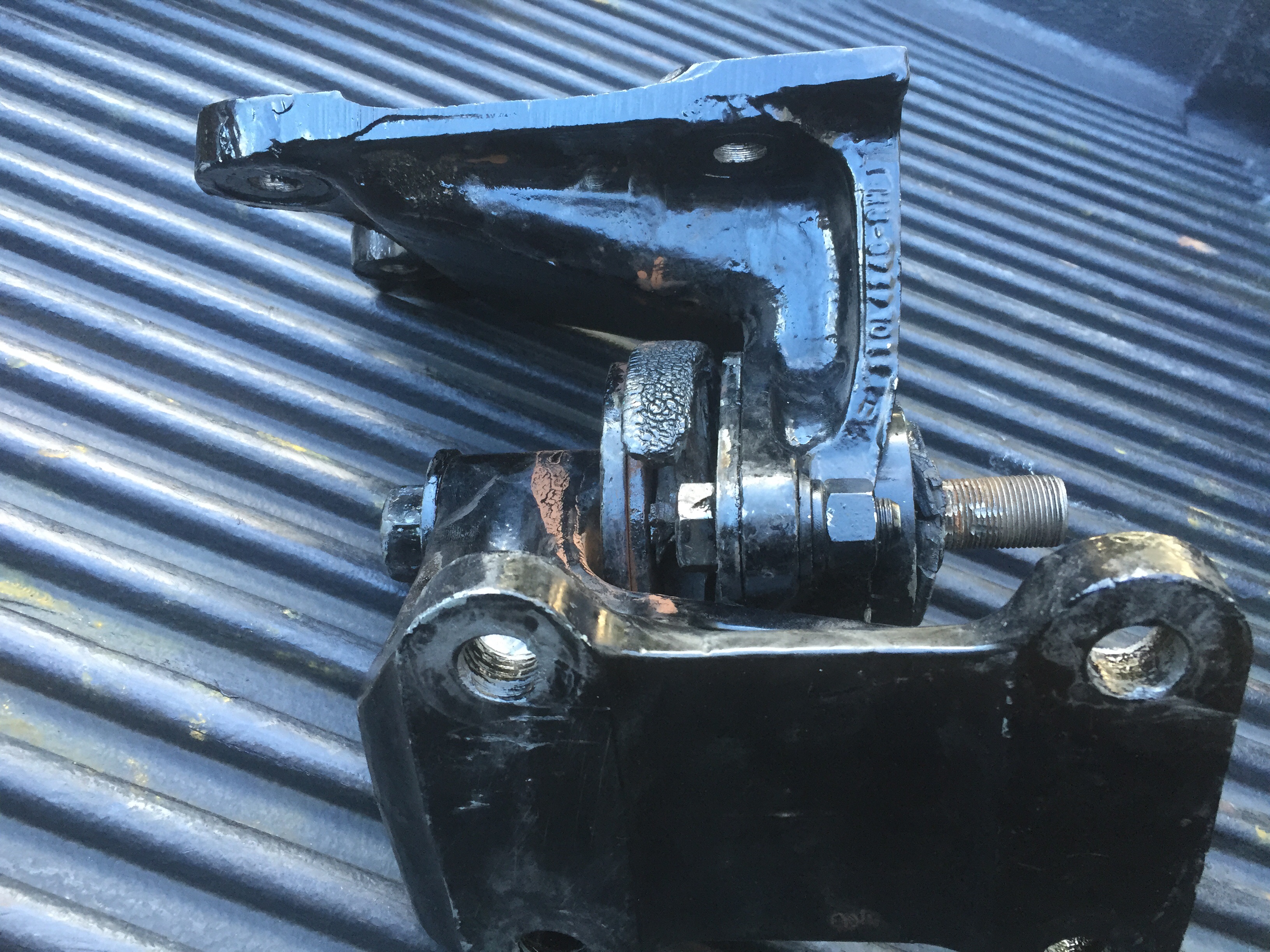

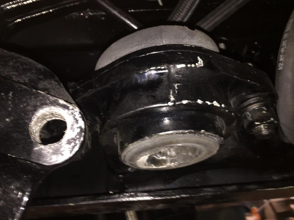

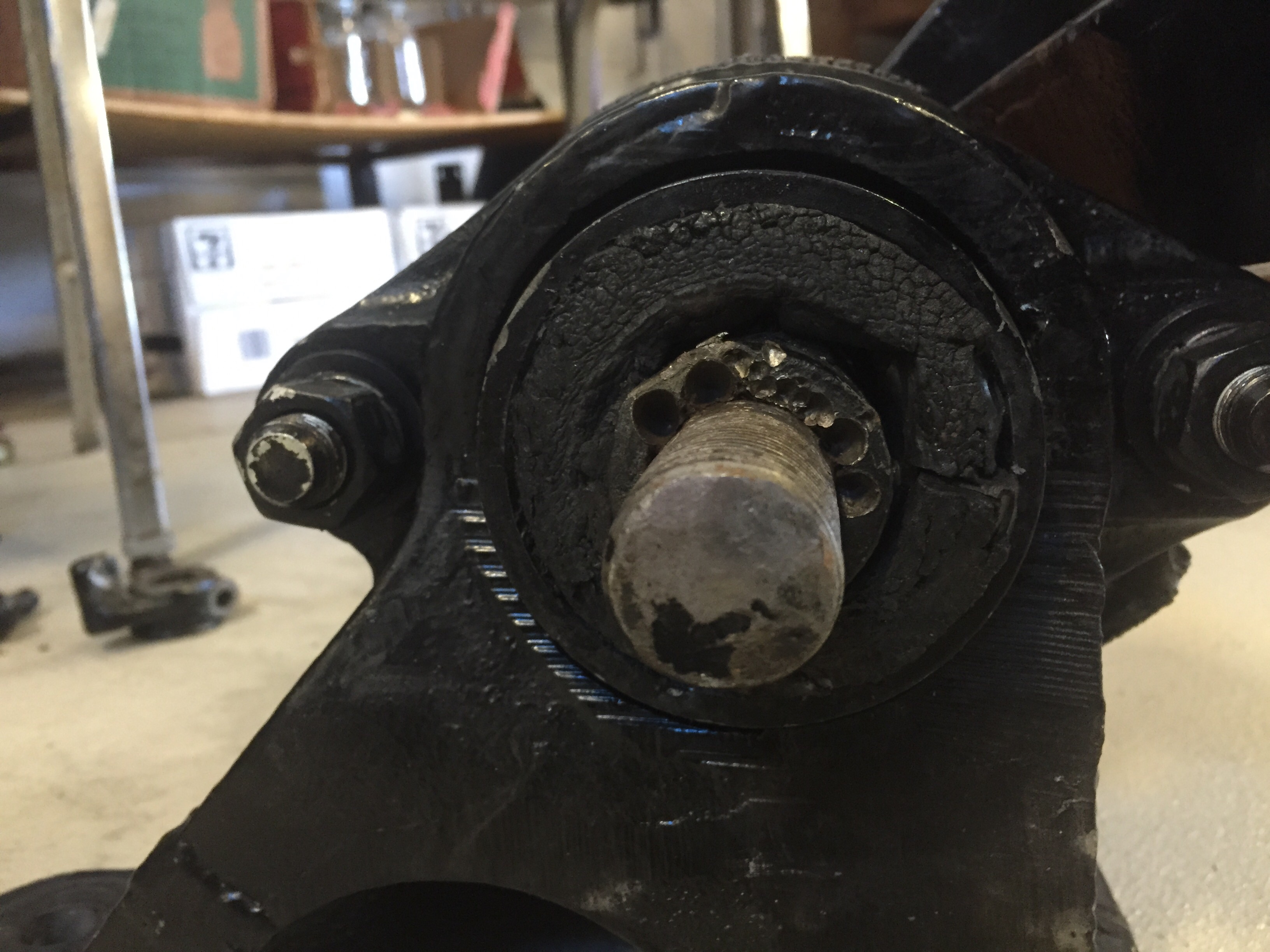

Need some help with a part number for bushing kits and bolts for the quadraplex trans Mack said good luck, but I have seen the single 7/8 style supports on later model tracks, thanks for any help you could give me. Part number on Transmission side is 158GB376-A

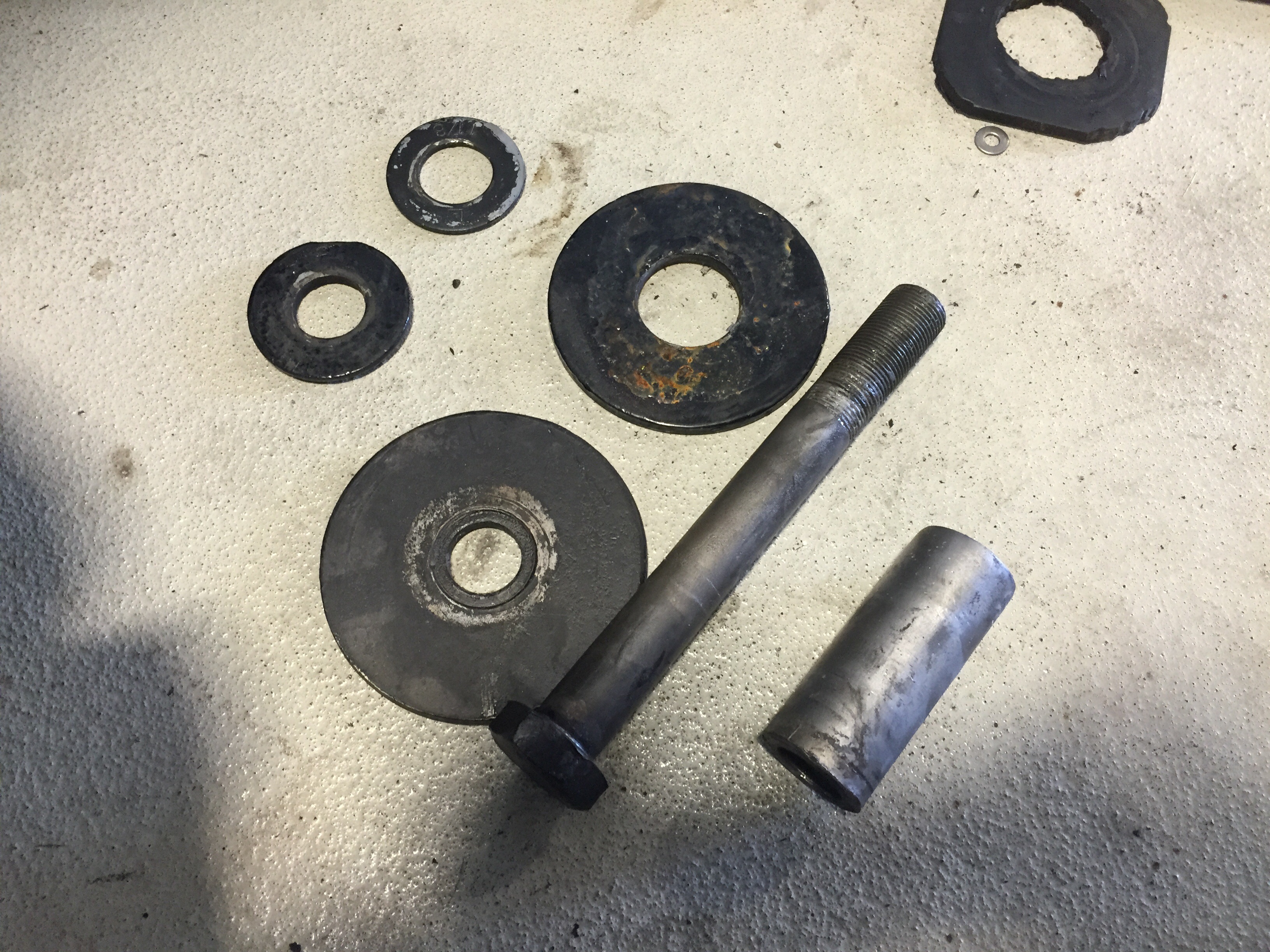

The B model mount (#107MF21P11) is 1 1/8" tall, id is 5/8" and od is 2 11/16".  The id could be carefully enlarged to 7/8" if the height is close or add washers to make it thicker for your application.
The trans mount hardware (#204SX216 kit) out of an R model is about 3" od using 3/4" fasteners.
