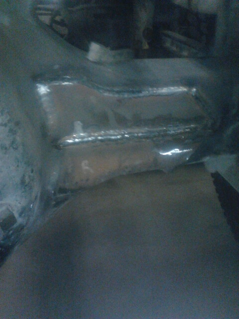

I got her fixed today. I made a u shaped groove 1/2in. x 5/16 deep. The axle is 7/16 wall. Filled that up and plated it. I used two plates on top and bottom of the seam weld and filled the center gap. Keeping fingers crossed
As long as you cleaned it well, stop drilled the crack and stitch welded it you should be fine. The drilled stop holes are pretty important to prevent the crack from reoccurring.
