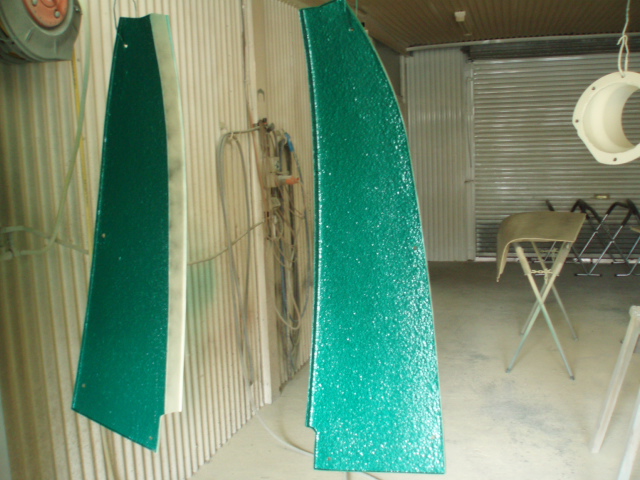

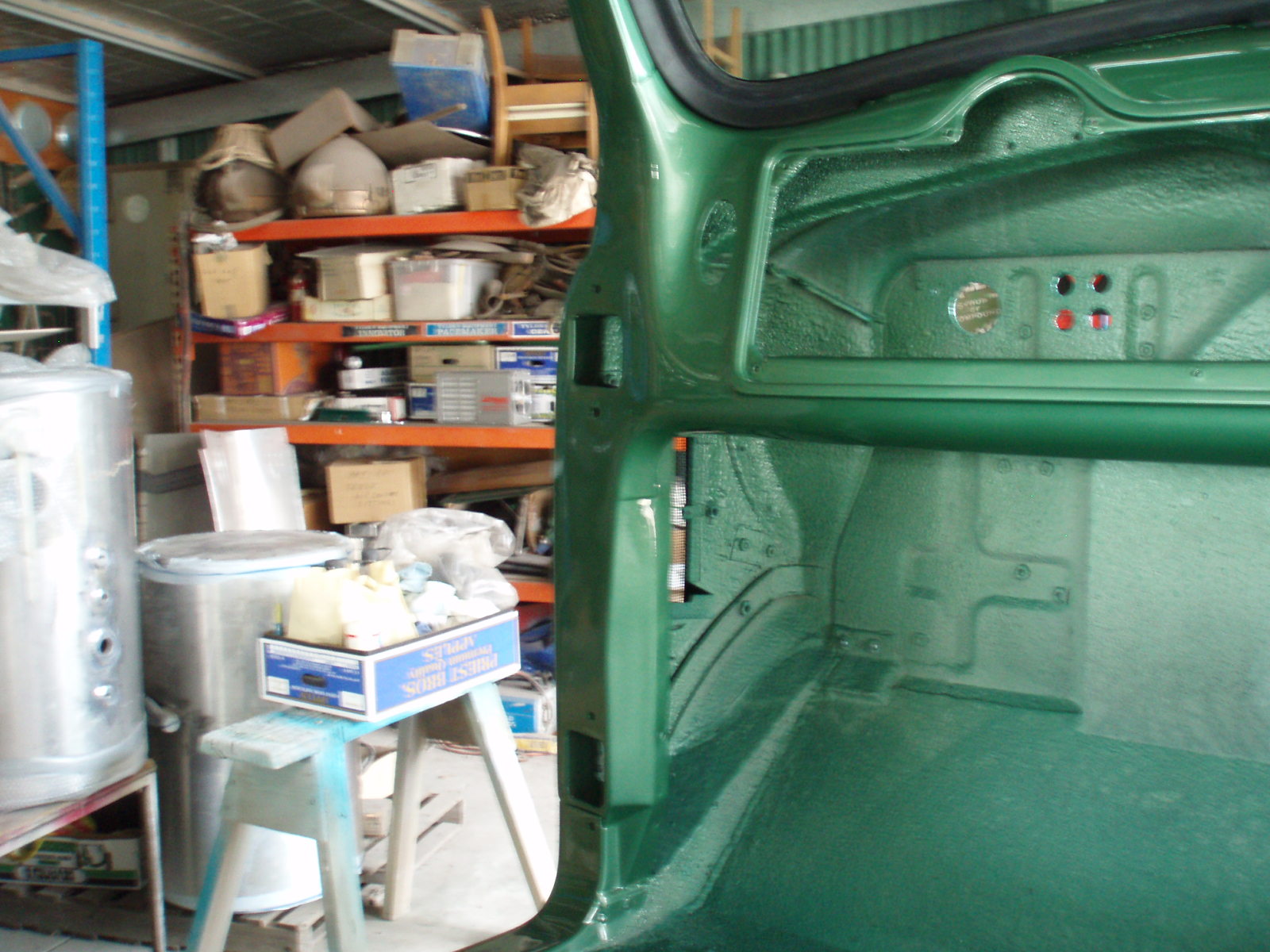

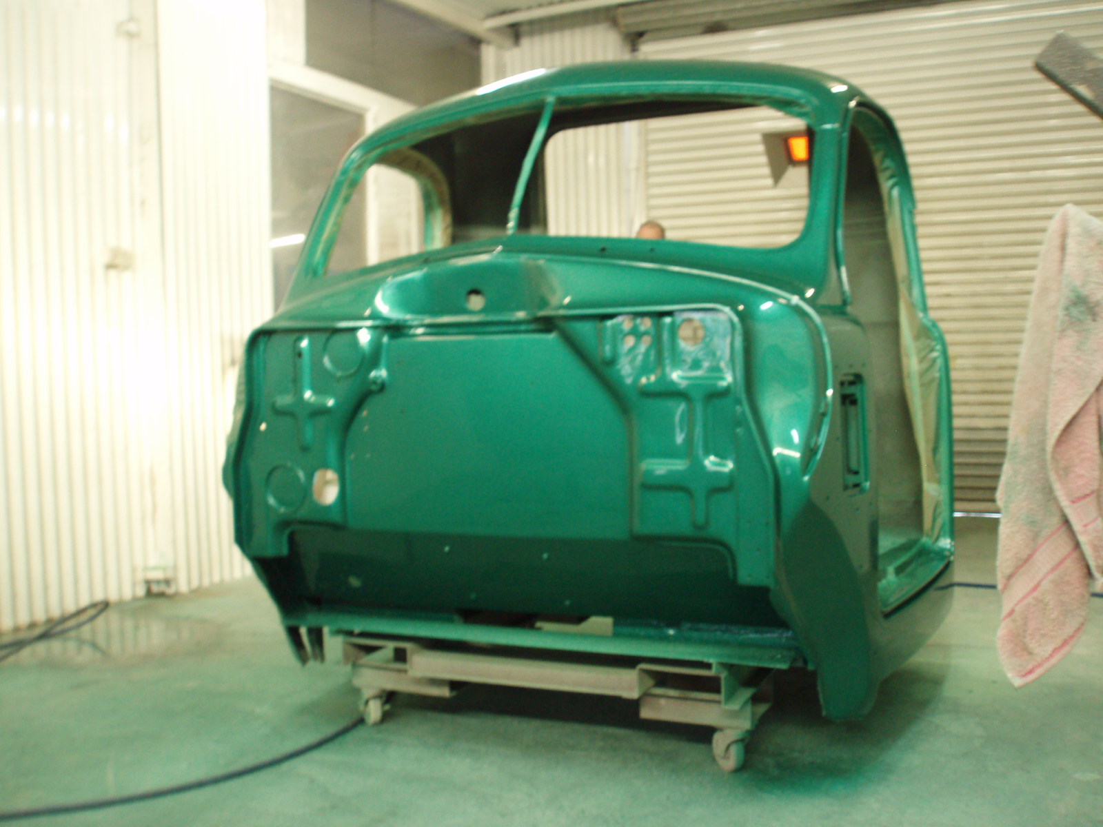

The filler is hyfill that we sprayed onto the body panel after prime coating to produce a smooth surface finish before spraying the final top coat - on our cab it's the Irish green. To explain our process for the fire wall, on the engine side, cab stripped to bare metal, rust etc repaired, spray primer, then on the fire wall - engine side - we sprayed first the Lizard skin - the sound control,let it dry and lightly sand to remove rough finish, then we sprayed the second product the lizard skin and also did a light sanding after drying (they have the 2 products and must be applied as noted here), then we sprayed the hyfill - we added a paint flexible additive to the hyfill to make it flexible before spraying, the hyfill was sanded back and a second coat of hyfill with flex additive applied to get a complete cover and it was sanded resulting in a smooth surface, let it dry for 1 week then we sprayed the top coat (Irish green) which also had the flex additive - the pictures show the final result - fire wall is as smooth as the cab exterior and no peeling as we had when we painted without the flex additive - now 18 months since applied we have had extremely hot and 2 very cold winter temperatures and no peeling. We also applied the sound control and the lizard skin onto the cab interior side of the fire wall - so the fire wall is sandwiched on both sides with the 2 lizard skin products, we also did same to the cab floor (no hyfill because there is no top coat paint) the all other non painted surfaces inside the cab even behind the dash board - application inside the cab was max 30 minutes and a thin coat (thickness of a credit card) and just to be sure we gave a second thin coat.
It is a simple, easy product to spray onto metal and other surfaces and non toxic product - easy to wash up with water and it fills all the weld joints and metal joints and hard to get spots
Vlad the lizard skin is a rubber like skin with golf ball finish once it dries, it is now approved by the US car companies as an after market rust protector for repairing accident damage, for all underside panels. The inventor of lizard skin crated it from the space shuttle products used on the heat tiles around the shell of the space shuttle. There are other similar products that are based on the air bubble technology. The air freight couriers like DHL will transport the product, we got our first 2 gallon pails by DHL post 9/11, no problems. There are some web sites that you can read up on that people have written and compared the various sound and temp control products - worth reading. Good luck with your project.
Yes the first primer is a metal primer to seal the metal or fiberglass or aluminium body panels. And yes if the lizard skin is to be painted with a top coat then a flex must be added into the top coat or as we did added to the hyfill. On the underside of the hood we sprayed the lizard sound control and then a couple of coats of green top coat to hide the dark grey lizard skin - we added flex in the top coat.
Re the foam products we have not used them, we checked them out but they don't stick and seal same as the lizard skin. We have used the foam for building plumbing jobs and other general building maintenance jobs filing holes - can't compare the 2 products they are made for different uses. Old story do the homework, use the most appropriate product labor time usually about same hours, get job done properly once and don't look back.
