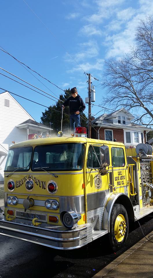

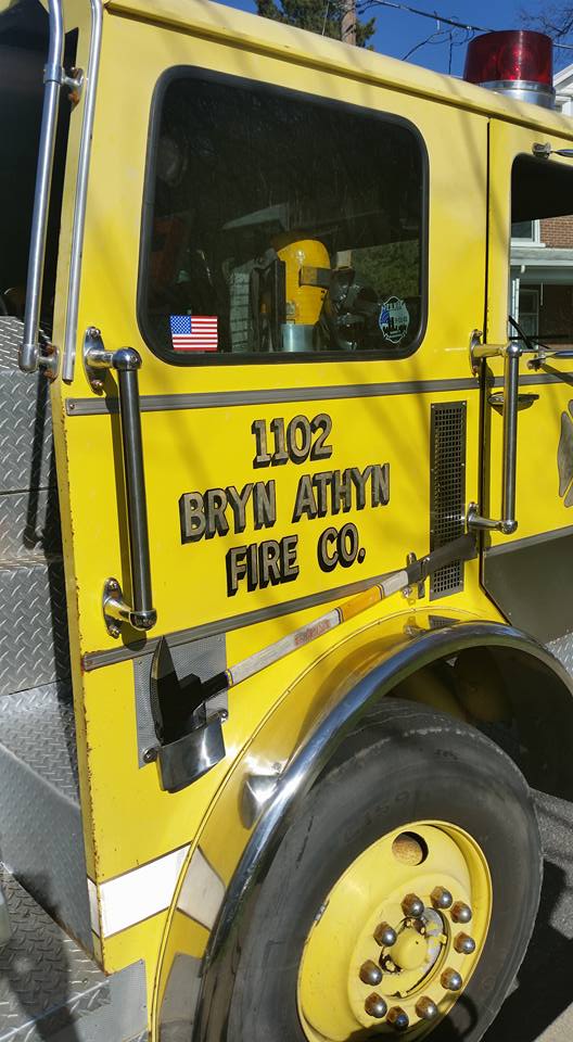

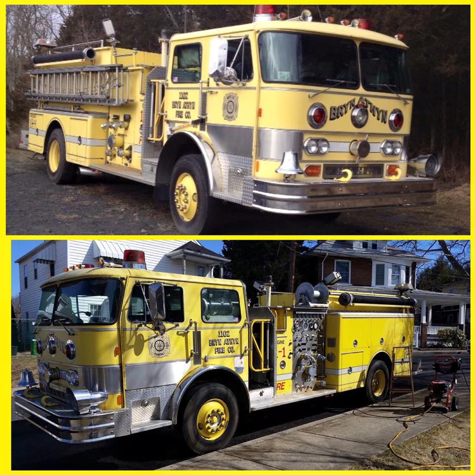

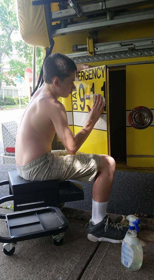

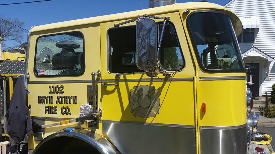

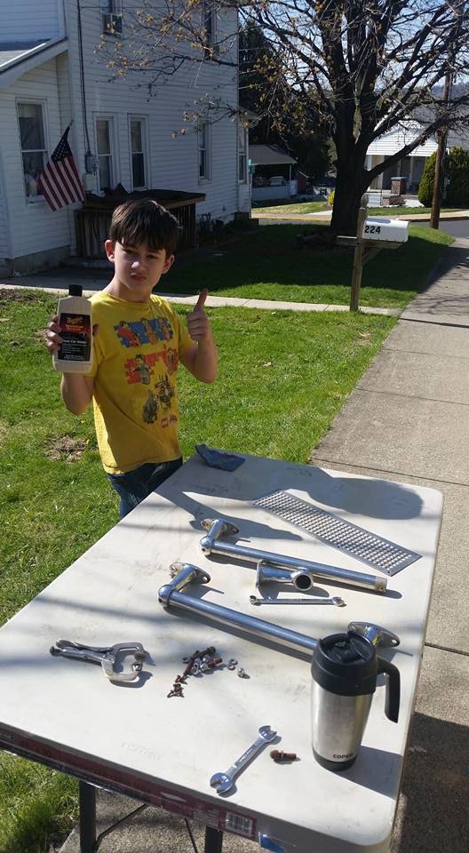

I know for a fact that I am the first person to ever have washed that truck- when it arrived (about 6pm on a crappy February day back in 1990) it had driven up 95 from Talladega, Al where the Quality plant was located at the time. It had all kinds of crap all over it including road salt. So they backed it into the firehouse and approximately 15.8 seconds later I was up on that roof with a hose and a small bucket of soapy water and a sponge. And over the years I have waxed that thing probably a dozen or so times....and  washed it more times than I care to remember...lol
Monday was spent completing some more of the paint restoration. "Large" has really taken a liking to the truck and did a lot of the Monday work. My father had him on a creeper last week replacing air hoses and pancakes in the front brakes. They're going to do the parking valve together when Dad can find an American made one. Yarnall said to send Large over to his house but I told him he couldn't afford to feed him.
