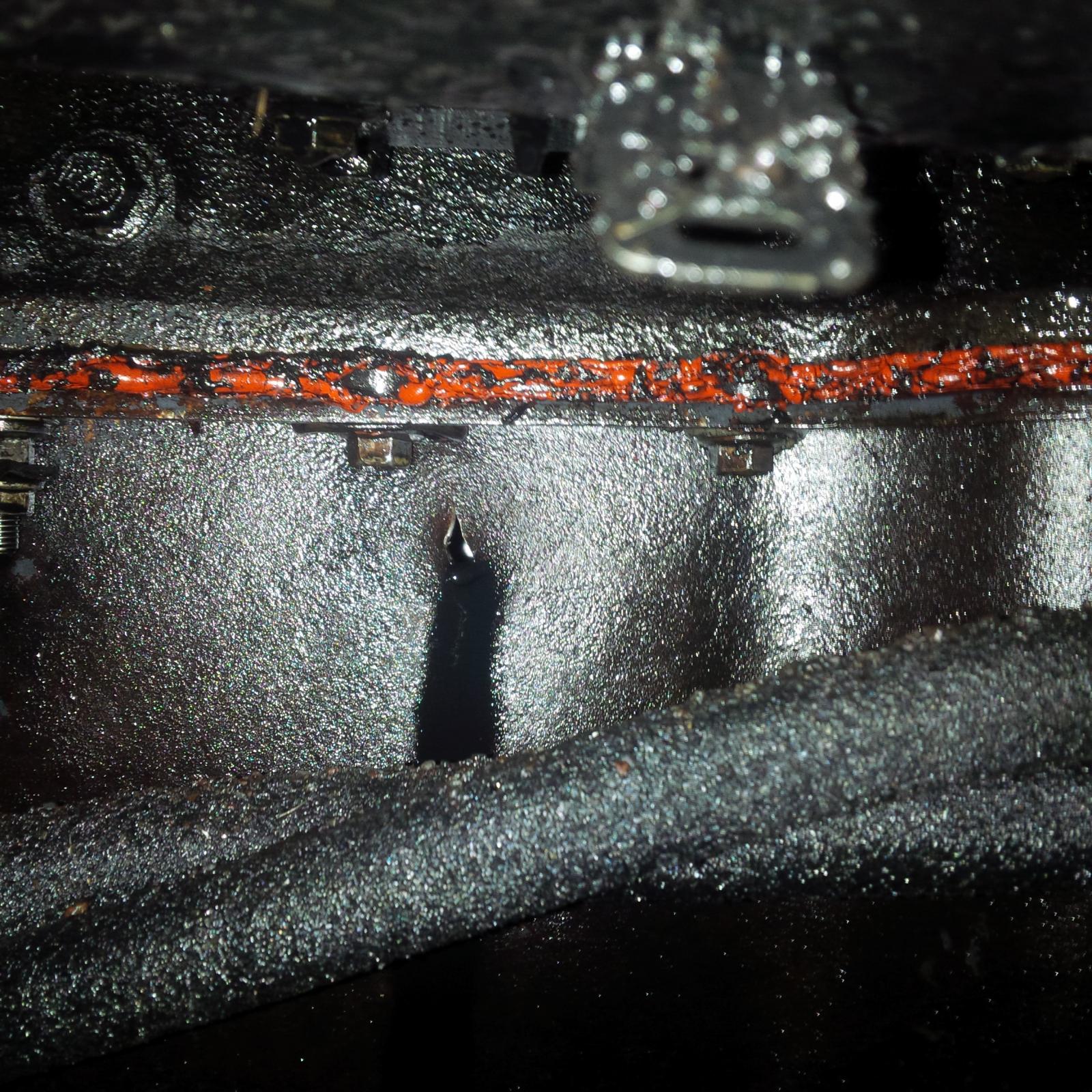

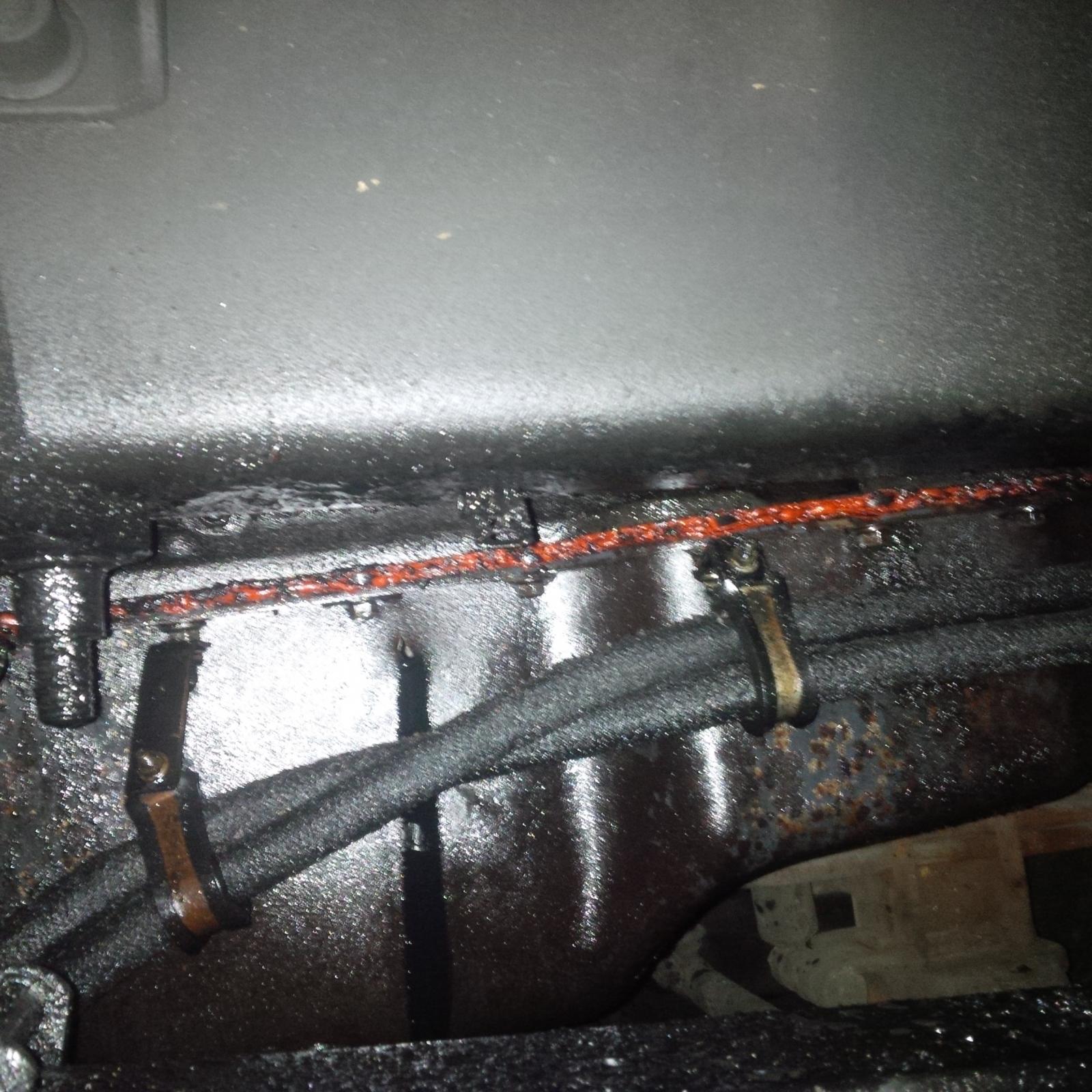

HOPEFULLY this is the only hole punched. I ought to be able to weld a patch onto that while they are working on the internals...IF they ever get it into their shop. Deer season. Mechanics on vacation. Wonderful timing on my truck's part.
Rowdy your truck looks like it should be parked next Yardos Haun, then you could compare oil loss! At least it poked a hole in the pan and not in the block! as for the freight shaker, well we have all drove them and that's what makes us grateful for what we own! hang in there, you will be staring at a dogs ass in a little while.
It hasn't made its way into the shop yet for a tear-down...and until it does, I'm still only HOPING there isn't anything else tore up. I'm going to be extremely lucky if patching the oil pan is the only thing needed beyond what would have otherwise been replaced during the overhaul.

Well, just got word that #4 cylinder came apart in spectacular fashion...piston sitting sideways in the cylinder, sleeve shattered, and the hole in the pan was likely shrapnel from the sleeve exploding. Block is junk, so I'm getting a ReMack engine...but without a core it adds around $4K to the cost. Anybody happen to have an E7 block laying around in the way that would work for a core for an '01? Came off the line June of 2000 if that matters...
I'll get pics tomorrow.
I feel for ya Rowdy. The real question is how does that just happen? I don't think e7 pistons just break like that. Most people get an overhaul done because rings are shot and whatnot and losing oil. Sounds like something happened and caused a huge surge of oil pressure or something. I would be curious to know what can even cuase this. Hmmmmmmmmmm Keep us posted.
Slow and Steady Wins the Race!
Apparently it needs to be a complete motor that can be turned. If all I can wrangle up is a block, they can use my heads and loosely throw together the internals to make it pass. I'll have 30 days from when the new motor arrives (or perhaps is ordered...not sure) to have the core returned, so I've got a LITTLE time to try to come up with something. E7-460 is what was in there...so it would have to be a similar block.
