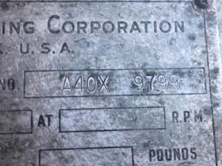

Could you post a picture of the VIN plate?
Jim
Sure can, if it did not rust away with much of the rest of the truck.   It will be several days before I can get back to it.   Where would the plate be located giving it is still there?  Sorry for my ignorance of the truck.  I know so little about it, but it is in very good and will quite a truck when I am done with it and will do Mack proud.
Okay.  I recall seeing a plate there.  I also remember it too far gone to read.   I will see if it will clean up good enough to make out some of the information.
Yup, that looks like A40X 9799.  I guess the Mack Museum will have to figure this one out!
I don't have an explanation of the sequential numbering system beside what was posted previously.
Jim

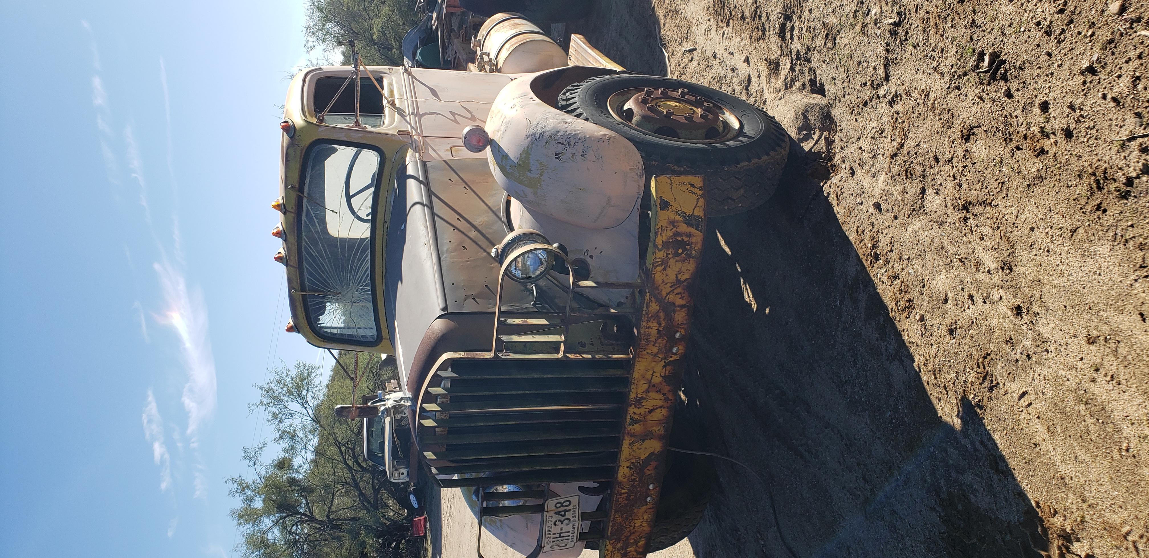

Hello, I am not at all familiar with Mack trucks and this one is the first one I have owned. The Model is A40T with 4829 as the chassis number. It has the extended sleeper cab with the tiny crank windows. Engine is gone but everything else remains. I planned to use the cab for a custom ramp truck for hauling cars, but I know nothing about it and I still don't, even after googling the model number. This site came up and I was hoping to learn a little about it.
Thank you,
-Jake
The A model was built 1950-53. Do a search here for A40 and you will get a lot of posts about them. There were other A models as well that would be similar.
If it is that complete, you might consider keeping it original. The sleeper cab would make it rare.

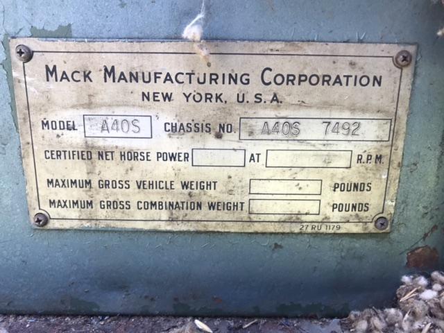

Hello Andy, happy to report from my title 1952 A40T7492.   Engine number EN 377 491, with a triplex.  180” wheelbase, running strong.  My 15 year old and I drove it across town to our shop yesterday, about 7 miles.  Photos in a separate thread that I have started...
Make that A40S.

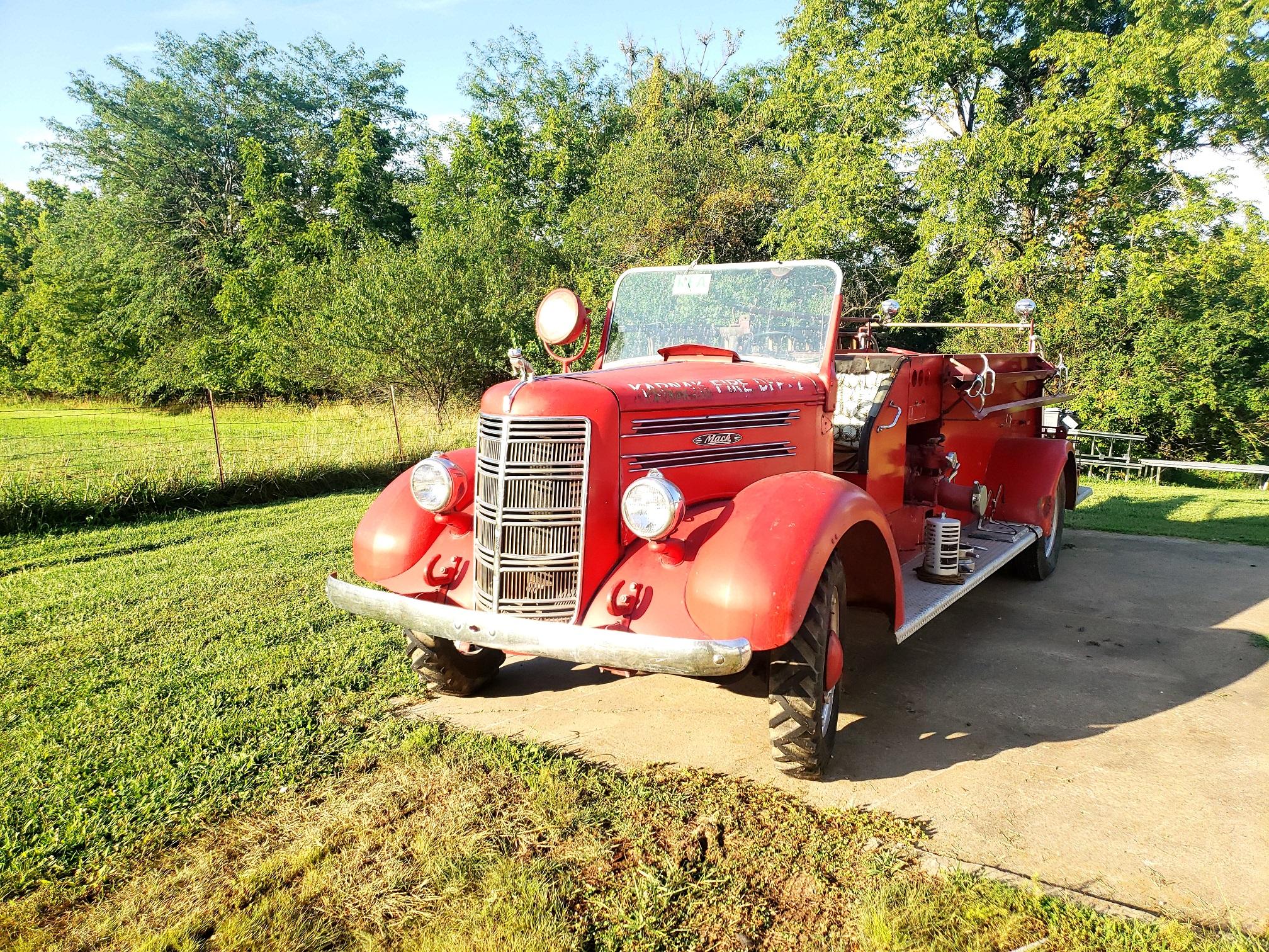

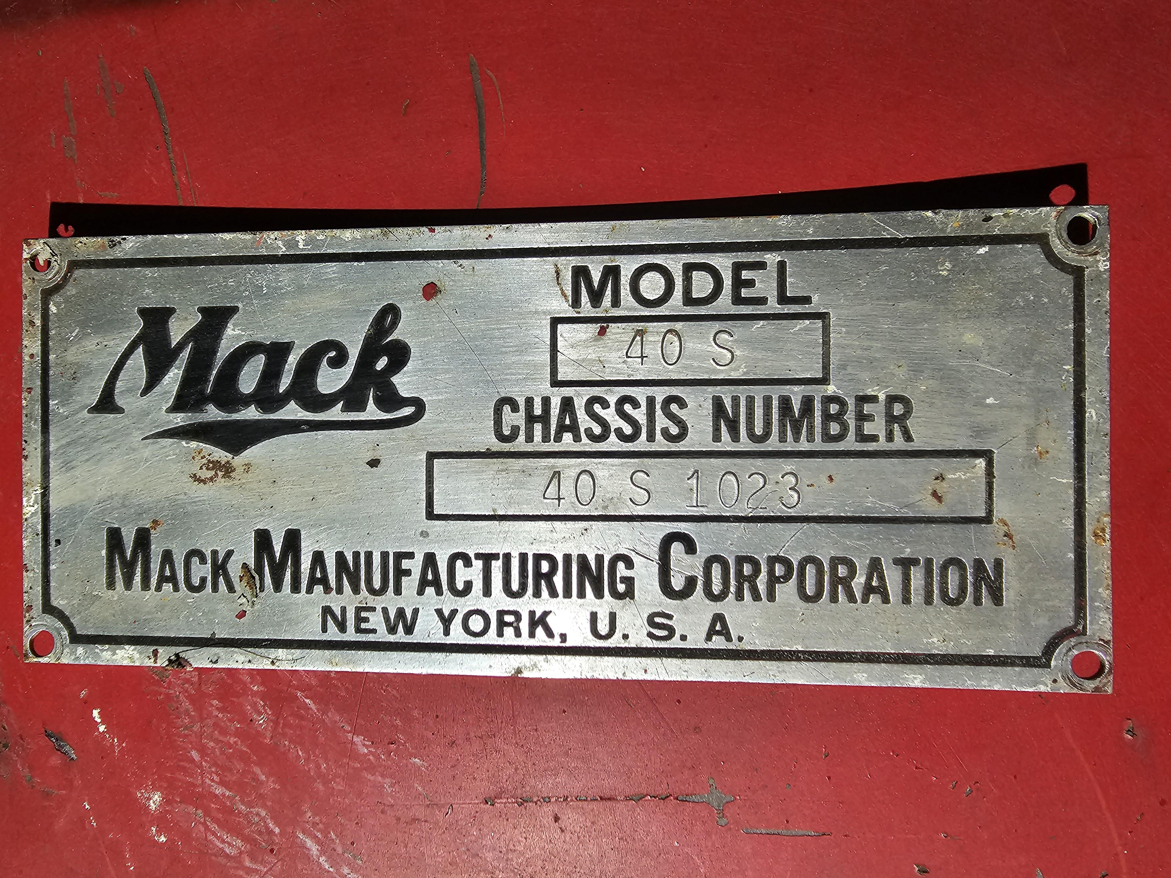

I'm hoping to find some info on one of the trucks we are getting ready to restore. Here's some of the info:
W-50614, 1940 Mack, chassis 40S1023, engine #2565, pump #8445, rig was assigned to Chanute AFB, Rantoul, Ill. It was purchased along with another truck for the fire station being built there. Markings show it as a US Air Force Fire Engine. Based on the serial, I assume it is a Type 40? I'm hoping to get some wiring diagrams or parts listing since many of the original components are missing. I usually deal with American LaFrance engines, so sorry for the ignorance on these. I'm learnin' though!
  • 3 weeks later...
Neat truck.  It is a type 40.  My father has a 1941 type 45.  I do not know the difference.  They are based on the small E model not A model. If you have not heard , you can get some of the information you need form the Mack museum.  They work on donations.  They are pretty backed up with requests.
