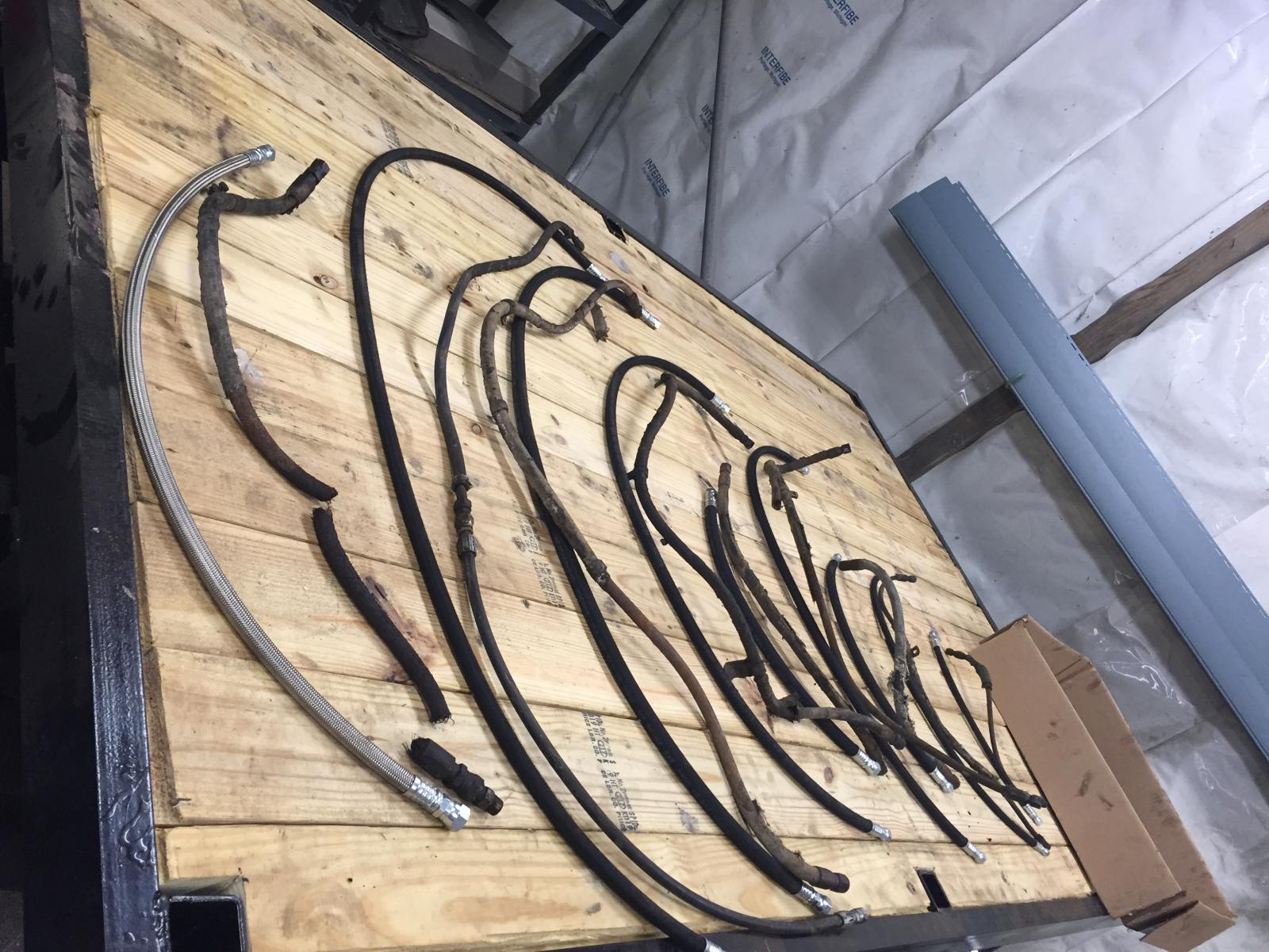

I want to put a new set of fuel lines on it. Is that something available, reasonable? Mine are just rusty looking and figure I might as well replace them now since they are off. Going to check on getting pump redone also. I know there are local places.

I just dropped off all the old rusty fuel lines and had the new ones made to match. I had a local industrial hose supplier make them from top of the line materials, way over kill but I would rather not worry about a hose failure.
I couldn't find any type of kit for them.

My injector lines are all steel and would like to keep them steel(not braided). Mine are useable, but would like to have new.
