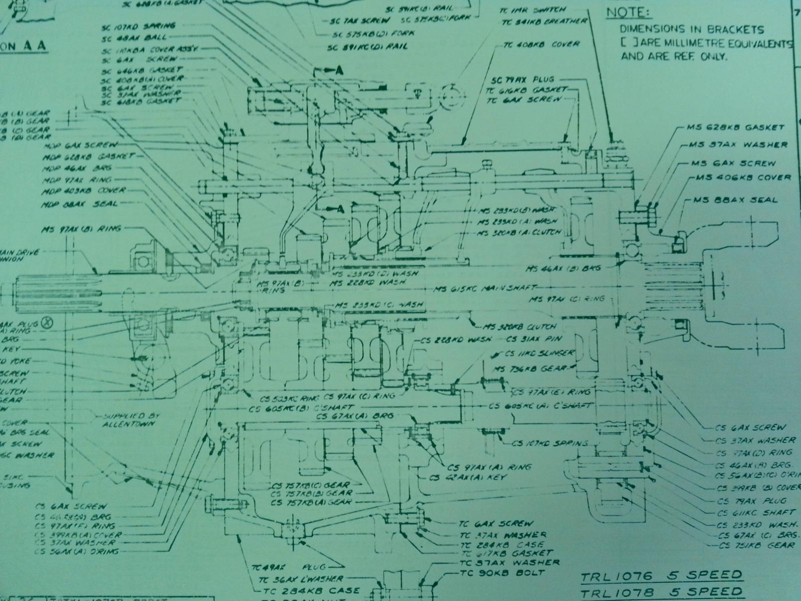

The attachment shows PTO gear for a 5-speed transmission. In the picture below it will be the countershaft gear meshing with 2nd gear in the front box.

Looks like you have a old TRL1076 or TRL1078 - 5 Speed transmission. Unfortunately, this 1st generation triple countershaft Mack transmission 5 speed (prior to T107 the T772 was a single countershaft design) had only provision for installing the PTO gear.
