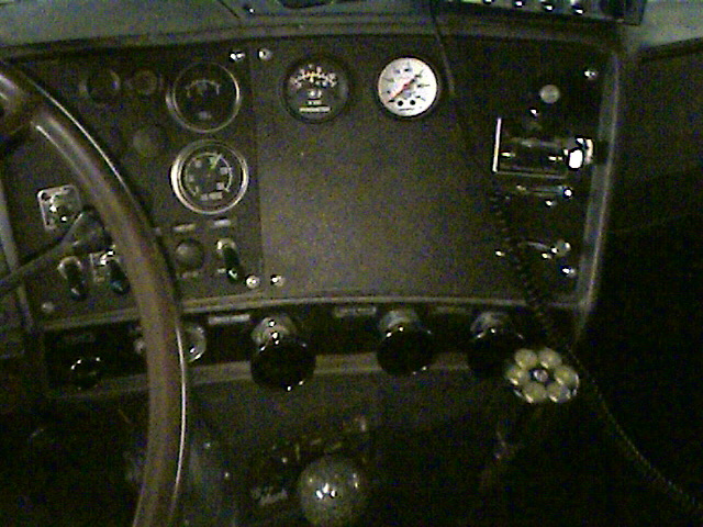

Looking for a dash mountable PTO shifter. Any one have one?
You looking for one that just does on/off? Or do you need dump (or any other) controls along with the switch? Seems any on/off air switch should work for an air-operated PTO...and any electric switch (of proper amp rating) would work for an electric PTO.
The controller for the PTO I run my blower with came as part of the installation kit with the PTO, so I'm not too sure where I'd go to get another one. The controller for the second PTO that I run a hydraulic pump for a dump with I bought at Cape Tractor Trailer Supply in Cape Girardeau, MO....I think it was $150 if I remember right, but mounts under the dash....has the on/off switch as well as the raise/hold/lower for the dump. Any local tractor/trailer supply location SHOULD be able to get you something similar. I didn't like the tower that the previous truck owner had in this truck...took up too much space in the cab. When I started pulling it out, I noticed that all of the switches were just generic switches like you could find at Wal-Mart (the electric ones, anyway...the air switches LOOKED the same, except had air connections on the back instead of electrical ones).
What I've got now:
What came out:
I suppose those switches in the old tower COULD be installed on a bracket in any other location in the truck...or even just put in a hole drilled directly into the dash. It'd do the job, but it might not look too purty...I guess that would depend on how much fabrication work a person would be willing to do :blink:

RowdyRebel: You said that you bought the shifter that is shown on the left side of the first picture at the Cape Trailer store?
Left side shifter came with the PTO....it's a Muncie, so any Muncie supplier ought to be able to get it...just a simple on/off with a light. The right side PTO switch is the one I bought at Cape Tractor Trailer Supply to run the hydraulics for a dump.
