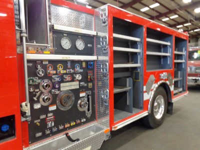

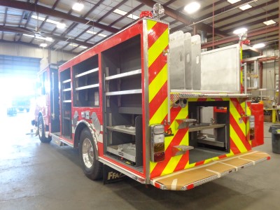

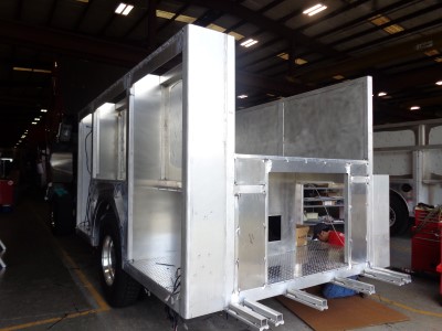

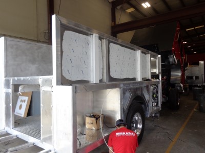

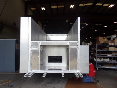

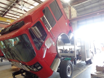

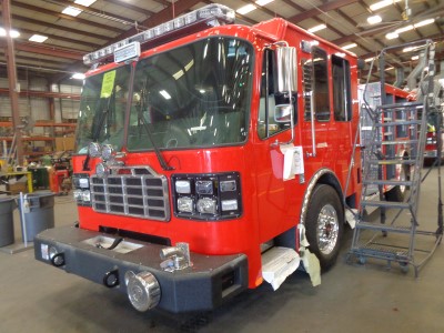

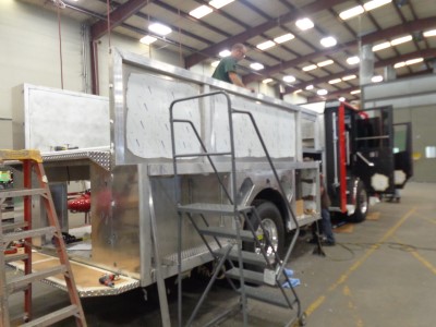

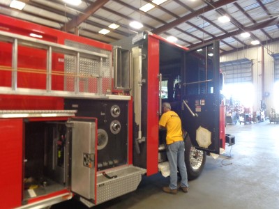

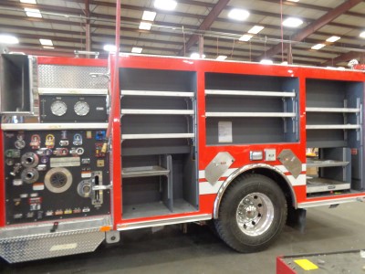

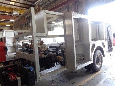

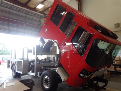

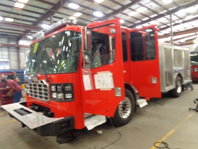

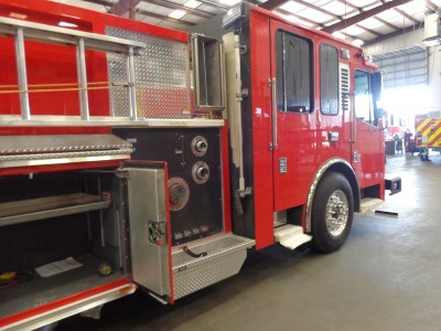

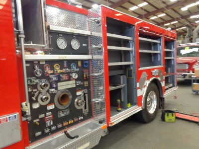

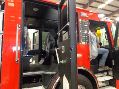

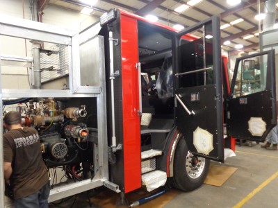

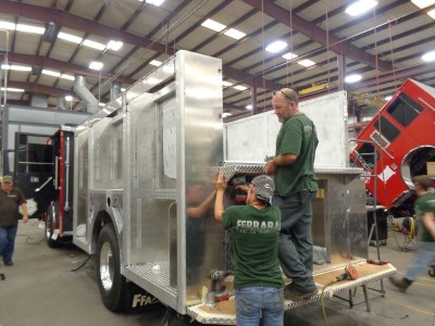

Update 7/6/15 Work continues. Interior of the cab being fit-out. Pump controls and accessories being installed. Body wiring harnesses being installed. Should be moving into the paint shop by next week to paint the body, All photos courtesy of Ferrara Fire Apparatus, Inc.
Coming along very nice. Did they Rhino line the interior too? Paul
I believe the floor may be rhino liner. The walls and ceiling are diamondplate, stainless sheet or high impact plastic. The seats are all an extremely high strength ballistic nylon. No more vinyl. We learned that lesson with our 1989 pumper (that this truck is replacing.)

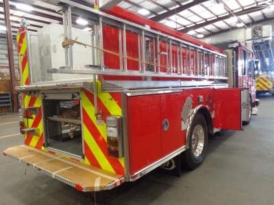

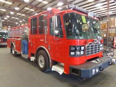

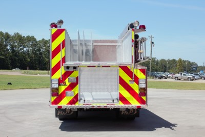

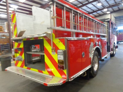

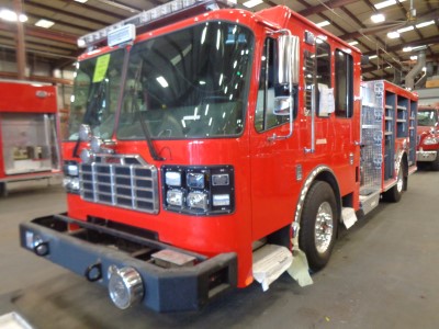

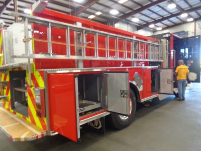

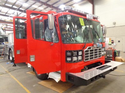

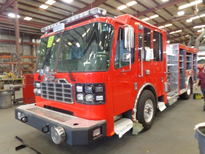

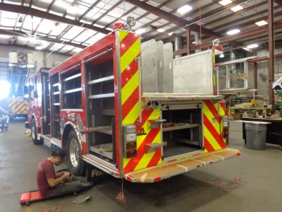

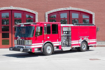

UPDATE 7/15/2015: Out of the paint shop!!!! Striping and decals being applied (gold leaf applied after delivery.) Interior fit-out of compartment shelves and brackets in progress. Final inspection tentatively scheduled for 7/22. Note the rhino-liner'd front bumper. HatCity note your chevrons on the rear.
Looks excellent! I do miss the "shiny" pump panel though. I'm from the era of Chrome, Brass and polished aluminum.

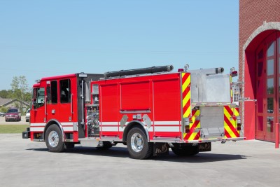

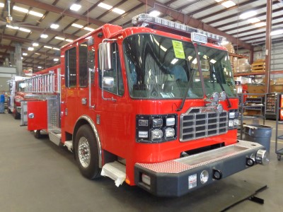

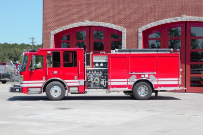

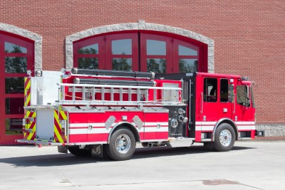

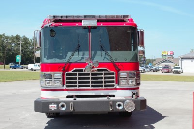

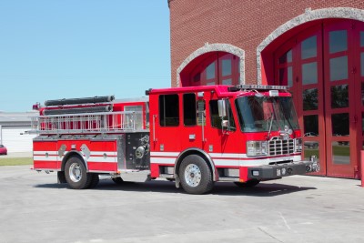

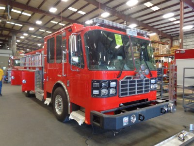

UPDATE: Final everything is in the end stages. Our crew flies down Tuesday to do the final acceptance inspection on Weds. Due to work and family obligations I will not be able to go- this is the first new truck I have been involved with in a long time that I have not been one of the final inspectors of. Note the Cow Piss tank. Even though emergency vehicles received an exemption from pollution laws, the engine builders all refuse to accommodate- costs them more money to re-tool the production line for a fraction of the industry so unfortunately- we're stuck with cow piss. All photos courtesy of Ferrara Fire Apparatus.

FWD: Why the big front bumper??? Big winch enclosed???
Bumper will have a car fire/trash/dumpster fire line on it (100 feet of inch and three quarter) Will have a 2.5" line plumbed all the way to the front bumper, with a gated wye on the end at the bumper- we could run two inch and three quarters or a single 2.5" line if we wanted to. I don't ever remember running a deuce and a half on the one we have now, but we figure, "we're paying for the plumbed line, go big or go home."

I'm confused...Bumper will have a car fire/trash/dumpster fire line on it (100 feet of inch and three quarter)..where is the hose stored? Speaking of car fires, I have suggested a 19,000 lb GVW F-550 might be a good addition to our local department given number of car fires/MV accidents they respond to..(We are on an interstate exit) Was told by locals.."nah-not enough to handle a car fire" Having learned in my career what you can do with a 20 lb. Ansul (B-C) and for sure understanding a B-C is not going to put out a tire fire, what do you guys think about the smaller, quicker less costly mini pumpers???
1. Hose will be accordian loaded onto the top of the bumper and held in place with straps.
2. In my opinion having used both full-size and mini-pumpers- they are a complete and total waste of time and money. The chassis are usually under-rated for the amount of hose and equipment that you usually wind up throwing onto a mini. I would rather spend my money on the full size pumper that is guaranteed to have the horsepower and torque to turn the pump, have all of the ladders, hose and equipment that I will need not only for that pesky car fire, but also the house or commercial building fires. And when operating on a limited-access/high speed highway, given the number of hits of emergency vehicles that occur, I want the luxury of a full-size pumper protecting me when I am operating in front of it.
https://www.flickr.com/photos/triborough/7868646304/

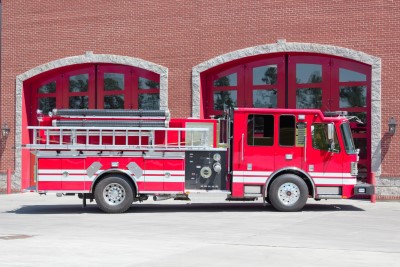

Link to our 2007 Spartan/Toyne which has the front bumper line as well. Hose is stored in a "trough" recessed into the bumper and secured with two seat belt-like straps. You can see the discharge on the right with the gated wye.

We used the front bumper trash lines and I would not be without one. It is so much safer to pull that line on a highway than a cross lay. Plus it is easier to re-rack so it tends to get used more in lieu of a booster line for car and dumpster fires. We used doughnut rolls with 100' hooked up and a spare 50' kept with it.
I agree mini-pumpers are not worth buying. The real expense of operating a FD is labor, even in a volunteer department, so if you are going to staff a response vehicle why not have a rig you can do everything with. As the saying goes "I'll buy mini-pumpers when they start making mini fires."

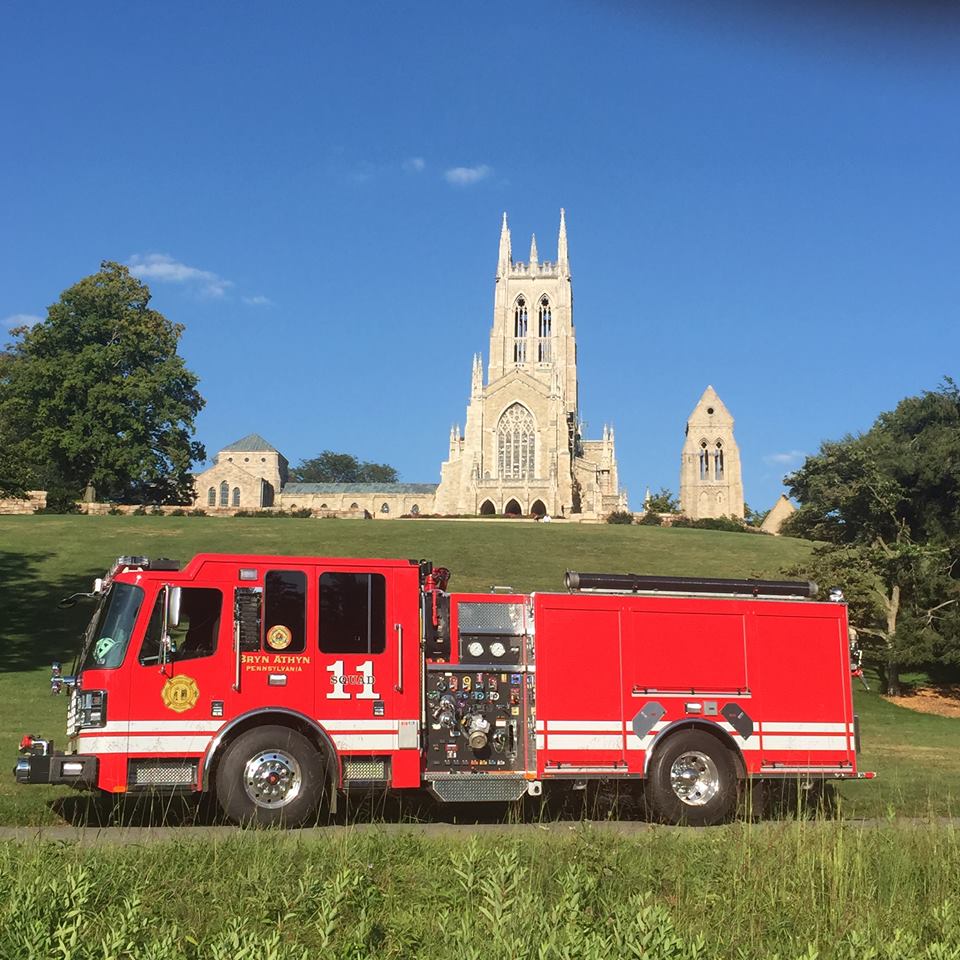

I think its pretty ironic that any one of us would kill to have this kind of documentation for our antique rigs when fifty years from now no collector will give a rat's ass about this rig or any other one that has a "20" in front of its model year.

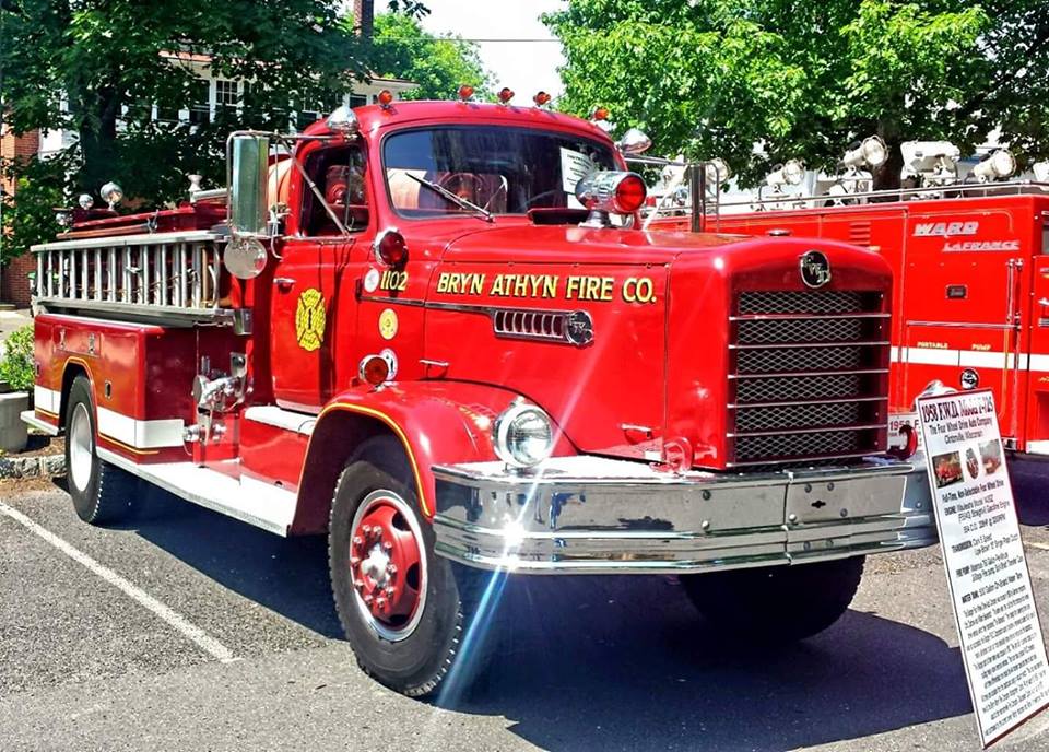

On the 1958 FWD, I have the two maltese crosses, plus the "Bryn Athyn Fire Company" on the hoods and the two unit numbers "1102" on each side. These are all the same as I described above however by a different manufacturer and done 10+ years ago. There was also a small composition charge to create the specific maltese crosses. If I remember correctly I have about $700.00 tied up in everything on the truck. And they still look as good as the day they were applied (by my father.)
