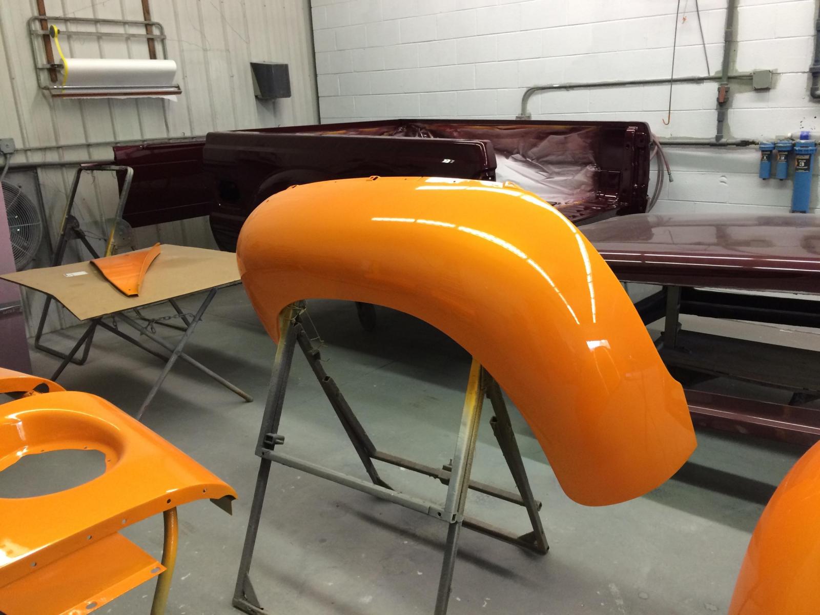

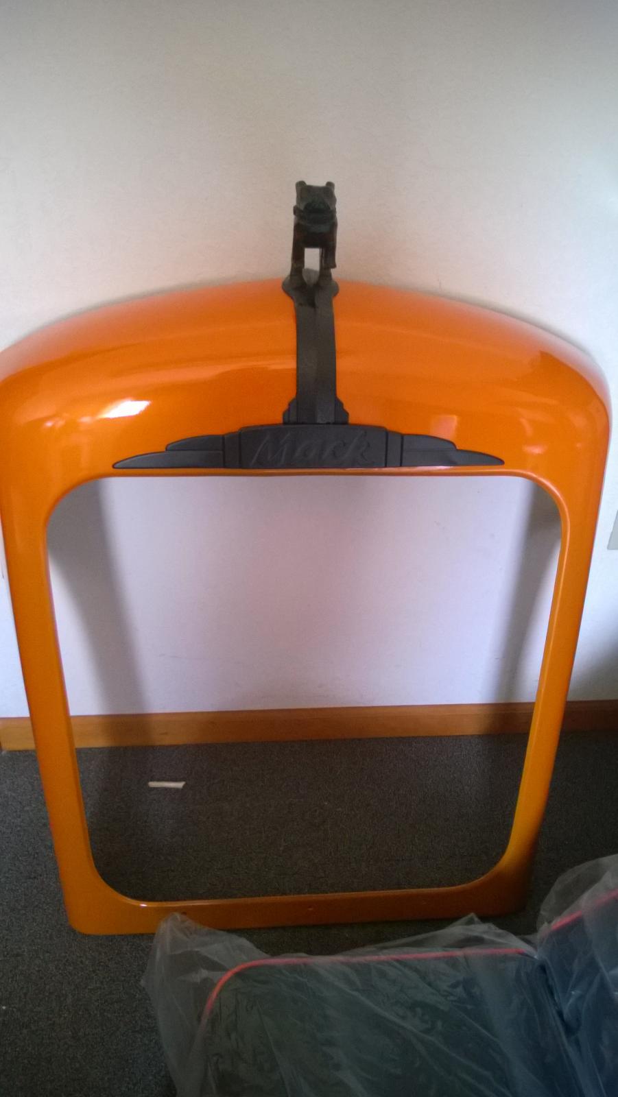

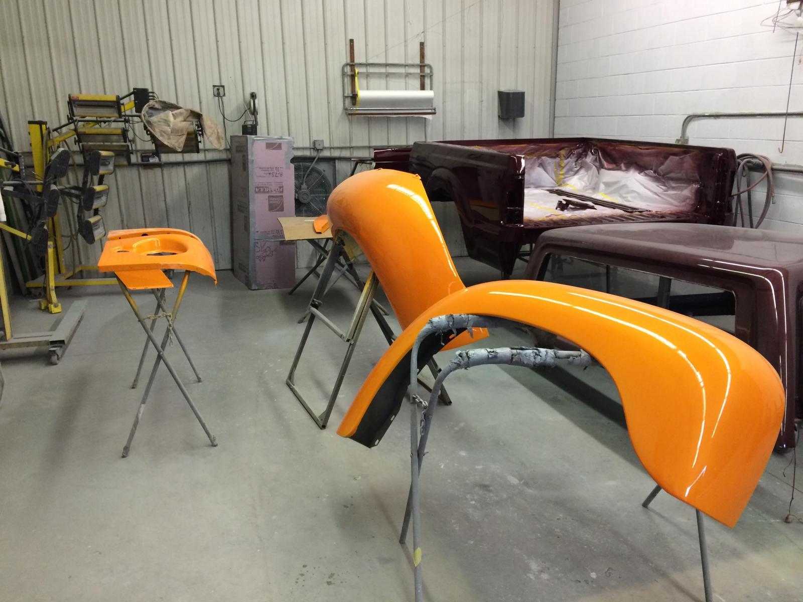

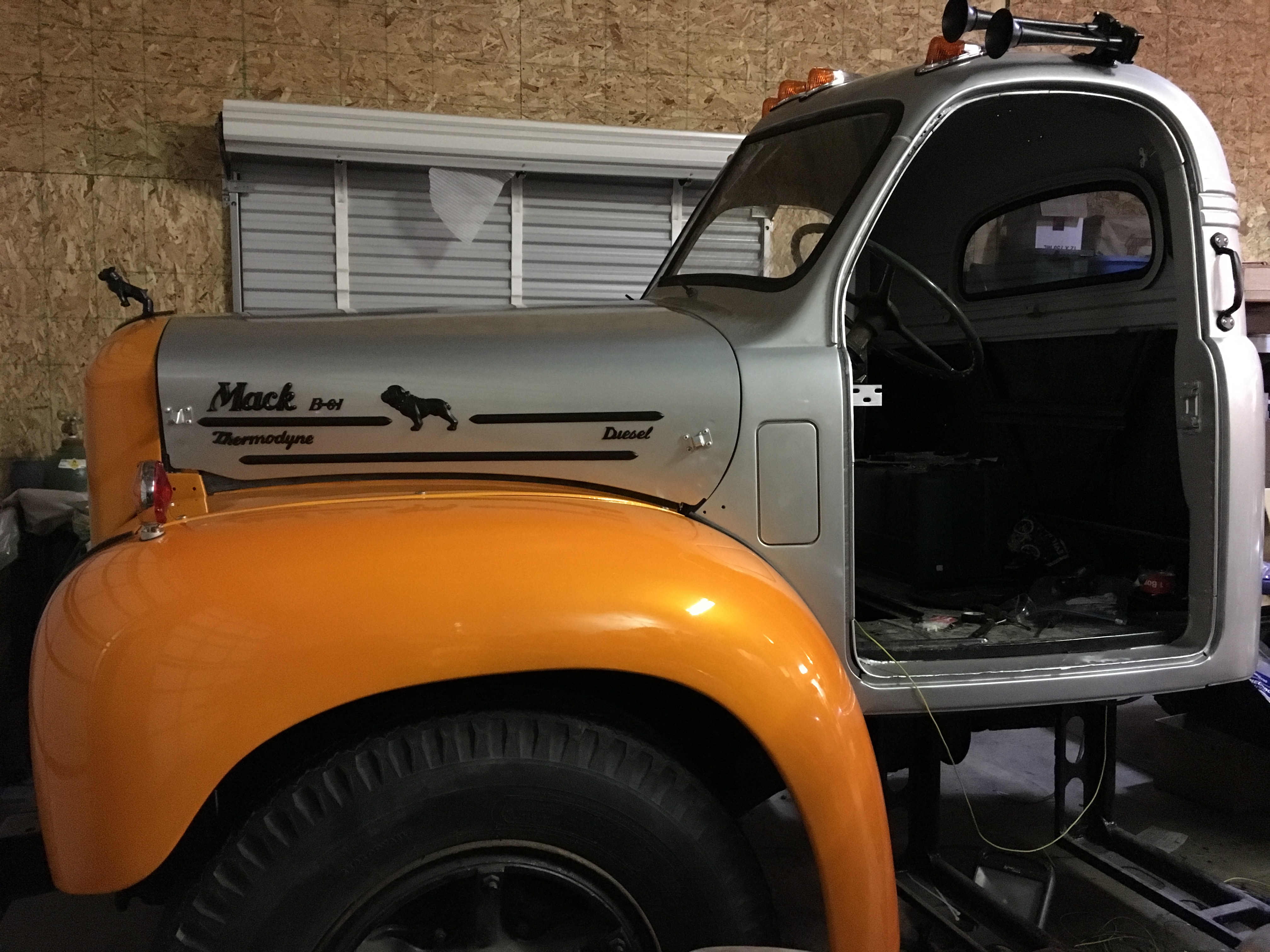

Paint job looks great-There are 2 versions of the B Model front end- one allows the grill to be removed separately- the early model does not. Here is the Install process for the early B Models-
1. Install L&R fenders with inner fenders to cab, (leave bolts loose for adjustment)
2. assemble the grill and headlight panels as an assembly
3. Using fender welting between headlight panels and fenders install bolts between headlight panels and fenders (both sides) , install bolts to rad support and then adjust as necessary and pull them up tight.
4. Note all bolts use fender washer,lock washer and bolt to protect paint from being scratched.
