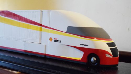

The new “StarShip” vehicle (seen at right), however, is being built on a 2016 Navistar International ProStar chassis, which will include a 2010-compliant engine equipped with selective catalytic reduction (SCR) emission control technology.
“We’re building our own cab for this concept and will be 100% EPA certified to operate on the road,” Silwa said. He’ll be loading the StarShip tractor-trailer combination with ballast up to 65,000 lbs. gross vehicle weight; a GVW he said 70% of today’s freight-hauling trucks opera Initial He added that initial designs call for the StarShip tractor and trailer to join together into a single integrated unit.
“This will solve the problem of having a gap between the tractor and trailer, which is a big source of aerodynamic drag and loss of efficiency,” Silwa stressed.
The StarShip tractor and trailer alike will feature side skirts, hood, front end and custom interior, along with a tractor-to-trailer “active aerodynamics” gap sealer.
Both the gap sealer and trailer skirts will retract below 35 mph or when coming up on obstructions such as a railroad crossing, etc., Silwa said.
Waterman said noted that while Shell will be providing some engine and lubricant to the StarShip project, Silwa will remain the chief owner, designer and driver of the vehicle.

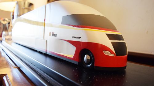

Shell’s futuristic concept tractor-trailer, dubbed the Starship Initiative, is on track to be completed within the coming months and could perform a cross-country efficiency test run as early as the first quarter of 2018, the company announced Sept. 21.
The rig, which is being built by AirFlow Truck Company, aims to combine already-existing technologies to create the most efficient truck in the world, as measured by freight ton efficiency, says Shell and Bob Sliwa, head of AirFlow and the project’s chief designer.
The Starship will lean heavily on lightweighting and aerodynamics. “We’ve obsessed about its aerodynamic shape,” says Shell Rotella’s Bob Mainwaring, the Technology Manager for Shell’s Innovation segment. He pointed to the truck’s front end, the tractor-trailer gap closure systems, aerodynamic skirts that run around the entire truck and trailer, the trailer’s tail and under-the-tractor aero systems, all of which combined “halve the aero drag of the vehicle compared to the standard U.S. truck today,” he says.
Relative to lightweighting, the truck’s cab is made of carbon fiber, “which is ridiculously light,” he says.
Shell’s work and investment in the Starship Initiative is part of the company’s focus on the future of energy use and transportation, Mainwaring says. Initiatives must be taken today to find solutions to meet the global energy demands anticipated for 2050, Mainwaring says.
“We’re using technologies available today to design an energy efficient truck capable of reducing energy usage associated with goods transport in a material way,” he says. “The main aim of the Starship is to attempt to minimize the amount of energy it takes to transport a load of cargo from Point A to Point B.”
There’s no mpg target for the truck’s cross-country test run likely to occur early next year, says Megan Pino, global brand manager for Shell Rotella. “We don’t think acheiving a specific number is necessary to showcase success,” she says. Instead, “we’re challening ourselves to see how good we can be.”

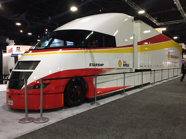

Shell Debuts Fuel-Efficient Starship Concept Truck
Heavy Duty Trucking (HDT)  /  March 6, 2018
Shell and Airflow Truck Company have debuted the full-size version of the company’s Starship Project truck – a concept Class 8 truck that maximizes fuel efficiency using a combination of currently available technologies.
The long-teased Starship Project concept truck was finally unveiled at  The Technology and Maintenance Council Annual Meeting in Atlanta. The project was first announced in 2015 and was designed by Bob Silwa’s AirFlow Truck Company, which produces hyper-efficient commercial trucks.
“We seek projects such as the Starship initiative to keep Shell at the leading edge of technology development and energy efficiency,” said Bob Mainwaring, technology manager for innovation, Shell Lubricants. “The transportation industry is constantly changing, and our goal is to be at the forefront of innovation by collaborating with companies like AirFlow and others to develop creative solutions that provide benefits for years to come.”
The body of the Starship Project tractor is a custom-made aerodynamic design made of carbon fiber. This includes the side skirts, hood, and front end. A custom, Department of Transportation-approved wrap-around windshield was designed specifically for the truck. The trailer includes energy efficient features such as full side skirts to reduce drag and a 5,000-watt solar array on top of the trailer to power interior accessories and reduce the energy load.
The Starship is powered by a 2017 Cummins X15 Efficiency 6-cylinder engine with 400 horsepower and 1,850 ft.-lbs. of torque that has been paired with a transmission that has been calibrated to run at very low speeds, down to 800 rpm.
The truck also makes use of Shell’s low viscosity synthetic lubricants, running on the Shell Rotella T6 Ultra 5W-30, which is an API-FA-4 engine oil that has been formulated to provide better fuel economy, improved high and low temperature performance and meets the requirements for many low emissions engines.
It will also use a number of full synthetic Shell Lubricants products including Spirax S6 GXME 75W-80 transmission oil, Spirax S5 ADE 75W-80 differential oil and Spirax S6 GME 40 wheel hub oil. In addition, Shell Rotella Extended Life Coolant will provide excellent high-temperature protection and heat transfer. Shell Rotella Diesel Exhaust Fluid, a high purity diesel exhaust fluid, will also be in the truck.

From a real world stand point how would you ever do a pre or post trip inspection? Right now I’m fighting ice (sometimes 12” thick in places) sticking to my truck and trailer and it’s a pain. I couldn’t imagine how that truck could function anywhere other than warm climate and flat geography.
